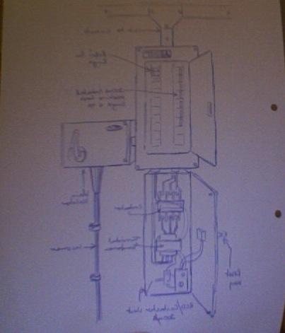

Here is a sketch that i've just done of a typical installation as we do them

My picture came out cra99y on the webcam, in case anyone was wondering the incomer feeds into the bottom cabinet that contains a contactor and torroidal coil, the coil works with the contactor to make a 300mA RCD / 80A overload protector, this then feeds the DB in this case a Mitsubishi QuickTrip with MCBs feeding machines down one side and RCBos at 30mA on the other
The 300mA protection is to comply with DATAs spec for the install and that cabinet is custom built by MEM for the job, I generally have MEM or Hager stuff the whole lot in one custom built box to fit the available wall space, MEM turn the job around quicker although Hager's designer has suggested some fascinating MCB servo devices that switch the MCB off and on so doing away with the contactor, Both firms will send an engineer to your office to work on a design with you.
BTW the Mitsubishi board was customers spec, it takes 21 weeks from order to delivery as it has to be specially shipped from Japan, its an Ottermill design, Mitsubishi brought all the designs for the BTQL range when Ottermill-Chilton-Simplex called it a day, very good stuff when it arrives!!

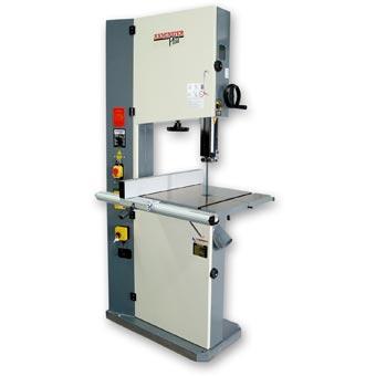

Better if they can buy breaked machines with all the requisite stops etc, Axminster Power Tools Educational do a good range a very good prices, table saw c£1000, very large bandsaw c£1500, good pillar drills c£800 all fully specced for BS4163 ready to instal.

I do it like this
Main switch (MEM excel lever type)
Contactor
DB (RCBos)
Local isolators per machine
commando socket plug
Machine
Why RCBO's on the machines? The machines are likely TP too - so RCBO's would not be an option anyway.
We only fit RCBos on the single phase ring unless there is a request for other single phase circuits to have RCBo protection, the three phase outputs are simple MCB unless a specific request is made for RCD protection of the machine circuits over and above the 300mA RCD that is a built in part of the contactor cabinets we use.
The pics are of the bandsaw and tablesaw we generally specify, both are pre specced for education.
