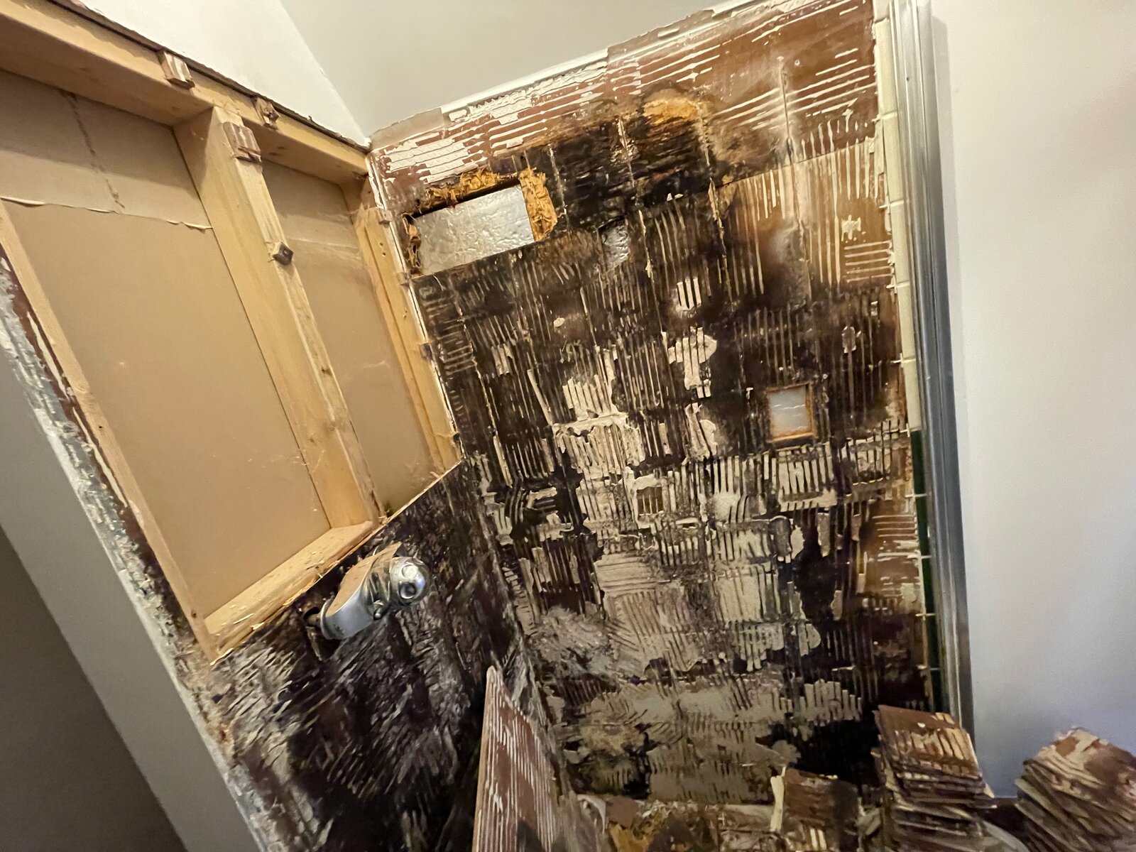

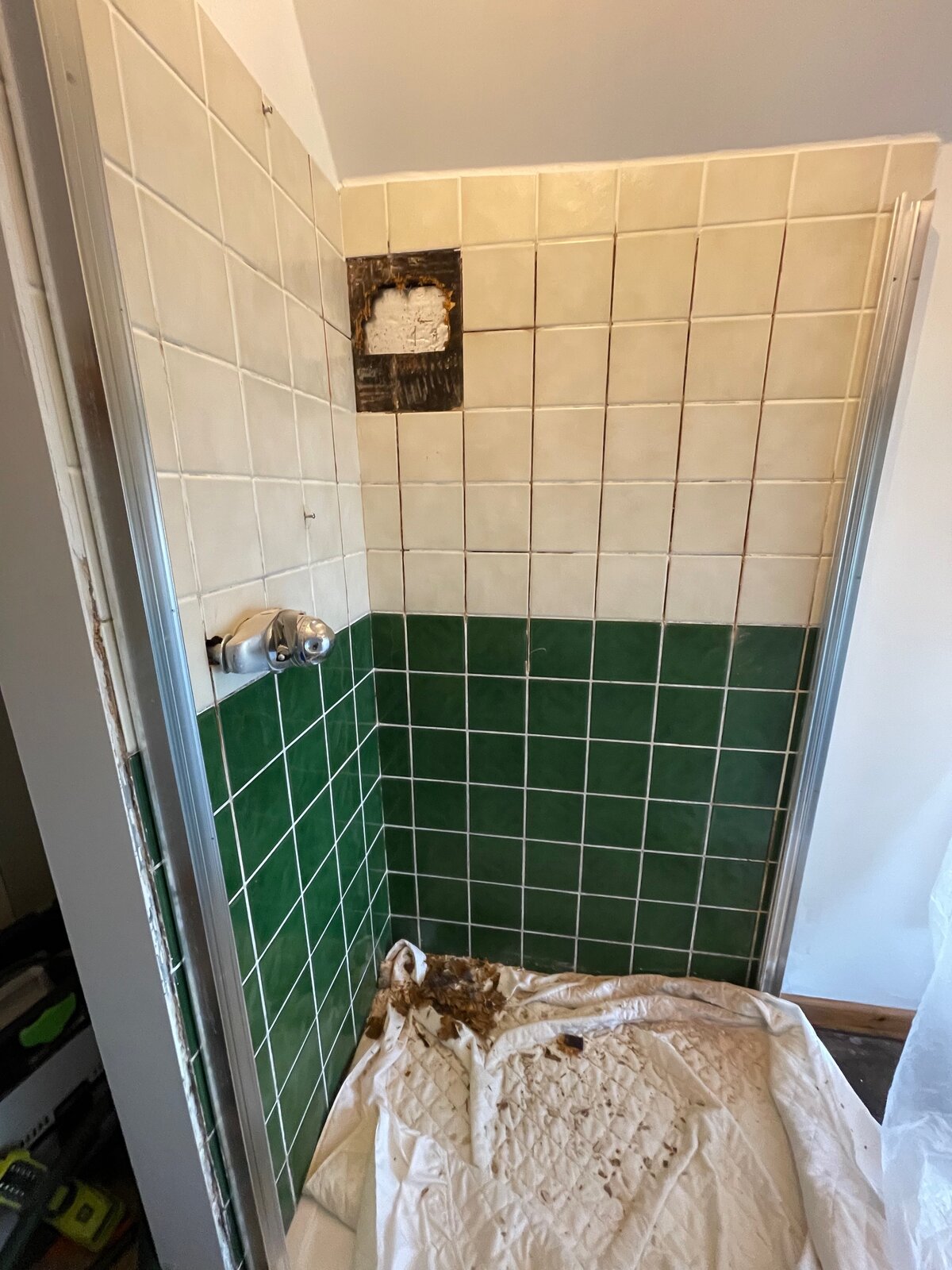

I started the easy job of removing old, cracked grout in our shower yesterday so that I could re grout. Unfortunately it turns out that there has been water getting behind those tiles for quite some time and some of the tiles came off revealing that the board underneath is completely shot.
Live action shot of my day being ruined
I have now pulled off all the tiles, only breaking 2, and started the process of removing the old board (appears to be hardwood plywood in some places, OSB(!) in another so that it can start drying and I can see if the structure of the wall is damaged. This is a massive chore because the screw heads are rusted, full of tile adhesive or both so I've had to gut the board away from the fixings in a lot of places.
Since all the tiles came off in tact I'm thinking about reusing them (potentially adding a band of another colour of tile to free up some to replace the damaged ones). My questions are:
1) Is this a terrible idea, and if so, why?
2) Obviously I need to get the old grout and adhesive off the tiles to reuse them, but how clean do they need to be? Getting off the stuff that stands proud of the tile is pretty easy (I think it's been getting damp for a while) but getting the stuff that's inside the recesses on the back of the tile off is very slow.
Thanks for any advice.
Glory shot of the disaster. The random holes are to provide a little ventilation until I get to removing the entire board.
