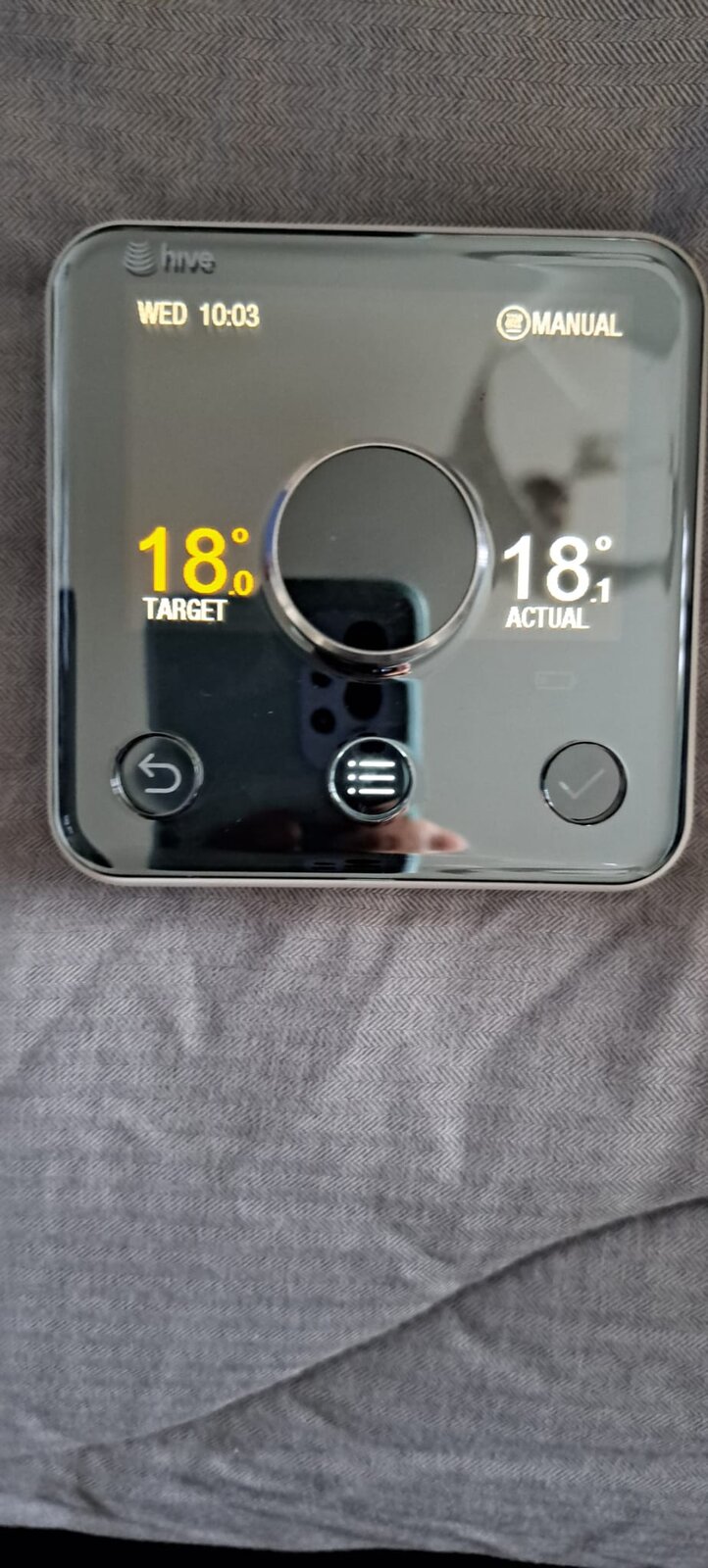

Hi All, Hoping someone could help with this problem.
Once I set the date and time on the Hive 2 thermostat, the display stays on that day/time (i.e. date/clock does not increment), meaning I can't set timers for central heating. For example, if I set the date/clock to 17/Oct/2023 09:20 in the settings on the 'stat, it remains this way until manually reset.
I have removed the batteries to reset the 'stat, as well as replacing with new batteries. I've also done a factory reset of the 'stat, re-syncing it up with the receiver, but to no avail.
This is a standalone setup (i.e. no Hive hub involved), and the receiver only has the central heating option.
Any ideas as how this could be fixed?
Thanks in advance!

Can you post a pic of the thermostat please and I will have a look for you, it sounds like there was a Hub and the previous owners have removed it by mistake try setting your Hive into standalone mode so it isnt looking for the hub , here is a video of how you do it , although if you have broadband you would be better getting a hub, plenty on ebay and they are not expensive, then you will have full control from your mobile phone

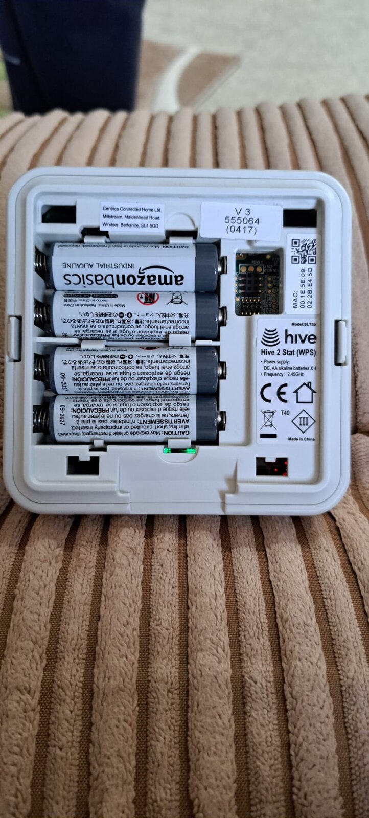

Hi Chris,
Please find attached front and rear views of thermostat. Hopefully this will help.
As you can see, I last set the date and time this morning at 10:03, and now, at nearly 4pm, it still shows the same time.

Hi Ian,
Yes, I had followed that exact process previously, to no avail.
It has been OK since we moved in last year, and the previous owner didn't have a hub either. This problem has just occurred recently, in the last week or so.

Then I think your only option is a new setup, have you tried removing the batteries for about an hour ? the unit has a capacitor which needs to be discharged to get a complete reset, worth a try , if that doesnt work new set up Im afraid
Well, took all of the batteries out for about 4 hours, just to be sure, but no change to the date/time display after reinserting them, and the 'stat had booted up.
