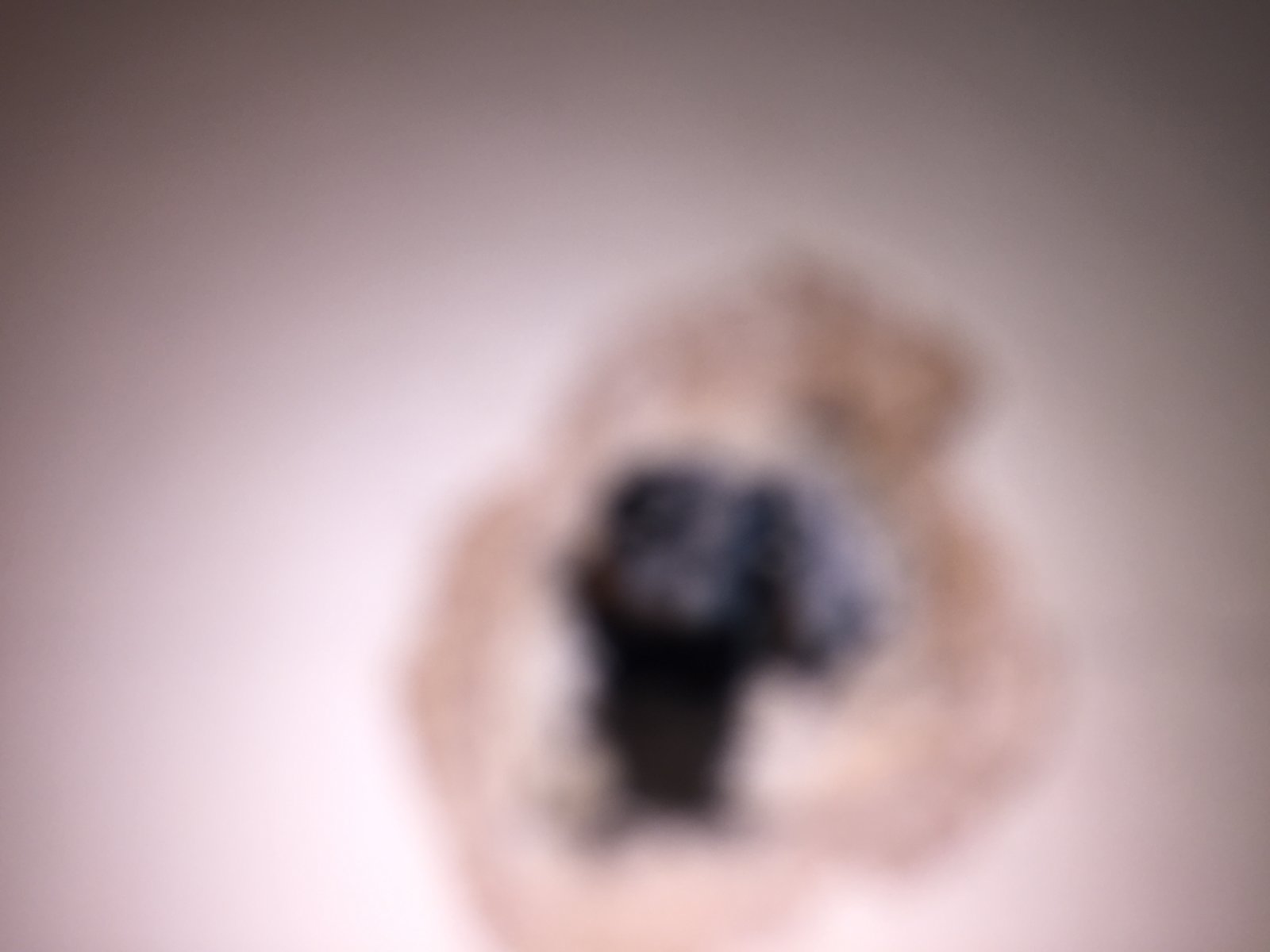

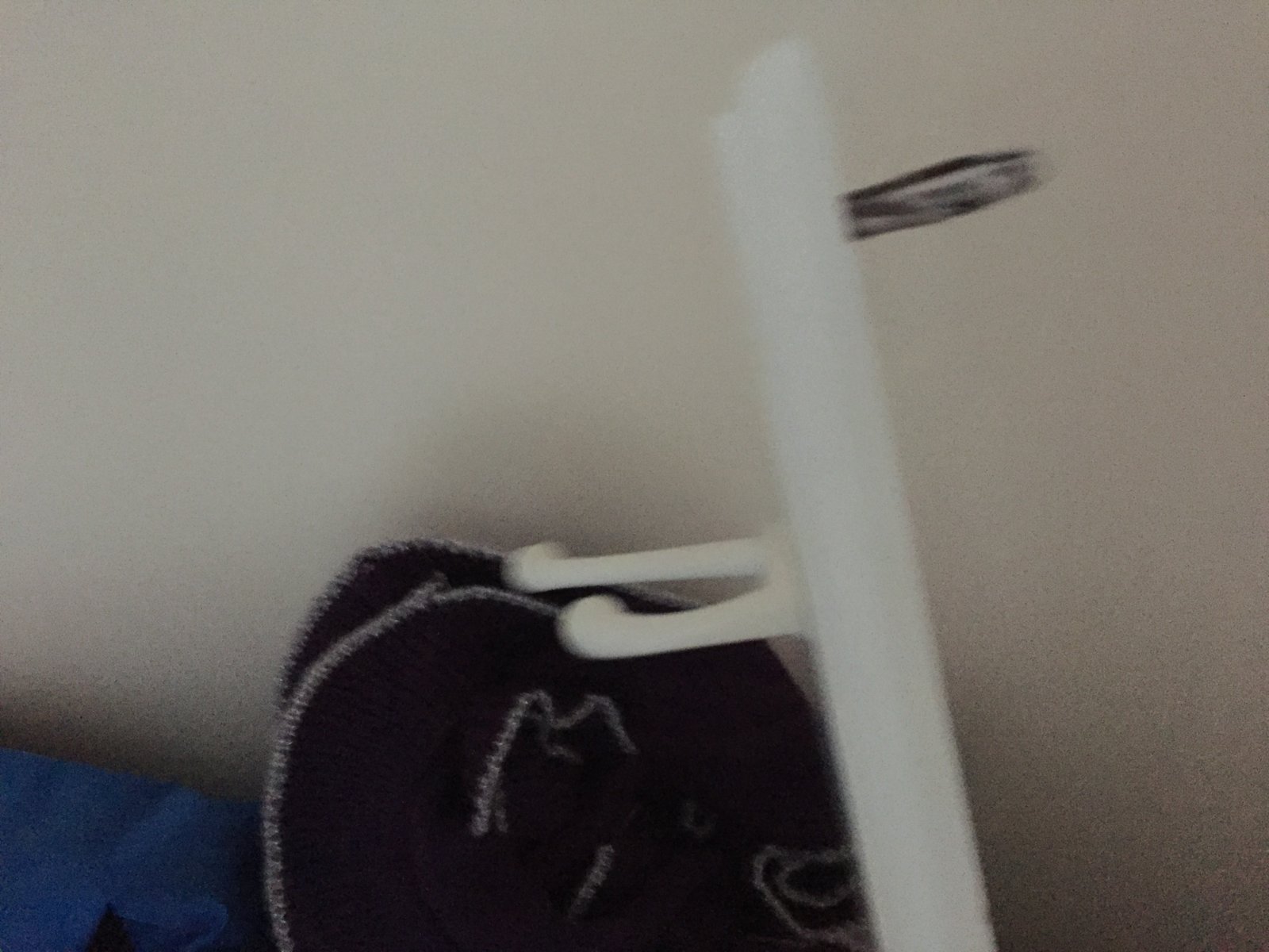

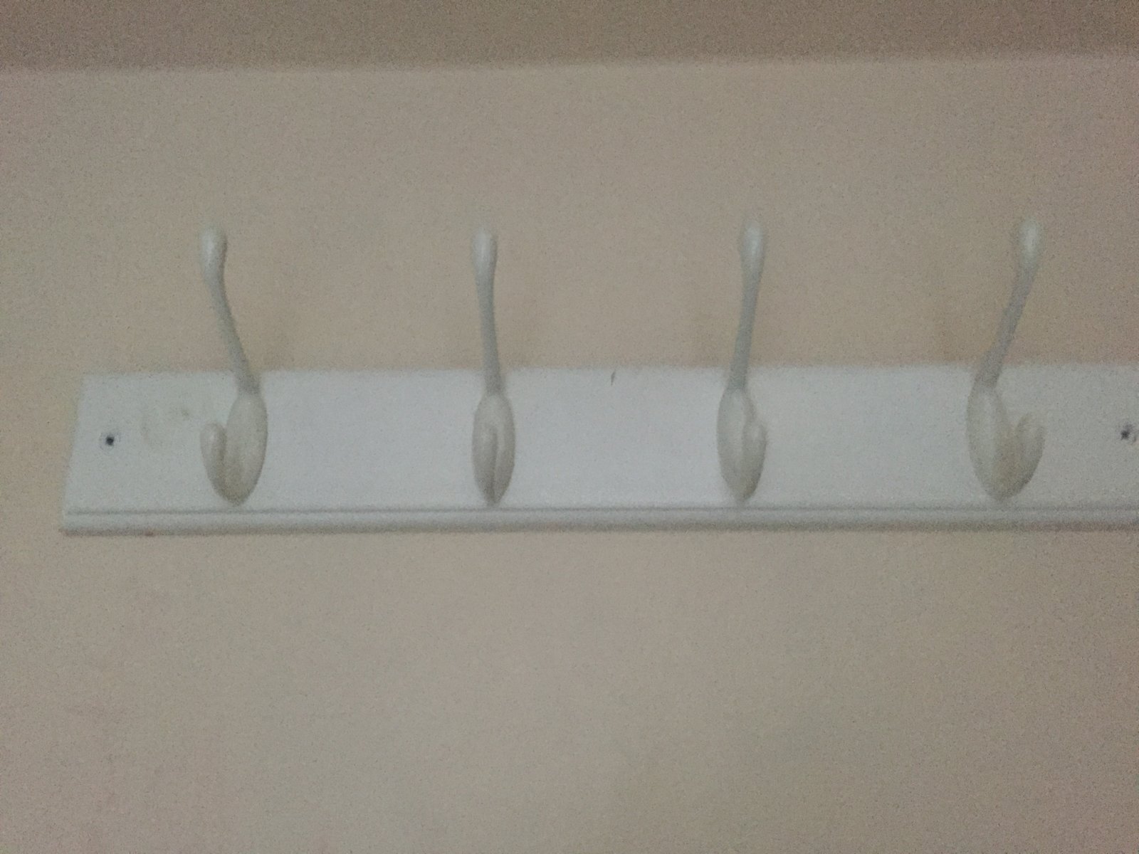

Please see photos above. This batten with coat hookshas stood ok for a few years. Unfortunately, over time and weight of coats has pulled off wall.
Would you use existing holes with longer screws, different wall plugs etc?
(Wall is masonry-porch wall)
Many thanks

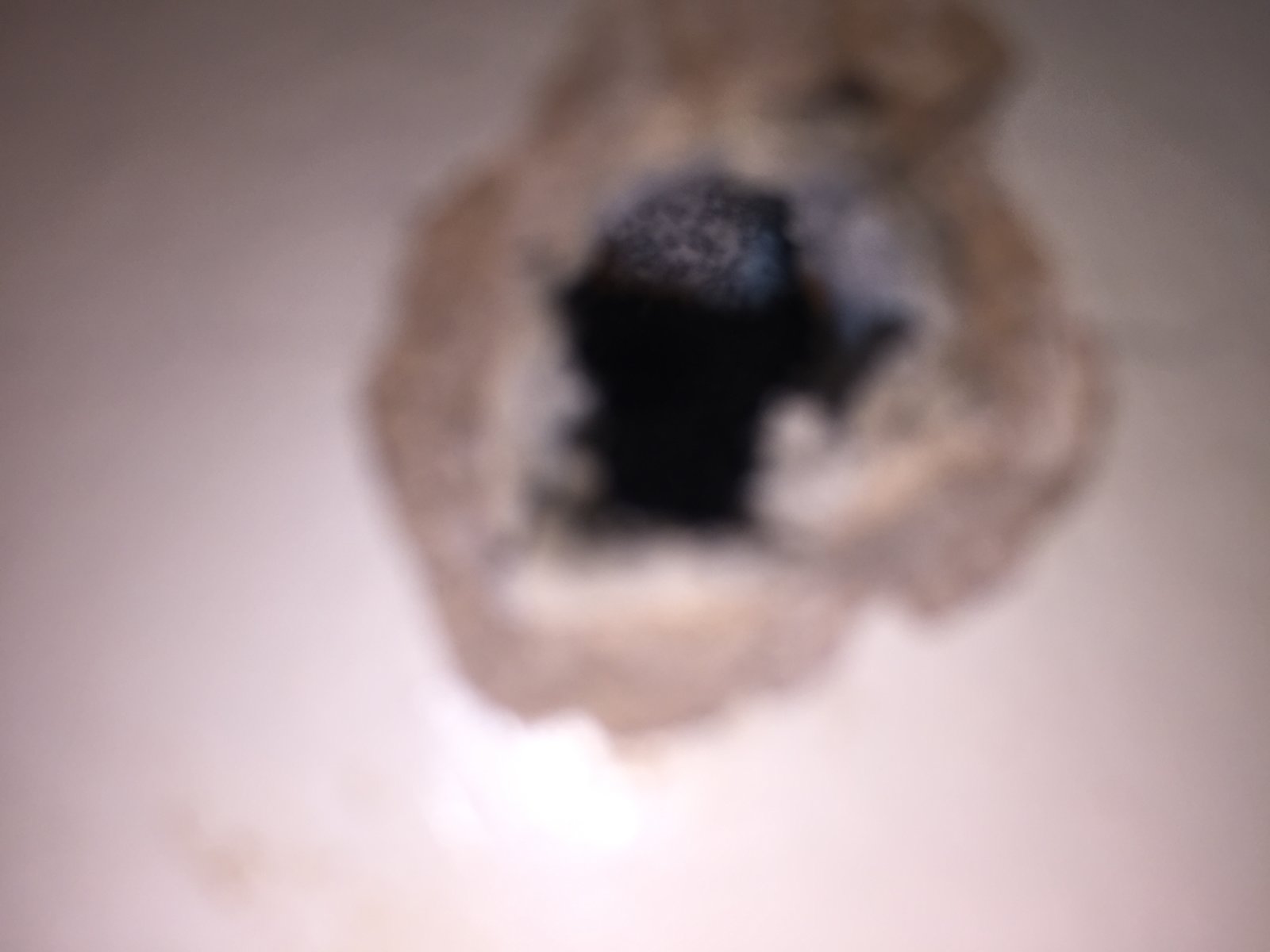

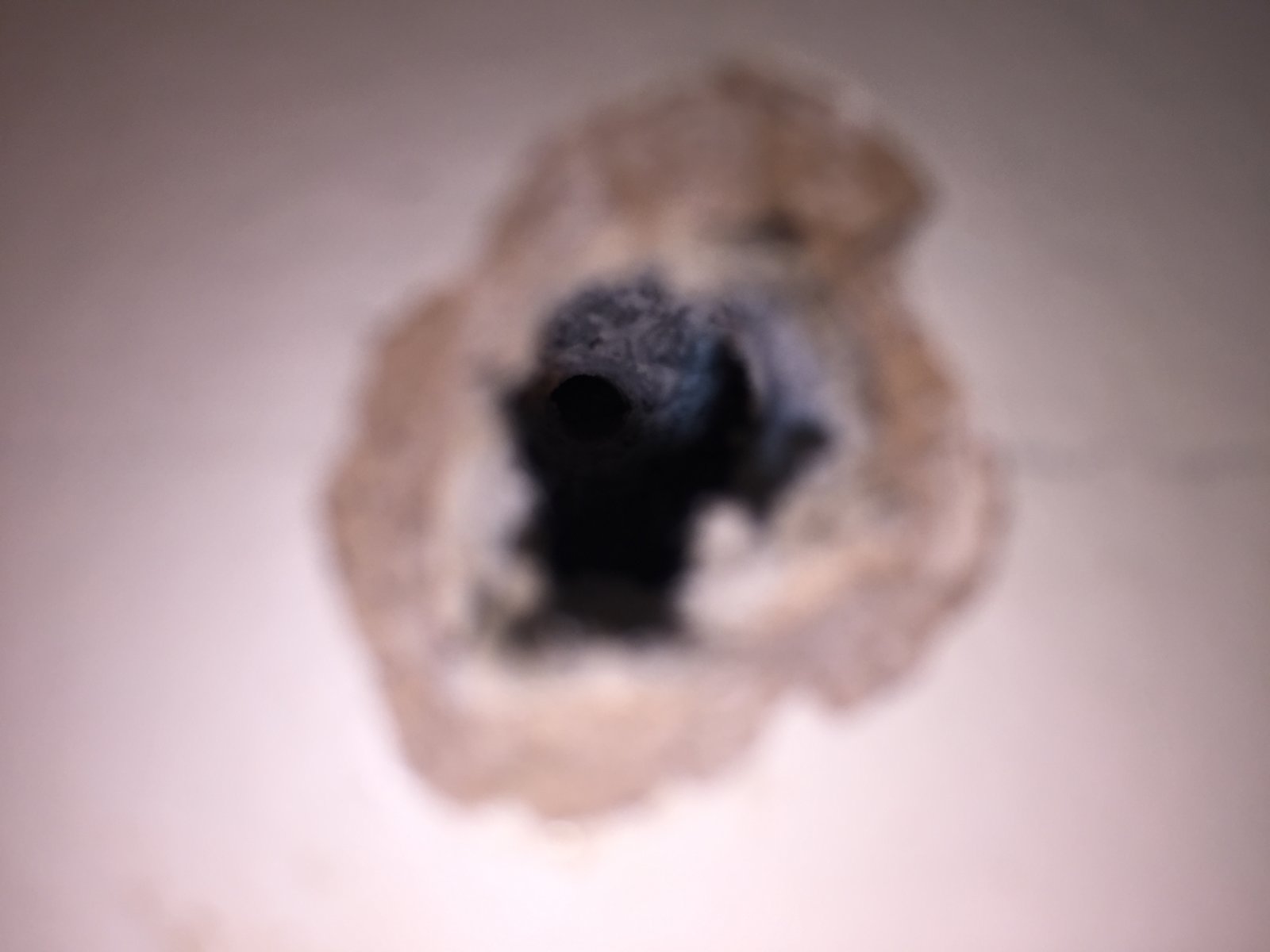

E43AC685-768D-41FF-9090-F0892352C22E.jpeg 97E4B260-3C99-4F59-B963-8D287561F3C4.jpeg 66588351-D1C9-4AD9-944D-8ABDB9705191.jpeg Hi
Correction. Plasterboard, gap then brick. Not sure if clear from piccies, but hole in pasteboard continues a bit into brick.
If you're not worried about looks, consider these. You drill into the bricks with a drill that the same size as the screw shank, and then run them straight in without any wall plugs.
And you've got to check you're photos before you post them.
