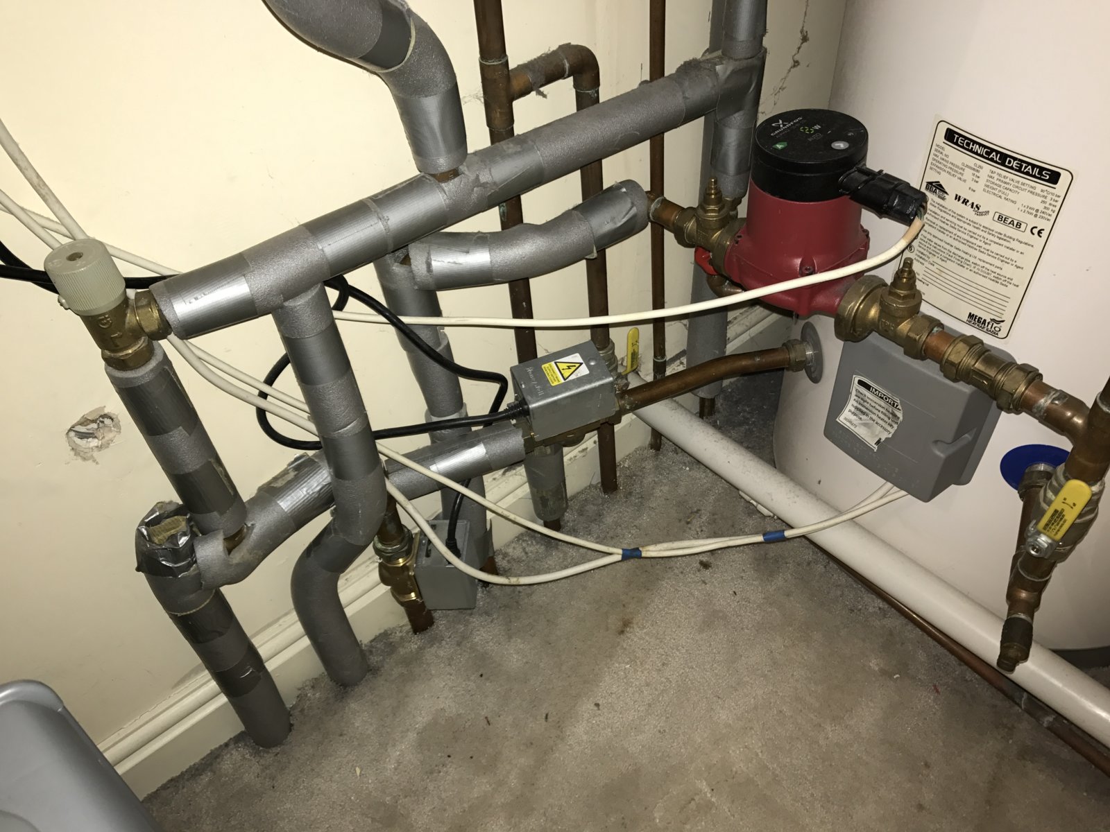

Hi all
We moved into a new house last summer and when it came to winter we realised that the Kitchen rad had problems. Its the largest radiator in our system (1.8 mtr vertical double) and takes at least 1.5 hours to get warm, and then its only warm with spots/areas which are colder/warmer etc.
I have tried everything i can think of but nothing has made any difference. I have bled the whole system for air, removed the radiator and flushed for sludge (none - water was very clean) and also removed both the TRV and needle valve, cleaned reassembled, and also tried balancing the whole system - in fact i have also isolated every other radiator in the system and switched the heating on - this did make a slight improvement to the kitchen rad but it still takes over 1.5 hours to get warm and still has cold spots, but never gets really hot.
I have (i think) an S plan system as i have two Honeywell motorised valves in the upstairs airing cupboard. I have checked the heating valve and this looks - as far as i can tell to be ok.
The only thing that i can think of is that there is not enough flow to the kitchen radiator? - although the boiler is also located in the kitchen the cupboard with the hotwater tank and the S- plan valve and plumbing is located upstairs on the far side of the house - so i am assuming that the kitchen rad is actually the last one on the system as its the furthest from the diverter valve?
Also the Grunfoss pump located in the upstairs airing cupboard does not seem to be plumbed into the central heating line, but rather the hot water line? (but it only comes on when the heating is switched on?) - the only thing that i can think of is that this is used to help get hot water to the downstairs kitchen taps quicker? if this is the case shouldn't my system also have a similar pump located in the airing cupboard but plumed into the central heating line?
I have attached a photo for reference below:
What am i missing? any help is appreciated as we cant go another Winter with the kitchen being so cold again
Many thanks
Martyn

1. Hard to make out which valves are on which circuit, and whether the pump is only on the hot water. However, if other radiators get hot likely to be OK.
2. If its a vertical "designer" radiator, many of then have to be connected the right way round. There's likely to be a baffle plate just behind one of the four connections, designed to force the water round the radiator. This should be connected to the flow, and if its not the radiator won't heat up properly. There's sometimes a label or other marker stuck to the body near this connection.
3. If the pipework from the pump to this radiator is of some length, it may not be allowing sufficient hot water through to fully heat the radiator. Check to see if it is all 15mm. If less, then that could be the problem. If 22mm should not be the issue, but if all 15mm would depend on distance.
4. Try and map out the flow from the pump to the various radiators. Its possible that when the extension was built the new radiator was connected outside the flow of the pump.
Whoever installed the pump hasn't bothered to read the installation instructions which show that it must be installed with the shaft horizontal.
Installed as it is - shaft vertical - may have have caused irrepairable damage to the pump, which could be the cause of your problem.

One of the areas which i cannot work out is regarding the pump pictured above - this is not plumbed into the heating circuit, only the hot water. If this is correct then the only central heating pump is the one located in the boiler - what are the circumstances that would mean an additional pump is also required? (like the above but plumbed into the heating circuit). I have tried to annotate the original photo which shows the flows.
A few years ago the previous owners moved the airing cupboard when they combined two of the bedrooms into one larger room -from what i understand this also meant changing to a pressurised tank a certain degree of re piping - is it possible that they may have plumed the pump incorrectly and this should in the central heating to provide more flow?

The pic was confusing me as it didn't make any sense- thanks for the explanation - though it still leaves some questions. A pic showing everything in the cupboard, so we can see what happens to the pipes which go out of view in your current pic, would be helpful.
What is the model no of the pump (Alpha 2 xxxxx)?

thanks all - i have attached a load more pictures and also tried to sketch out the circuit diagram to try and help explain the set up i have - if we can understand what the Danfoss pump is doing or if it is incorrectly installed it would be a great box to tick. The model number is Alpha2 15-60 130
Also any help in explaining to me what the large red thing is and what it is for? - it looks like an expansion vessel of some description? (i guess that has just answered my own question?)

I think your sketch is not quite right around the pump and filter!
The pics are part of the pdf - you should be able to scroll down to see them?
Agile - i have checked again and i am sure my sketch is correct , though there are a few lines coming after the filter that go back to the cylinder and also another connection that disappears through the floor
