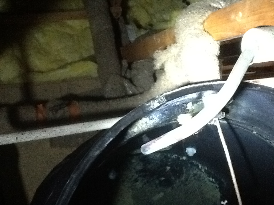

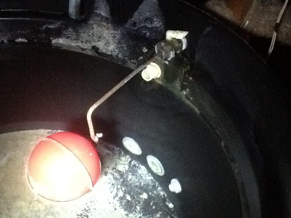

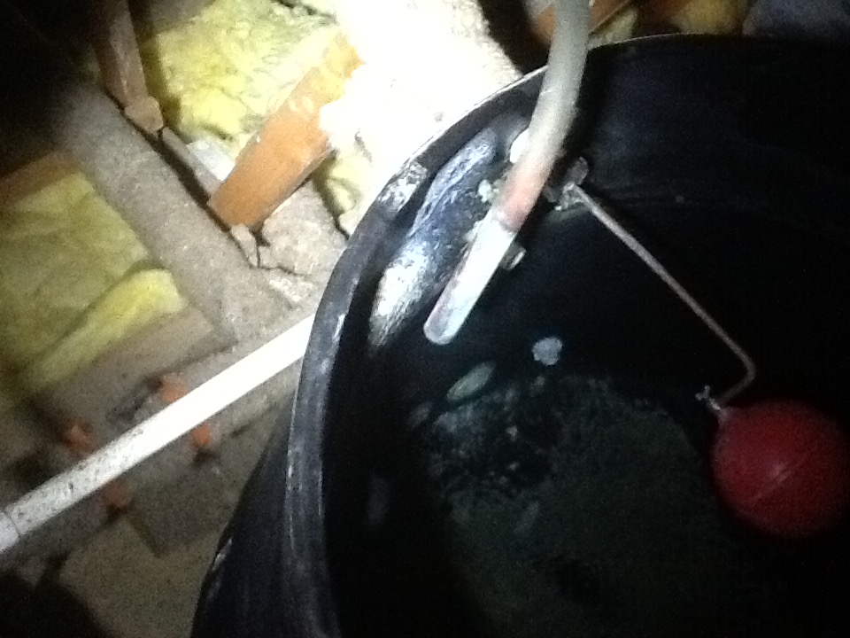

Hi all,
I'm getting a lot of water through the overflow pipe from my cold water loft tank each night. I've gone on youtube and watched the videos and it seems it will be a fault with the valve/ball.
Here's what i'm not sure about...
1. I've just been up in to the loft and found what I assume to be the stopcock which is about 2ft back from the tank on the pipe that feeds in - reasonable assumption?
2. I turned it fully closed and then depressed the arm on the valve which obviously opened the flow - for ages. I stopped before it did, will there be a large quantity of water sat in the pipe that needs to be drained off?
3. If this is the case should I drain some water out of the tank by running the cold water taps?
4. If i do manage to get the arm off and can't find a perished washer or ball full of water can I leave it off to take it up to b&q as long as the tap is closed?
5. Am I better off paying a plumber!
I'll be honest here and admit i'm by no measure a natural diy'er so please don't assume i'll know something basic - it's likely I won't.

All you should get at most is the contents of the pipe past the stoptap, can sometimes be a few litres, but for a foot of pipe, and if it's still pouring in, then the supply isn't isolated. Don't attempt to undo anything until you are confident the supply is shut off! If you can put a photo up of the cistern and nearby pipework and valves that would help us identify what you're trying to do. ;)
I've just seen a second pipe that feeds in above the one I thought I was shutting off. I looks like it's going in to the airing cupboard?

The tap i'm closing off is in the middle photo and the other pipe i've just spotted is the one at a right angle round the joist.
You'll have to strip back that white insulation from the ball valve connection, I'm afraid......from what I can see, the tap you have turned is feeding something else.
