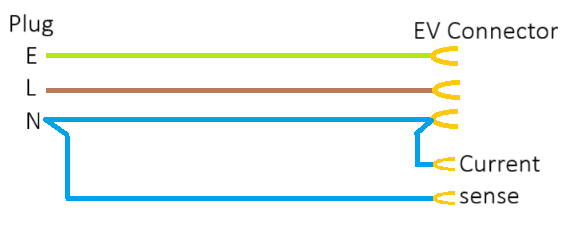

Can't see it saving you any money at all, you can pick up one of the Screwfix tethered chargers for £350, and that's only a single unit to install. I don't see a massive issue with your idea, technically chargers are supposed to be supplied with a "dedicated" circuit but you could argue it would be while the charger is connected. Honestly the third picture on their own website is the biggest reason to get a proper charger, that's exactly how I expect it to get used and apart from looking ropey there's a much bigger chance it's going to be subject to mechanical damage or be pulled out from the socket - not something I'd be keen on with a device that consistently draws its full load current.
Again, I expect that you'll end up paying more getting someone to fit your proposed equipment and it's just an inferior solution.
