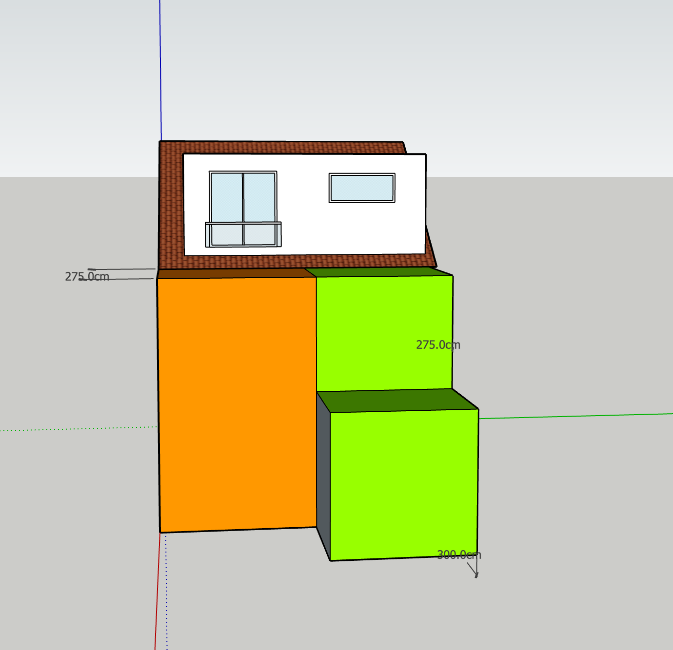

I have a 1930s semi, with an original kitchen extension. I sent a LDC request to the council to extend the back of the house 3m out and the 1st floor 3m out 2m away form the neighbour.
The LDC was refused for a few reasons, one of them being the current kitchen extension is original and anything built off that would be classed a side extension, even if that wall were demolished. The current original kitchen is 3m wide and 2m long.
So does anyone know if I could build a 2 storey extension on the one half of the back of my house using PD (I would be 2m away form both neighbours, the ground floor would be 3m deep and the 1st floor would be 2.75m deep).
And then build using planning permission (assuming it was granted) 2.75m deep on both floors on the other half of the rear of the house?
I've uploaded a quick sketch, the green block is the PD, first floor 2.75m form original wall an ground floor is 3m from original wall. The orange block is 2.75m deep top and bottom.

Think the pd rights are calculated on the basis of the original house

I don't know the answer to the question it depresses me too much. I suspect not as it would be a 2 storey "side" extension. I know that sounds crazy but that's how they do it.
Elevations can be tricky to judge. Do you have a plan showing original & added to date (kitchen extension)?
Why do you want to combine them rather than just submit 1 planning application?
On first look your strategy is unlikely to be beneficial; this strategy could be used where you believe the LBC wouldn't give you permission for what you want in 1-go. However, you would need to do the PD first, in which case your planning application would presumably be refused.
