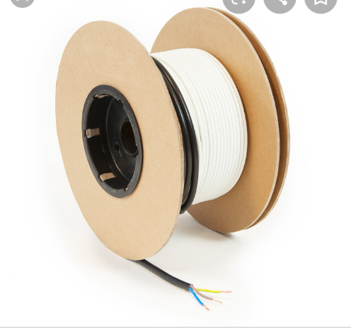

Just purchased. Roll of under floor heating cable from comfort zone manufacturer accidentally cut the cable I.have repaired it
And put a multimeter on to check continuity. can I now plug it to see if it gets hot or do I need a probe and thermostat attached for it to work .
You can plug just the floor cable in. Use a suitably sized fuse, and don’t leave it on for long.
If you wire it through the stat then you will need a floor probe.

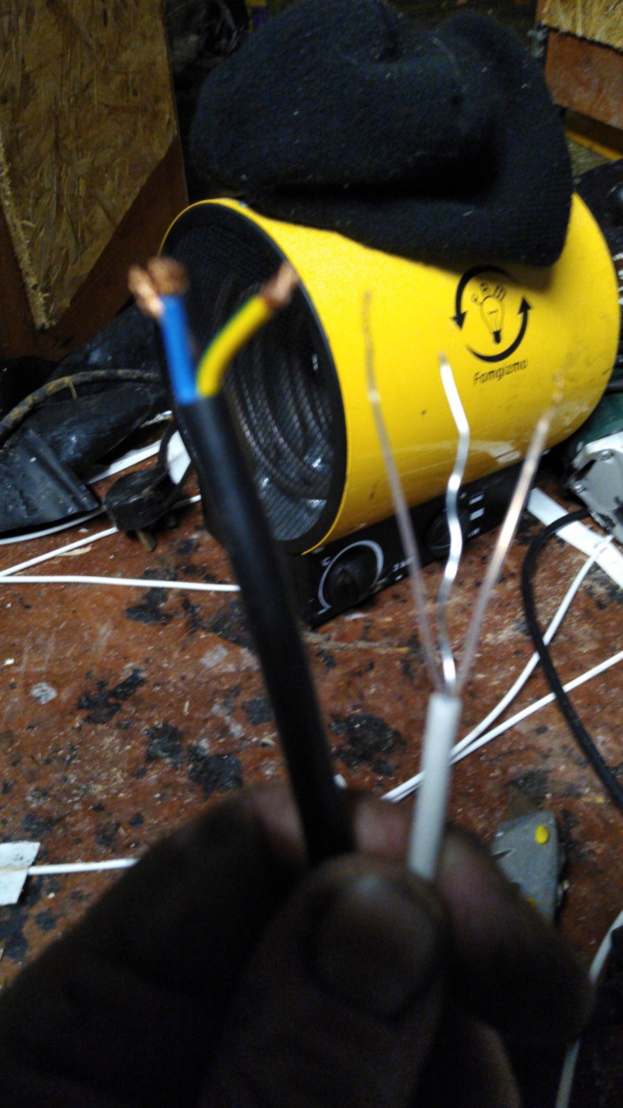

I did.a continuity check by cutting the end off
Does anyone know if the blue and brown are supposed to be joined at the end of the cable
Opposite end to the plug ? Is that what warms the cable ?
Really need a qualified electrician to understand how it's supposed to be wired
You should not have done that!
The end must be connected. How are you going to reconnect it?

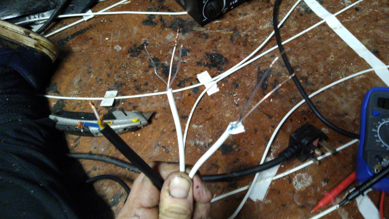

You need to test continuity between the blue and brown wires on the black cable. tell us how many ohms to get from your test.
If you’ve damaged the cable, and “repaired” it, and now cut the end off the element, then be prepared to have to pay for a new reel of heater cable.
I been told to connect the 2 wires together at the end of the cable and cut the earth back completely by crimping

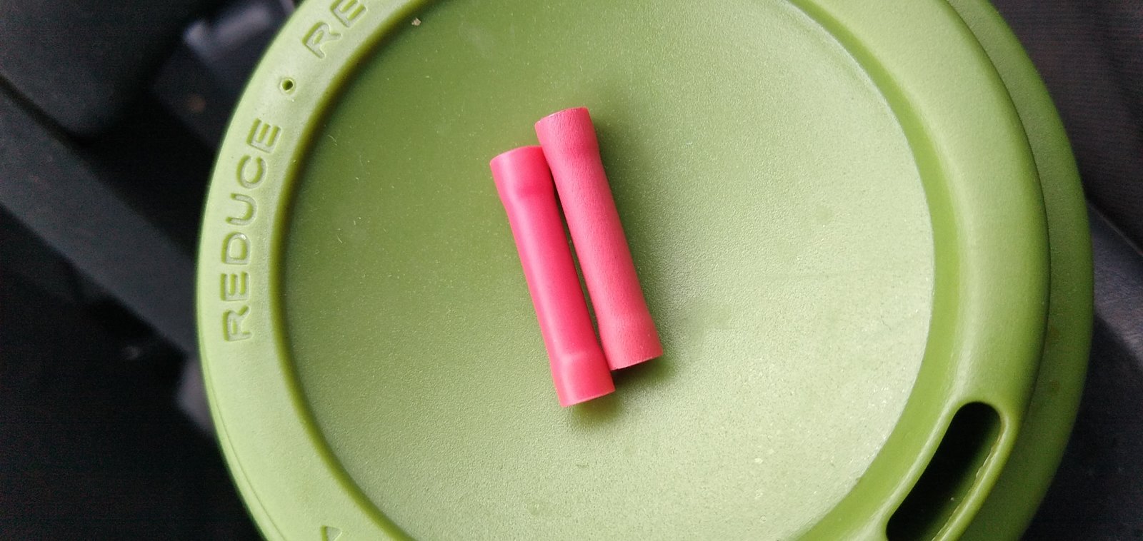

Silly question can't I just use these to reconnect them heat shrink wrap them
Just connected all up and getting a resistance reading of 50 which is what the label on the cable says
So am I good to install into self level screed.
Does the cable now heat up?
how will you ensure that your repairs do not, and can not, come into contact with the screed. If it does, then when you turn it on the RCD will instantly trip.
By totally insulating the connections I have made then heat shrink wrapped them all .
I'm guessing that will do it
