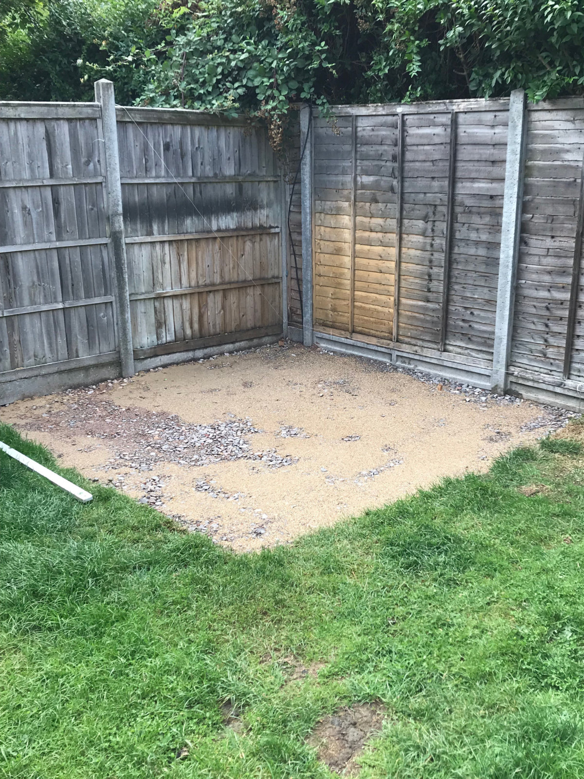

I'm in a similar situation - My first patio .... no way near as big as yours!
I have just wacker plated mine, in places the stones were large on top so I have added some sharp sand and vibrated it again!
Checked its rough level with a lump of decking on its side.

To make it roughly level I have whacked in wood and levelled the type 1 to just below them.
I'm going to put string lines at 90 degrees on the far sides to lay the pattern to as its just a 2.8m square.
The plan is to lay it on a screed mix and use screeding battons for the final level / fall - Hopefully this will work?!
