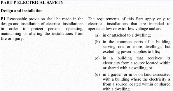

I know the rules allow anyone with the knowledge to do notifiable works, isn't the issue whether you can prove that? In the event of a fatal electrical fire, you would need to be able to show that you have the level of knowledge required to justify whatever you put on whatever form. If all you have is this thread and a youtube play list, I can't imagine that would play out very well.
True, but that's as much of an issue in the case of 'electricians' who have been 'trained' in just a few days as it is for a non-electrician.
The only 'knowledge' (in addition to 'skill') one needs is knowledge/understanding of the requirements of BS7671. If one can demonstrate that what one did was compliant with the requirements of BS7671 then, if one did it 'competently' (in a 'skill' sense), that would be deemed to demonstrate compliance with the law.
Kind Regards, John
Yes, I suppose it is.
For notifiable work, unless you are a registered electrician, you must, by law, notify the Local Authority before you start the work. It is up to them whether they accept that you are able to do the work. If you, as a DIYer have no test equipment, I presume they will not deem you competent.
Probably true.
Registered electrician means registered with one of the 'self-certifying' schemes (self-certifying is a misnomer and actually means self-notifying). There are many hugely qualified life-long electricians who are not registered because they don't need to be for their work and conversely many totally inexperienced 'electricians' who are registered. In England now there are so few notifiable jobs that it is virtually pointless, however, whatever anyone is doing Part P of The Building Regulations applies.
That's it - such is life.
