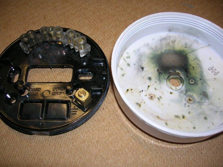

I got collared by a neighbour this morning to have a look at a pendant in his hallway, he'd replaced the old one and then the fuse blew immediately......., I had a quick look to see whats amiss and he'd basically screwed up his connections and fried the terminals :rolleyes: .
I've replaced the pendant and tested the circuit (all tests passed OK). Looking at his CU, an old grey metal 6 way wylex fuseboard, his MEB's are only 6mm.........(TNCS by the way).
So the question is can I just put them as undersized and recommend upgrading in the comments section in part 2 of the MWC or do I need to upgrade them ???
