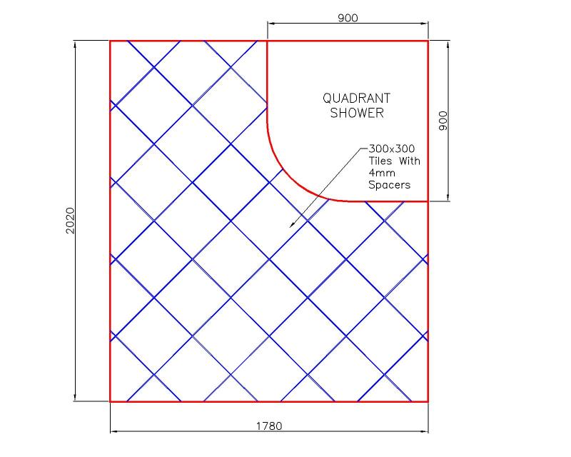

I Have already offered a draughting service posted 8/7/2008, 22:08, even though I meant it for Gcol and Jefross you are welcome to post your room shape and dimensions, tile and spacer sizes etc. I would be happy to post a drawing for Gcol to approve :D . Seriously no need for a dry run, I could knock it up in minutes.

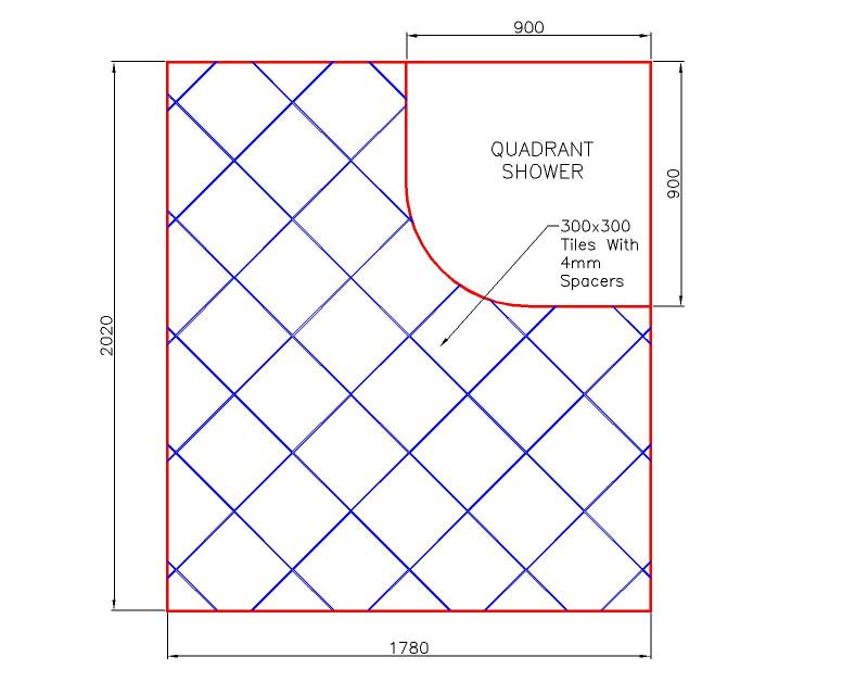

1.78m (w) x 2.02m (h) with a 900mmx900mm quadrant shower in top right. Tile 300m2, spacers 4mm
As requested.
Cross center
Tile center
I dont know which is the norm. But gcol will tell us.

OK, since you asked, the top to bottom layout is fine, buit you need to shift the left/right layout to get rid of those little pieces of tile. I reckon about 1/4 of a tile to the left would be about right, but it's hard trying to visualise it in my wine addled brain at present. :confused:
You can't go a half tile to one side as you would with regular square laid tiles cause you'd end up with the same problem on the tiled row above.

cheers for that - nice little diagram. I marked out the floor last night for a normal pattern. I have some skinny tiles next to the shower that I need to resolve. I'll just shift it all to the left slightly though I think.
