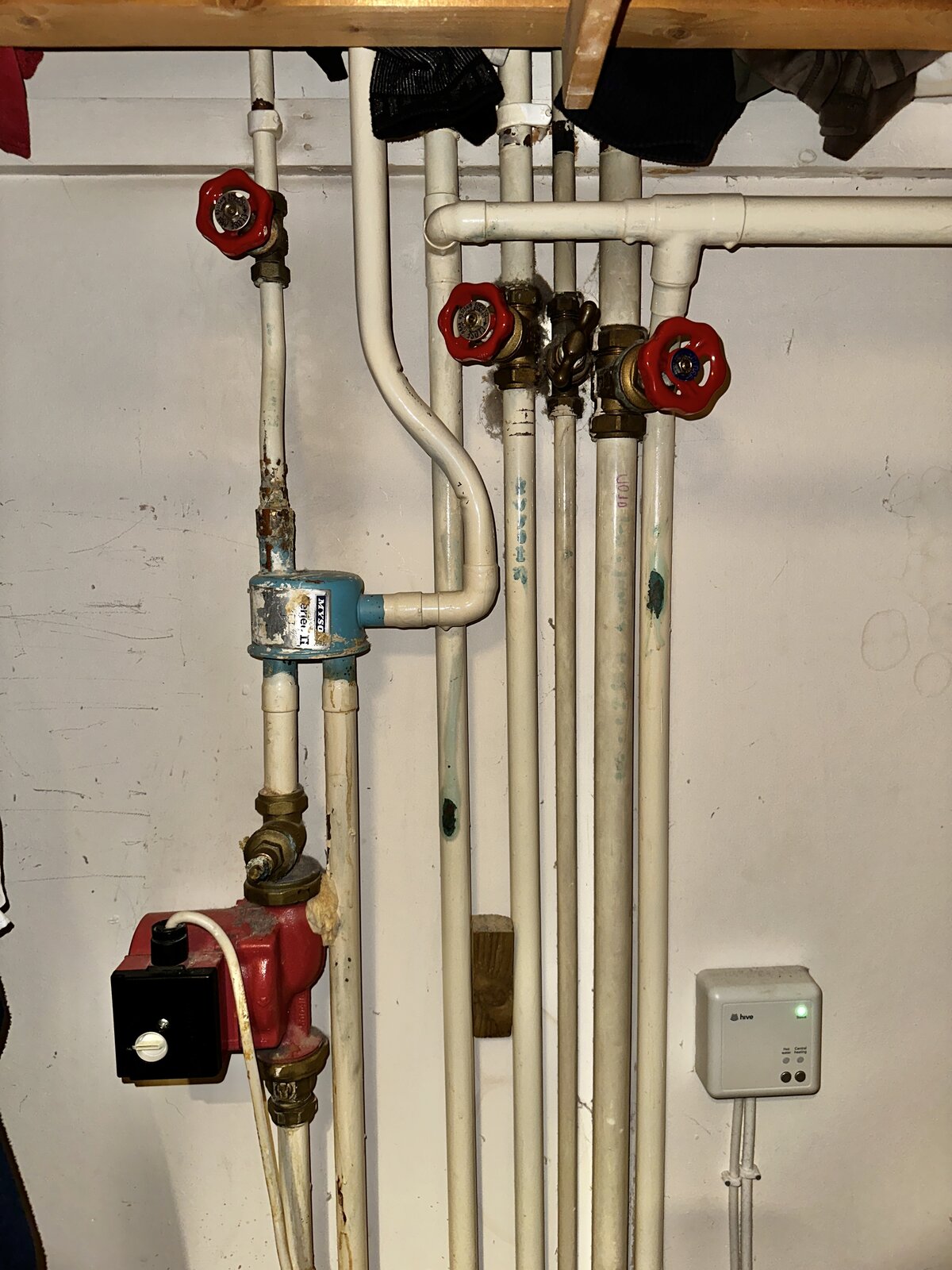

We've got one of these online boiler companies coming to fit a new boiler and hot water cylinder. They won't consider any other work (I have asked) but they all work with subcontracted engineers and I am hoping when they arrive I can offer cash in hand for all 5 of our gate valves to be replaced (1 is stick closed, one is leaking and the others are all stiff).
1) Is this acceptable or is it rude asking for extra work when they are here for another job?
2) What would be an appropriate cash cost for this extra work
It makes a lot of sense for us to do this at the same time as cylinder replacement as the system will be drained and one of these ball valves is located behind the tank; but if not we will just get a local guy over when the work is complete.

DIY - It would not be a difficult job.
Why employ someone who will not do what you want ?.
Because for the job they are doing, the online boiler outfits (heatable, box, iHeat) are all £800+ cheaper our than local fitters. It also allows us to take advantage of interest free repayments which local fitters don't offer.
If you're getting new valves, avoid the ones that are £8 for ten. As I expect you have found, they are poor quality and often leak.
The Pegler ones are very much better quality. The ones with a lever are easiest to operate if you have room, but the Tee handles are neater

Thanks, I will buy them. Any particular make/model?
I believe I need
1 x 15mm
1 x 22mm
2x 28mm (one located behind the cylinder)
Plus there's one that is 15mm (looks like the top of a garden tap, not sure on name!) with I may as well replace for peace of mind...
