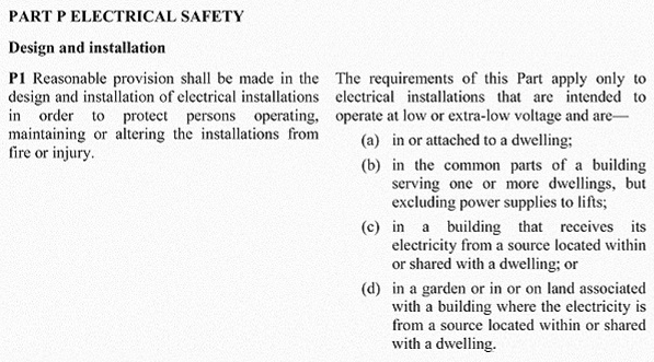

Thanks for link, yes all Compliance Certificate not completion my error, I will wait for the G99 and installation certificate as the Compliance Certificate may be included with it. But "Install one or more new circuits - House Dwelling" could mean anything. Why do they bother with Part P?
It's a money extracting exercise, nothing more.
Seems sensible to me.
That's all there is - as said many times in the eighteen years since introduction.
Anything else you're thinking of is not Part P.
