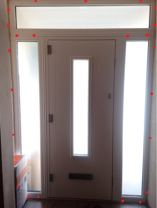

I've had these installed as part of my building work.. They seems solid enough, but they flex enough for the front door to shudder and shake when closed.
Is there anything that can be done? would increasing the number of frame fixings help. The installer is saying they have tightened the fixings, but we can't see an improvement.
Is this something that is just part of having composite doors?

Looks like Pvc frames to me. My guess is its where the frames are joining one another that its ' shuddering ' as the whole frame flexes. I would be intrigued to see if they have used a reinforcement between the frames and what type
Hi,
probably you have to ask to the installator to increase the number of fixings to the wall and between the profiles. See in the attached pictures the red dots for example .

Unfortunately a bit of flex is pretty much unavoidable when you have sidelights combine that with a full width toplight too and it makes things worse.
Looks like you have aluminum door couplers on both sides and the top so not much that can be done without a complete redesign.
If it works and that is the design/look you ordered then there is not much that can be done.
I have seen super heavy duty couplers that stick out from the frame by a few inchs but they are pretty hideous

you can fix the frames to the wall with aluminium L-brackets and then cover with an aesthetic profile.

No amount of extra fixings will make a difference (assuming he has done the recommended 600mm fixing spacing when joining the frames).
This is due to the flex in the 3 separate frames and the aluminum couplers.
If the frame isn't moving where it's fixed to the wall then it doesn't need more fixings, if the hinge or lock side is wobbling when shutting the door then unfortunately it's the nature of the beast especially heavy doors that are hung off or close onto side panels, the only way to counter that is to fit heavy duty reinforced frame couplers
