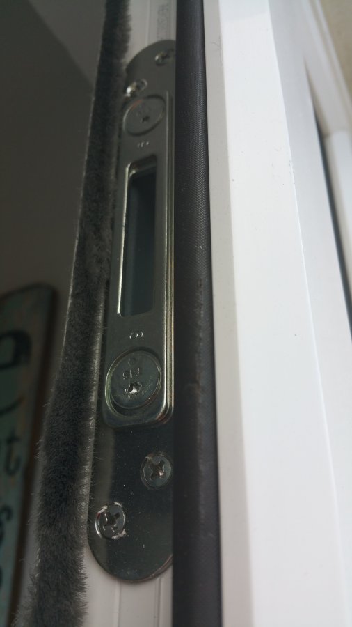

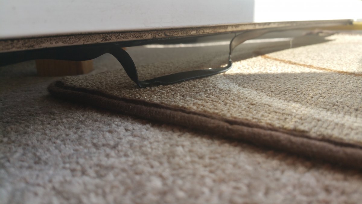

Was sent out the other day to look at torn gasket on a 2 year old rocal door.....
Around the handle
Near the top hook

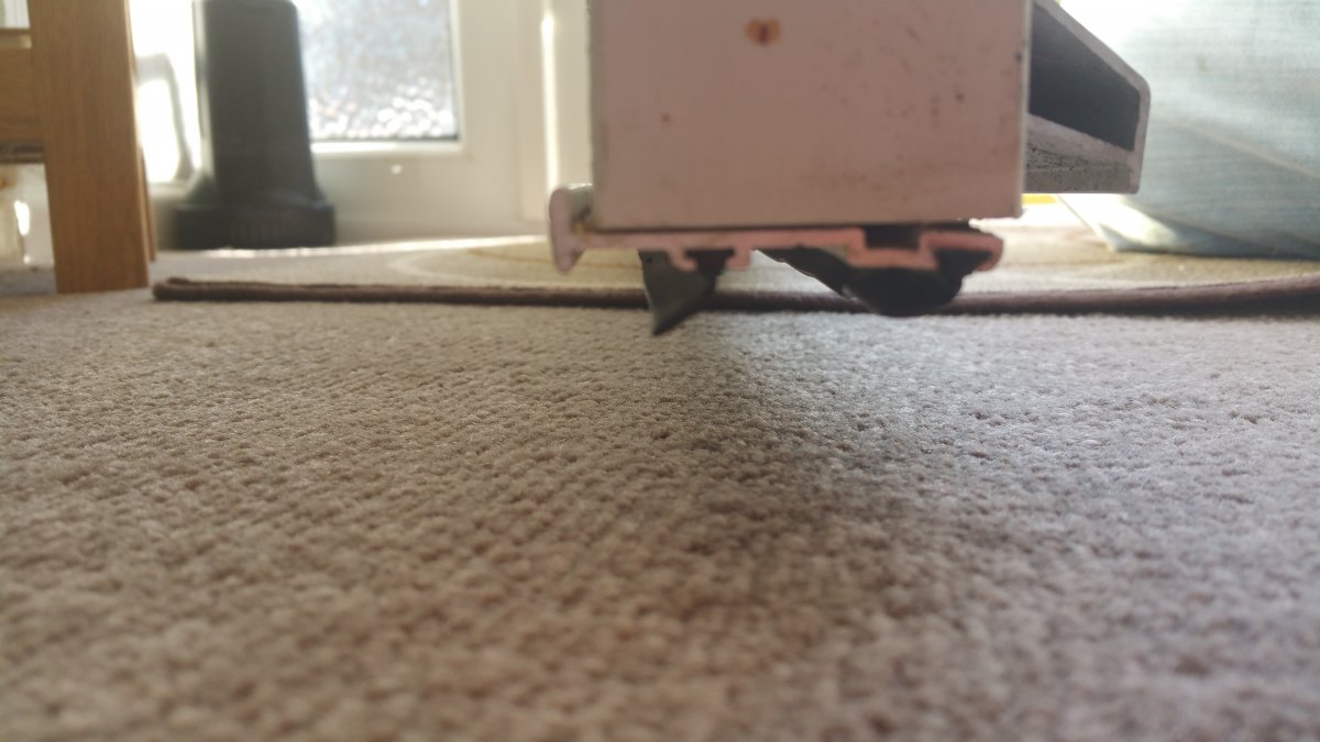

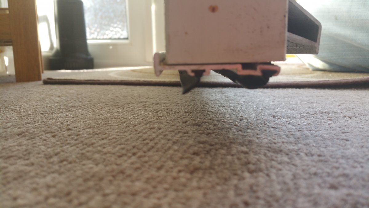

On another door, this a doorstop was torn gasket, 5 years old
