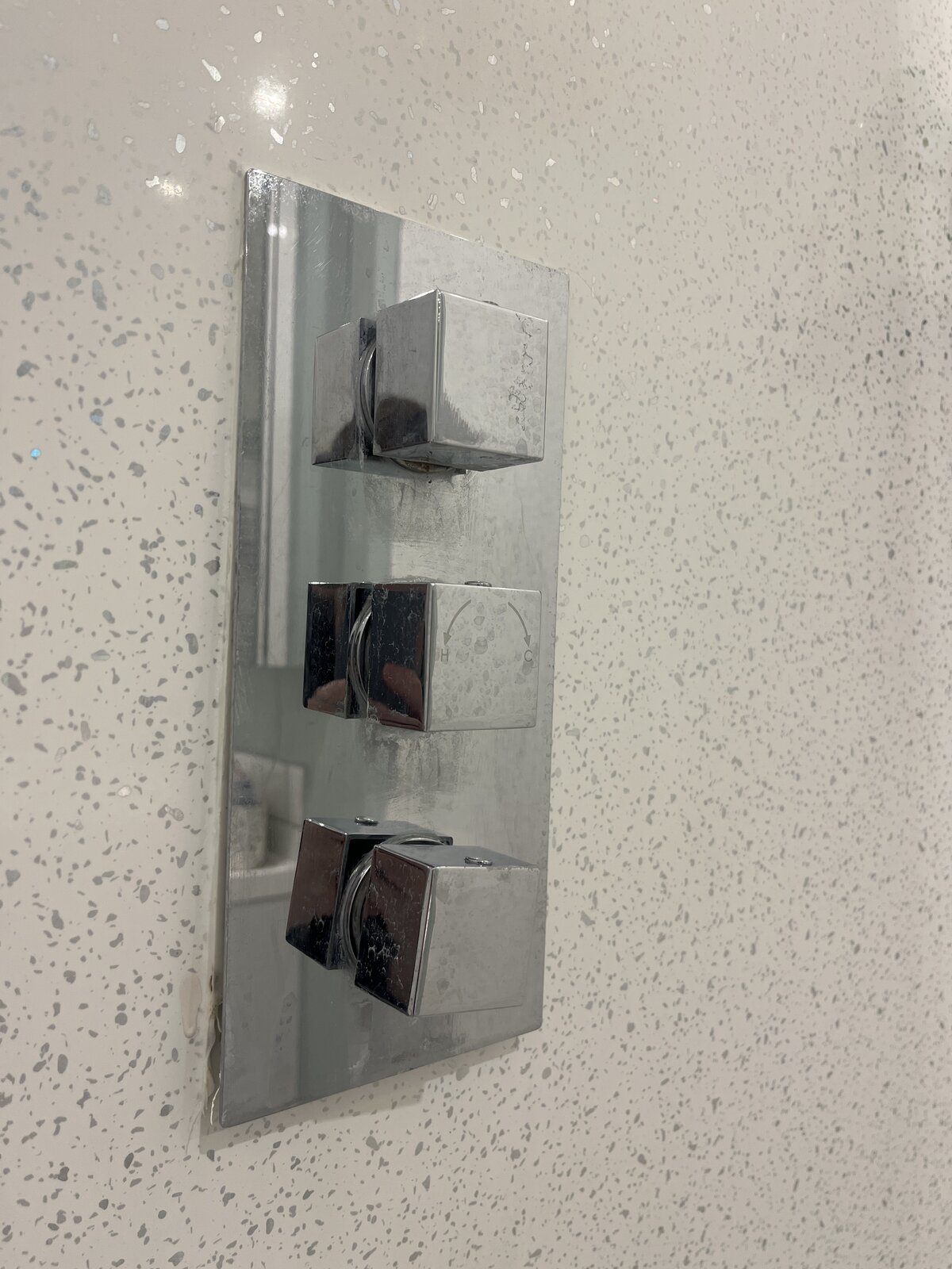

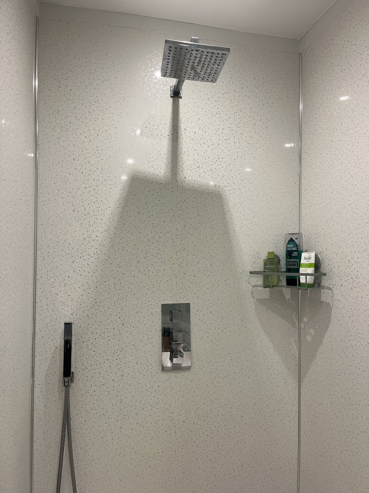

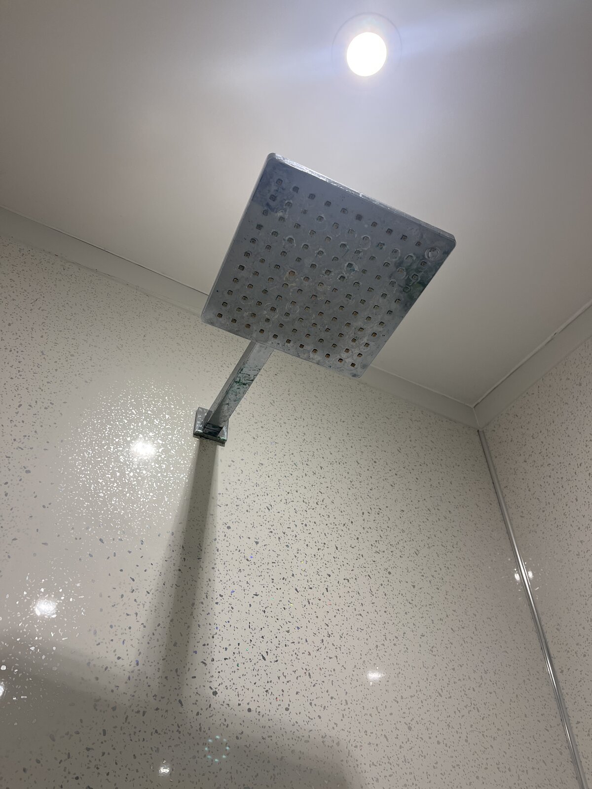

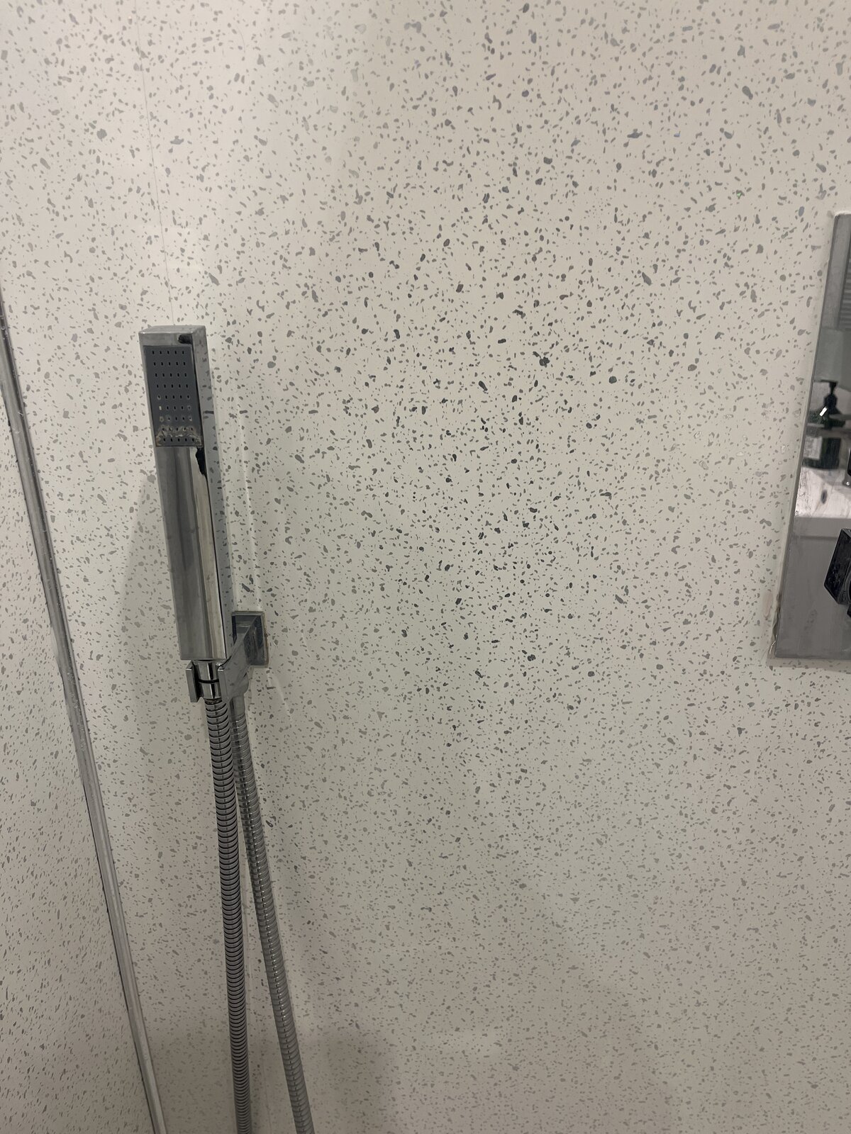

Hello - we moved into our flat in February and have been putting up with a leaking shower since, but want it sorted now! Sounds like we need a new cartridge. It’s a concealed shower though and we don’t know the brand, can anyone help? A local plumber has said since we don’t know the brand we’ll need it rip it out and start again which we’re keen to avoid… any help greatly appreciated!

Hard to tell, as usually major manufacturers stamp their name on it. You could try the Showerdoc or it could be generic type. Best bet is to remove the cartridge and go from there
