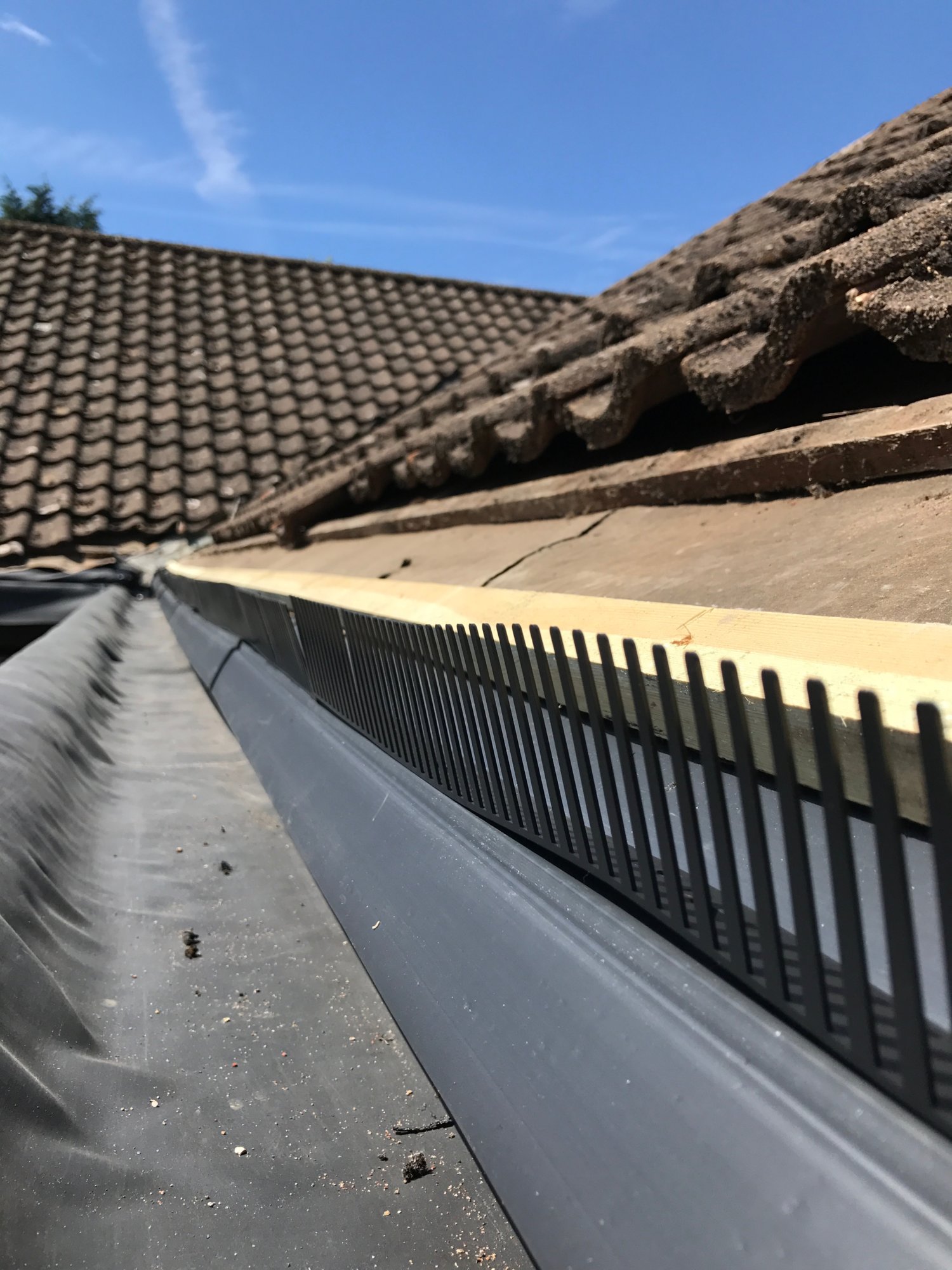

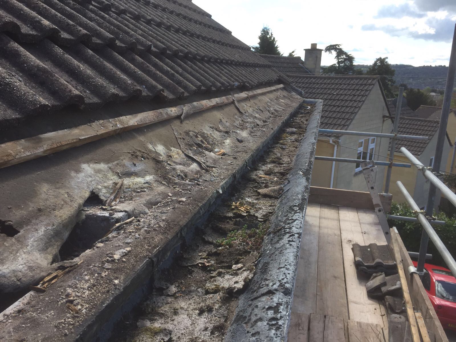

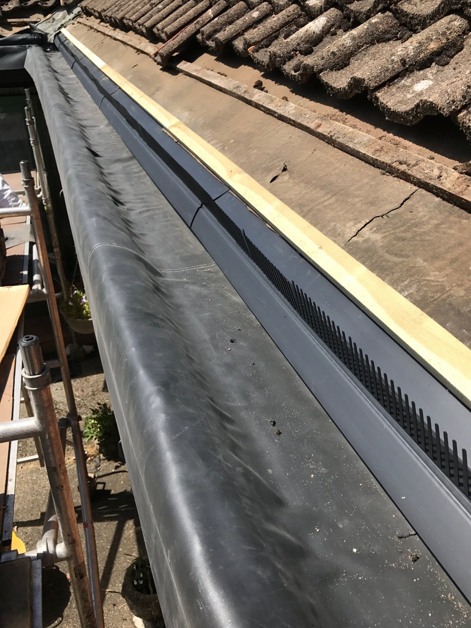

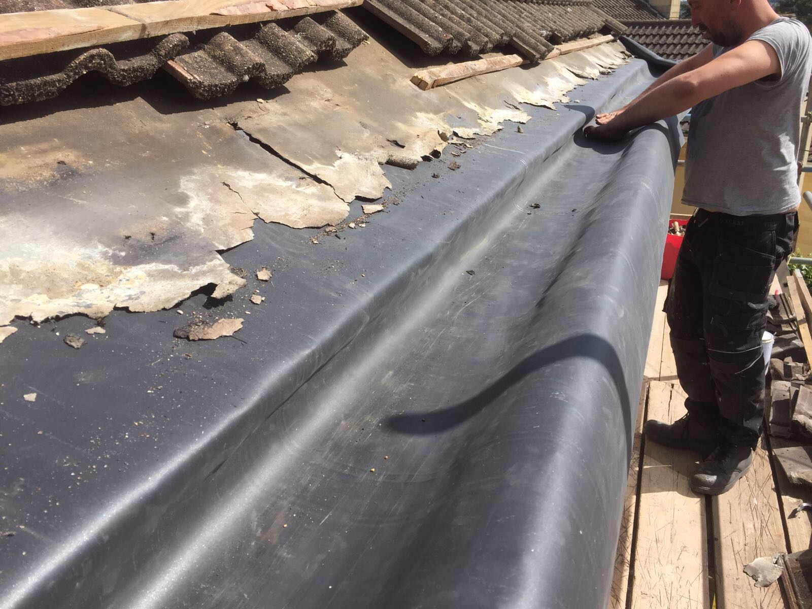

Below are pics of a recent job we lined down south. I had more pics but can’t find them but the finished gutter pointed underneath, sealed and painted in the original oatmeal colour that was on the house 80 years ago looks lovely.
Conc gutters last forever if looked after properly :-)
