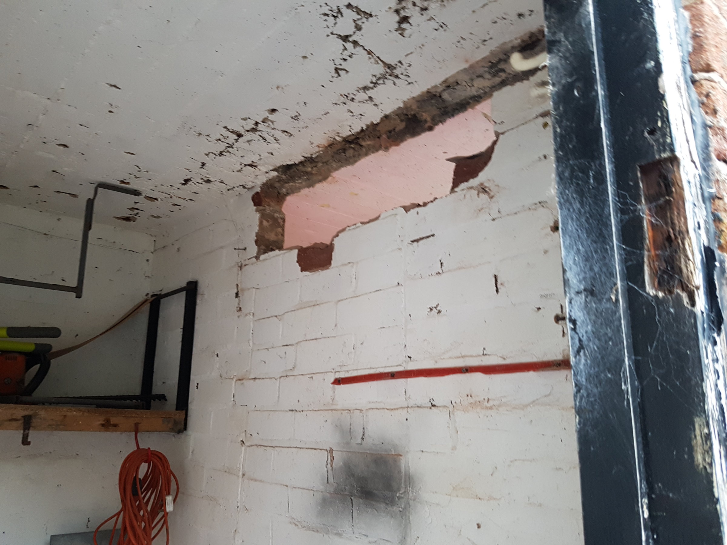

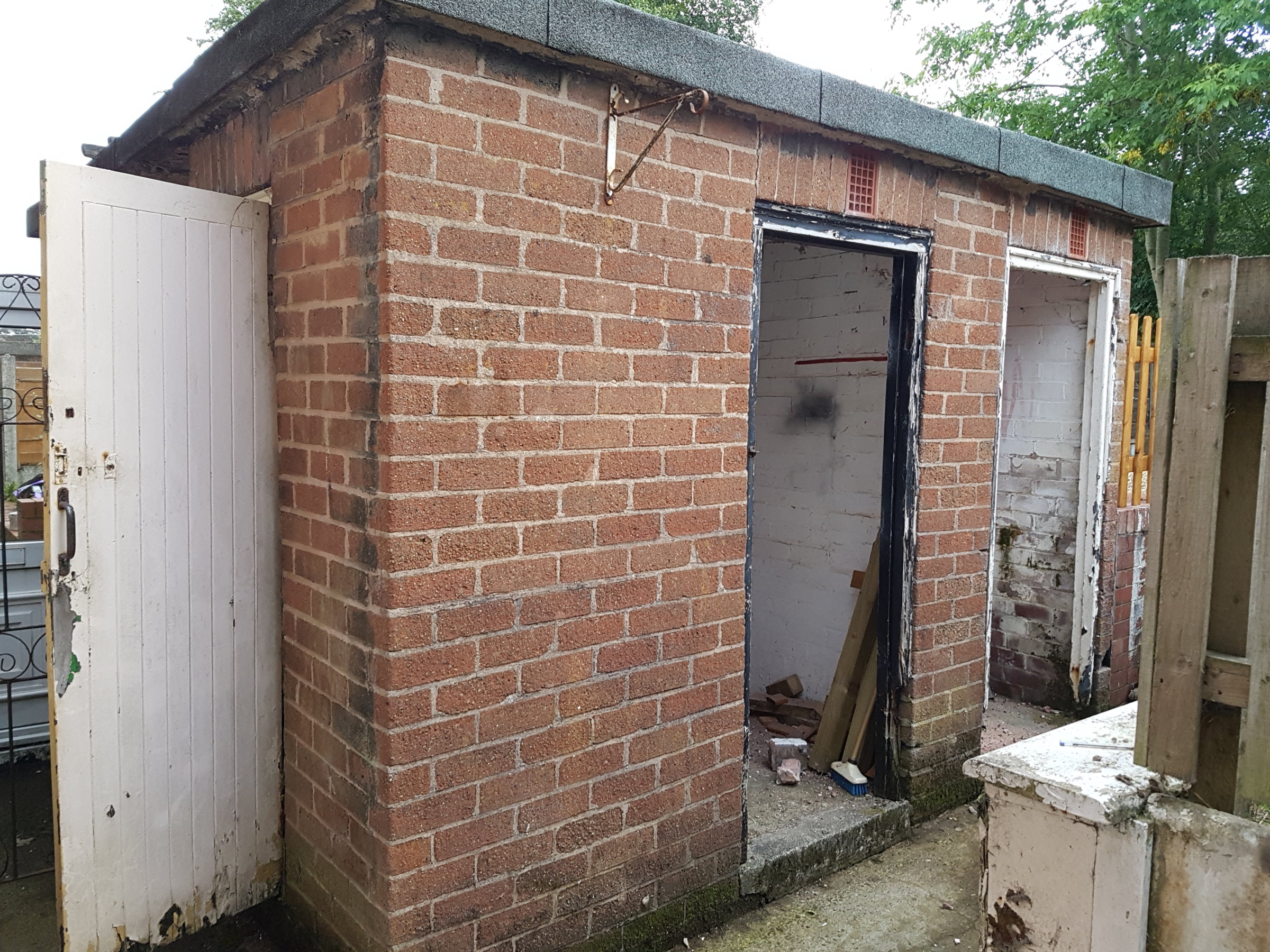

I have an outhouse that is currently seperated into 3 seperate spaces (storage/coal cupboard/toilet) it's brick built with a concrete roof. I want to remove the internal walls to create an open space and make use of it in some way.
My dad was concerned that it might be load bearing so I asked a builder who's done work on my house to come and take a look. He told me to take a brick out miss one then take another out so he could see. He came round and said it was re-enforced concrete and I needn't worry. So I went ahead and took out some more bricks.
Feeling pleased with myself (I've never really done DIY before) I took a picture and put it on fb next my dad is warning me again about it possibly coming down whilst I'm working under it. This is worrying me for obvious reasons so I'm thinking maybe I should use some acrows to support it just incase.
I'm wondering if anyone has any advice, should I use acrows (or something similar) or not?
if thats a single monoslab with wire or rebar in it thers no problem.
these slabs were usuly cast in one piece.
but i cant see if thers a join above the dividin wall - probly not.
follow the shutterin board marks an see if they run through from one side of the wall to the other.
to be safe, just openup below the openin youve made. go down to the floor. an leave it like that for a few weeks to see if any cracks appear.
its not an old air raid shelter is it?
If it needed acrows while you were working under it, it would need support when it was finished, wouldn't it?
The son- in- law of a friend of mine was killed a few years ago doing this when one of the perimeter walls collapsed due to the extra weight on it when the interior wall was in the process of being removed. That isn't to say yours will but what I am saying is be very careful. Please get further advice.

I think based on this alone it would be good to prop it during removal and put some permanent support in going forward.

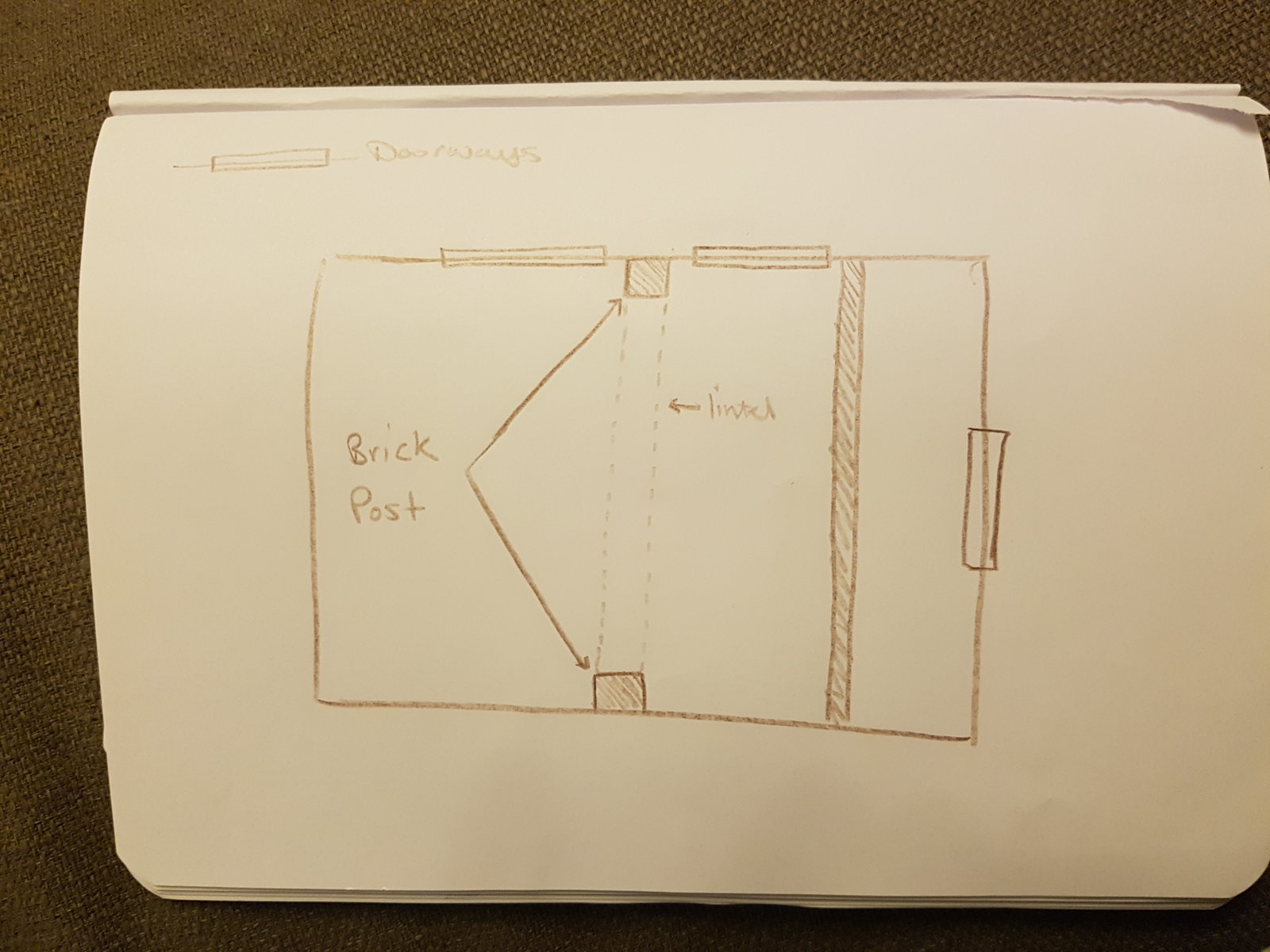

A thought was to build two brick posts to the left and right of where the wall currently is and use that to rest a lintel on. Would this be a good approach?
I agree with getting more advice the problem I'm finding with builders is they look and say "yeah it'll be reet that" but don't give the reasoning behind why they believe that. I asked the one the other day and he just said through experience which I appreciate but still.
If there is doubt about the existing roof, you could remove all of it and replace with a timber structure.

Someone in our area got crushed to death under one of those as well so just be careful when you're knocking bricks out!.
