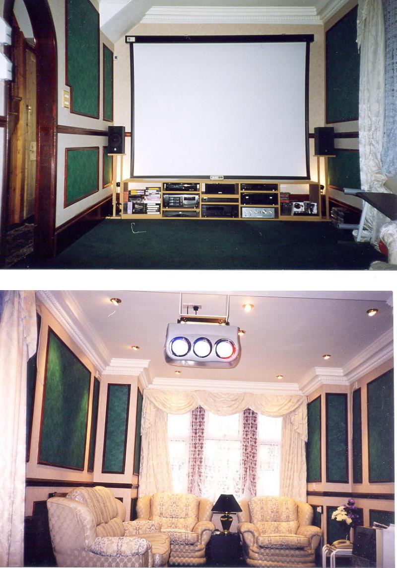

thanks for the advice julesmountain..... i think i have covered the basics that u have described in your post. but my main concern now is the cabling below the existing floor. u see i have about 3 million cables down there as i have a very hi-tech home cinema setup and all the cabling is down below this existing floor; and am not sure wot to cover them with in order for the screed and concrete not to contaminate and destroy them! i dont know if ordinary plastic cable conduit will do.i also have to consider the covering up of the electrical socket cabling on possible conduiting, but maybe with a conduit with a spilt in the middle as i dont want to rip out the existing sockets from the walls!..... i also have my my electrical and gas supplies coming into the house which i also have to consider. wot do i cover these up with?......i know i will be covering all the new pipework for the under floor heating with 4" denzo tape before applying the 4" of screed and then tiling. but i dont think i wud wonna add denzo tape to cover the wiring..... pls advice in this protection of cables issue, with maybe a link so that i could see the product myself. many thanx will wait for your reply.
