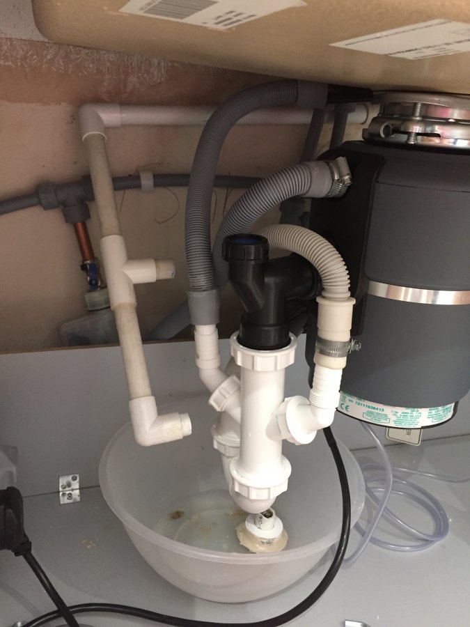

Hi Everyone,
I was hoping some of you may help. Our insinkerator has broken down so I've plumbed in a new one (of different size). The problem I have is where it is now ok to situate the condensate pipe. I'm not sure if I can put it into one of the 'Y' arms which would be opposite the washing machine or whether I can put it into the black fitting above the waste pipe. (putting it in black fitting at top would be my personal preference).
Of course if there's a blockage the waste water will go up the condensate pipe to the boiler however as you can see in the photo its quite a long run along the walls of the kitchen and then up to the boiler (approximately 3+ metres in total.) I'm also not sure regarding pressures etc. where it should fit and preferably want to us the fittings I already have which are in place. Photos show how it was and how it is now (I have new 22mm pipe and some elbow fittings). Many thanks!

The condensate pipe is classed as being part of the flue system and should therefore only be worked on by Gas Safe Registered engineers
Really? It has already been worked on at the boiler side which isn't being touched But that doesn't really answer my question above, otherwise you'd give that answer to everyone asking on this forum when it's a question on boilers. This is merely a question on the plumbing part of the waste pipe.
We're not allowed to give advice on how to work on things that affect the safety of the boiler - that's the forum rule. No advice on gas work, no advice on working on the flue system, including the entire condensate run. You shouldn't operate your boiler with the condensate not plumbed in - it could cause flue gases including carbon monoxide to enter the room, which could be terminal for your health

Andrew, firstly this does not affect the safety of the boiler. The system is already plumbed in as is the condensate pipe. All I'm asking for is some advice as to the best location in the waste stack that this can be replumbed into. This does not affect the safety of the boiler as it is not doing something new. The condensate pipe everyone knows has to either go outside into a drain or internally into the main waste pipe. This isn't working on the boiler system it's simply getting an idea as to which is the best part of the waste stack to plumb it into now that the layout has changed slightly. If you look at the rest of the forum you'll see tons of these types of questions asked yet I don't see you nor anyone else policing these posts. I'd be interested in getting a few other third party opinions please. PS. the condensate pipe IS plumbed in, it's just not terminated into the new waste pipe stack.

The condense discharge originally terminated into the waste pipe upstream of trap water seal....I think the OP would would of had a problem before now..:ROFLMAO::ROFLMAO:.

Again, the simple question I want to know is whether I plumb the condensate pipe into the top of the black tee connector at the top of the stack (where potentially the condensate flows into the insinkerator waste pipe) or lower down into one of the 'Y' arms opposite the washing machine outlet pipe, or whether it won't make a difference, - as my only concern was the overflow for the sink was connected into the middle of the condensate pipe before, and I wasn't sure if this was done so as to create an air gap. That bit of technical knowledge I don't have - but what I'm asking for is not a life/death situation that necessarily requires me to get a GSR pro in.

No it shouldn't be connected to the black bit. It was wrong before, as GW points out.
Tee it in down steam of the trap
