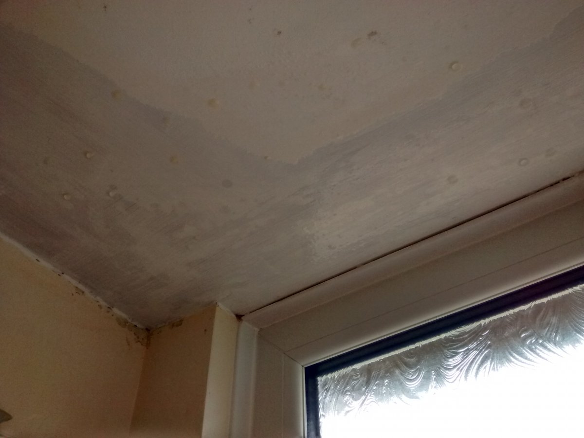

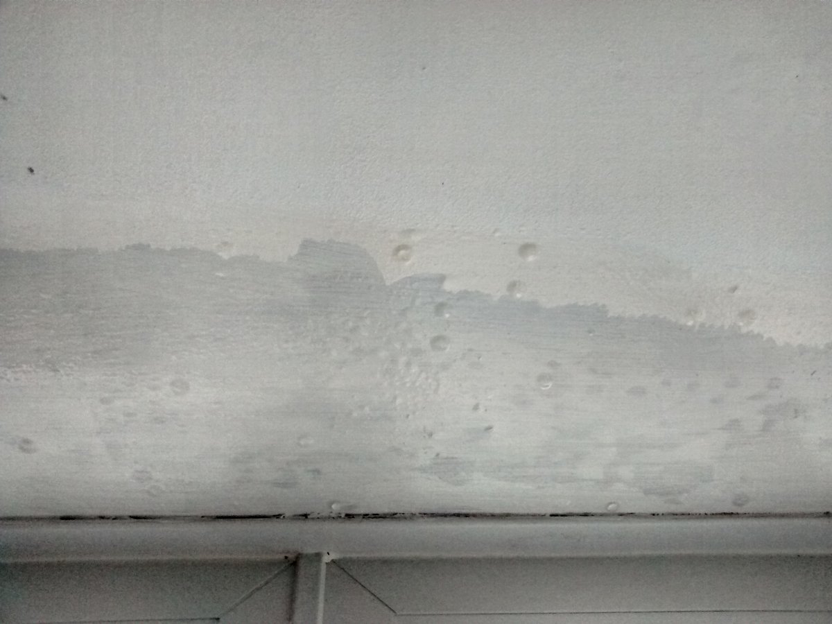

Hi all,
Long time reader, first time poster. Hopefully someone out there can help, i'm struggling with this one!

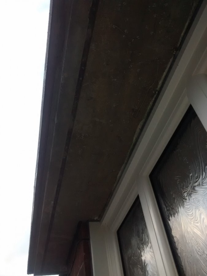

Long story short, the ceiling in our porch (i say porch but its really a small hallway that pertrudes the front of the house with a flat roof) gets condensation on it from time to time and this results in mold forming.
We had a new front door fitted along with windows around a year ago but no change, i have turned the radiator completely off, on slightly and fully on and either way the condensation appears. We even went to the trouble of coating the flat roof outside with bitumin, in case water was getting in somwhere but this didnt solve it.
I'm stumped, i know its going to be somthing to do with the ceiling being cooler than the air but this cant have been doing this since the house was built, around 1965, ex local authority. A neighbour had this and resorted to having a pitched roof put on, but next doot has no trouble what so ever.
In the pictures you can see where i have removed the paint back to plaster, treated with mold killer, painted with damp seal and then one coat of white paint before i noticed the condensation was still appearing.
Father in law suggested Round drill weep vents, however i dont have experience of these so would that help?
Any help much appreciated,
Shaun

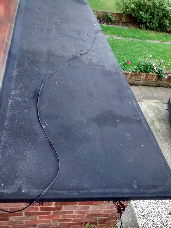

Here's a picture of the roof from above.

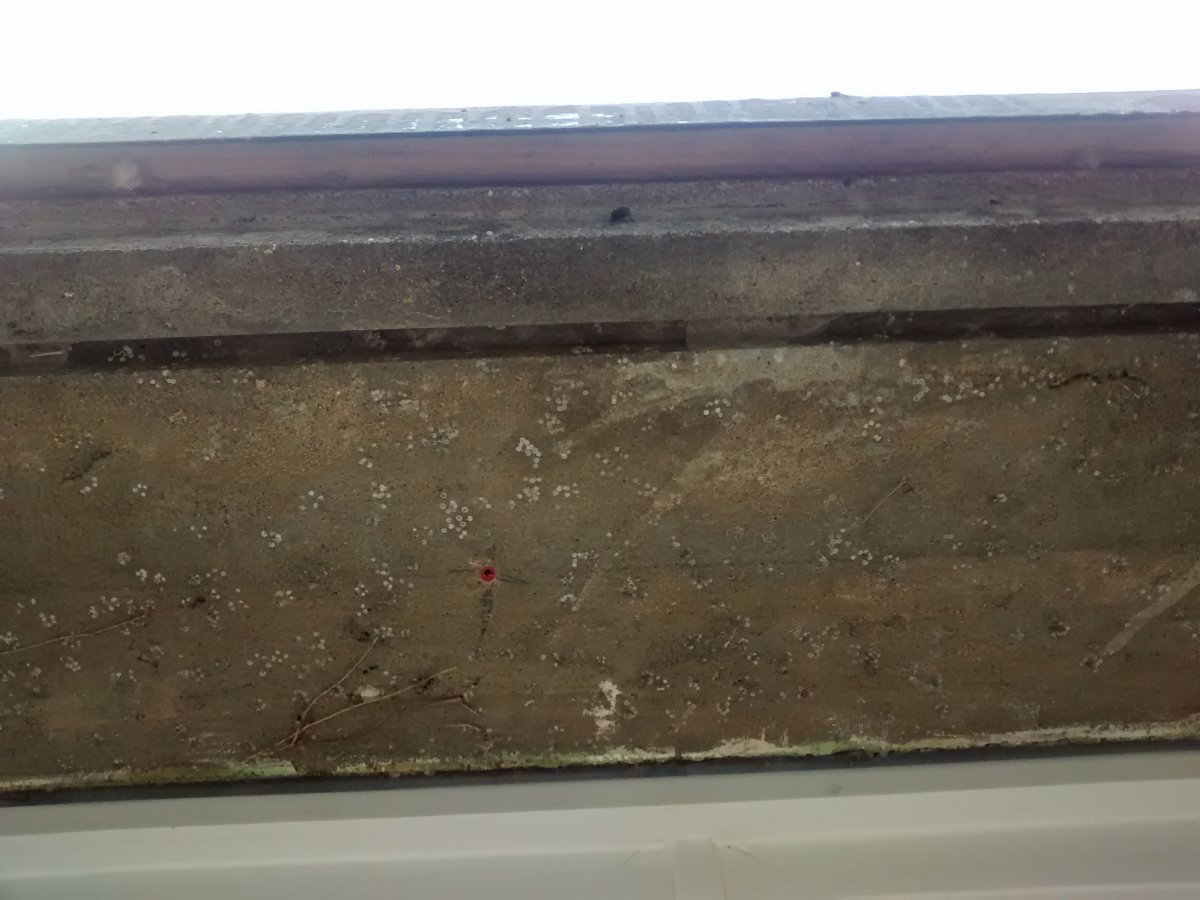

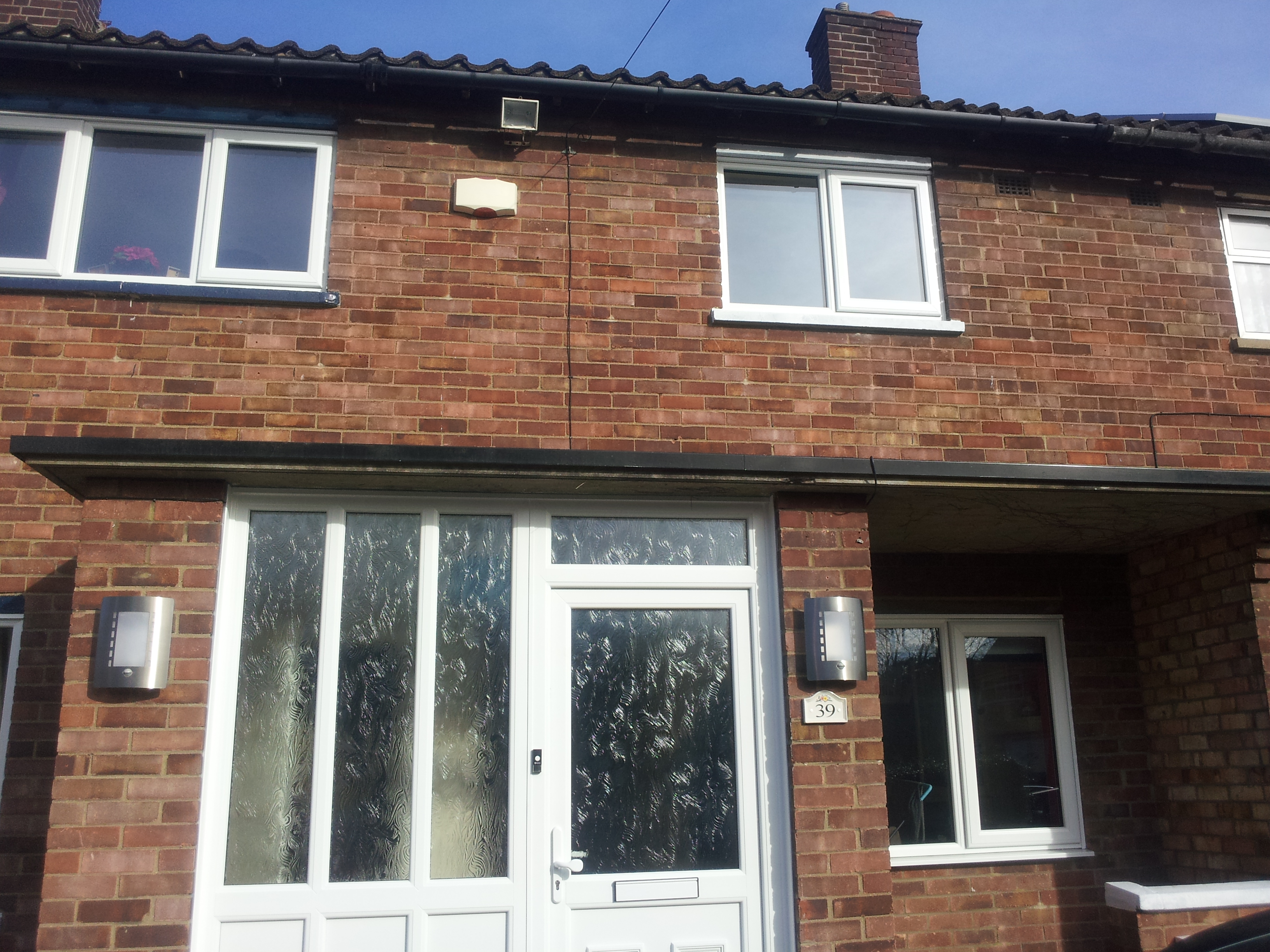

I don't see any guttering or drip bars/channel - can you take a picture outside looking up at the edge of the roof?
Hi,
Sorry for the late reply, here's some pictures from the underside looking up. No gutter, just an overlap all the way round.
Shaun
Just my theory Shaun, but when it rains, is water coursing over the edge and onto that concrete slab roof......maybe its being kept permanently damp due to this and the thing is saturated somewhat? Naturally enough, the slab will always be cold, but see if you can spot where the rain goes.

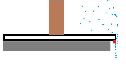

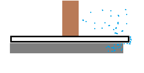

That's kind of what I was thinking too - it doesn't look like there's much of a 'drip channel' to the underside of the roof (sorry not sure of the technical term!) so I'm wondering if water is running round to the underside and back into the house or just soaking the concrete. (see roof 1 png)
An easy way to find out would be to insert a strip of plastic etc between the edge of the roof and the concrete to act as a drip 'lip' (see roof 2).

Thanks to you all for the advice, will see if I can try making a drip lip and see if that helps.
The slab is, I think, a timber frame with some sort of concrete or render over it. When I was round one of the neighbours I could see timber where concrete had broken off, so I can see that getting saturated could be making the inside of the roof wet and maybe leeching through the ceiling.

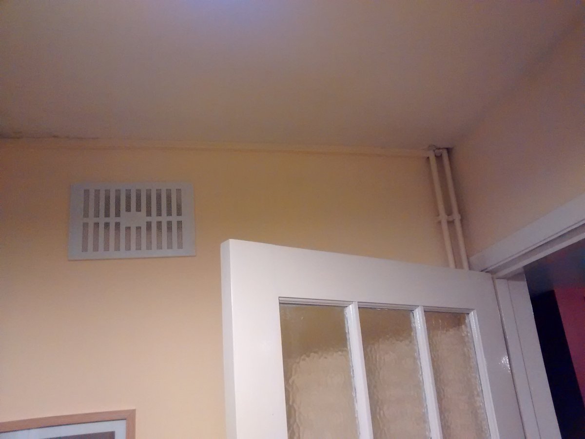

Firstly apologies for not getting my backside on here sooner, been so busy these last few weeks. We seem to have cracked it and, fingers crossed, no longer have condensation forming.

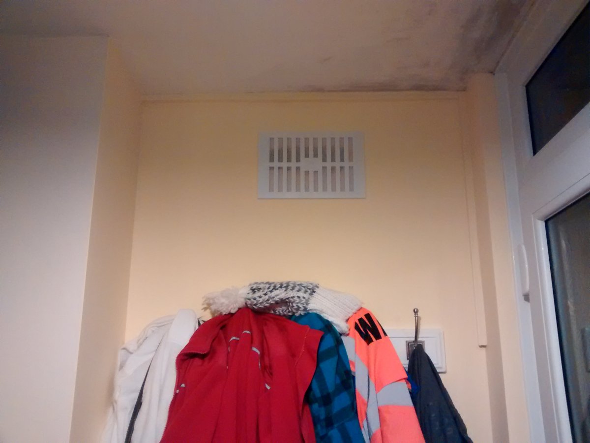

After speaking to our neighbour and inspecting their setup they have air bricks on either side of the porch/hallway which go through to the inside with vents that can be closed off. After some drilling in our hall we discovered the original holes where vents would have been, just filled in and plastered over. Removal of this revealed a lined cavity through to the outside air bricks we have, and so we have reinstated these.

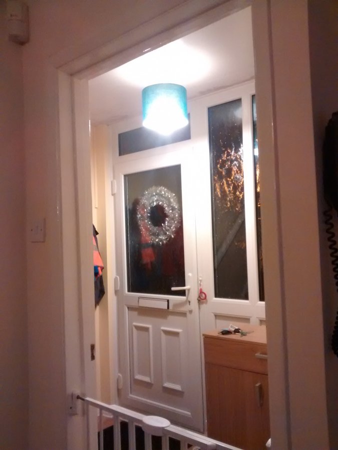

The "porch" as i describe it is integral to the house, in that if you were to remove it, the front room door and bottom of the stairs would be on show to the neighbours.
Its a strange construction in that its a small hallway but sticks out from the house rather than being within the line of the front of the house. The front door is where it has always been, not been moved forward (this was done at my parents to make a larger hallway, but their porch went into the house rather than sticking out)

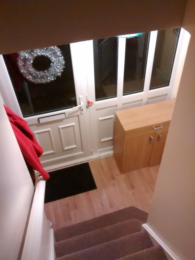

See attached pictures to show the inside layout, our house is the same construction as a lot of our neighbours. I probably didn't explain the construction of the hall/porch very well and should have used the term porch very loosely!
View from front room:
View from stairs:
Vents:
