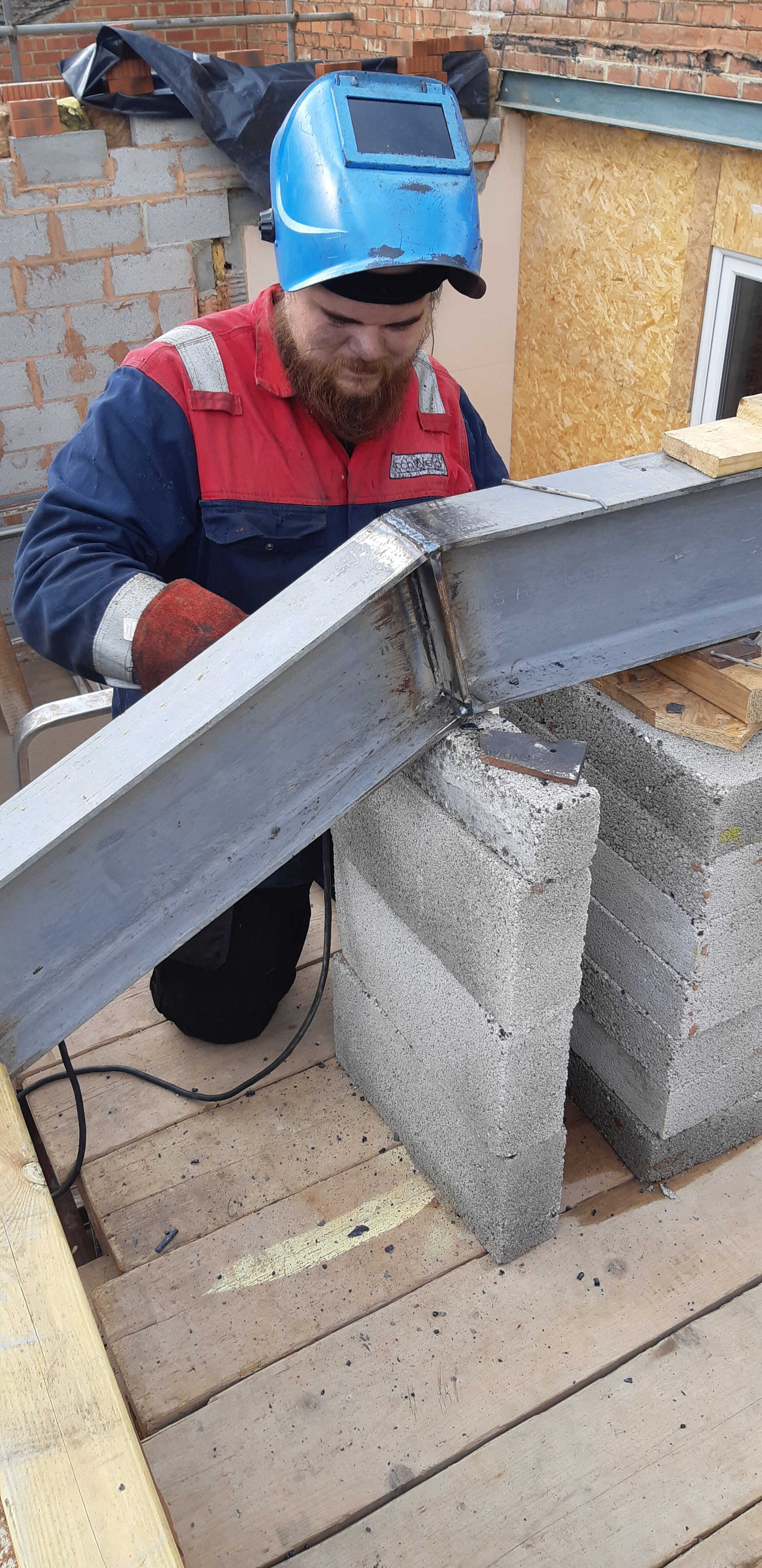

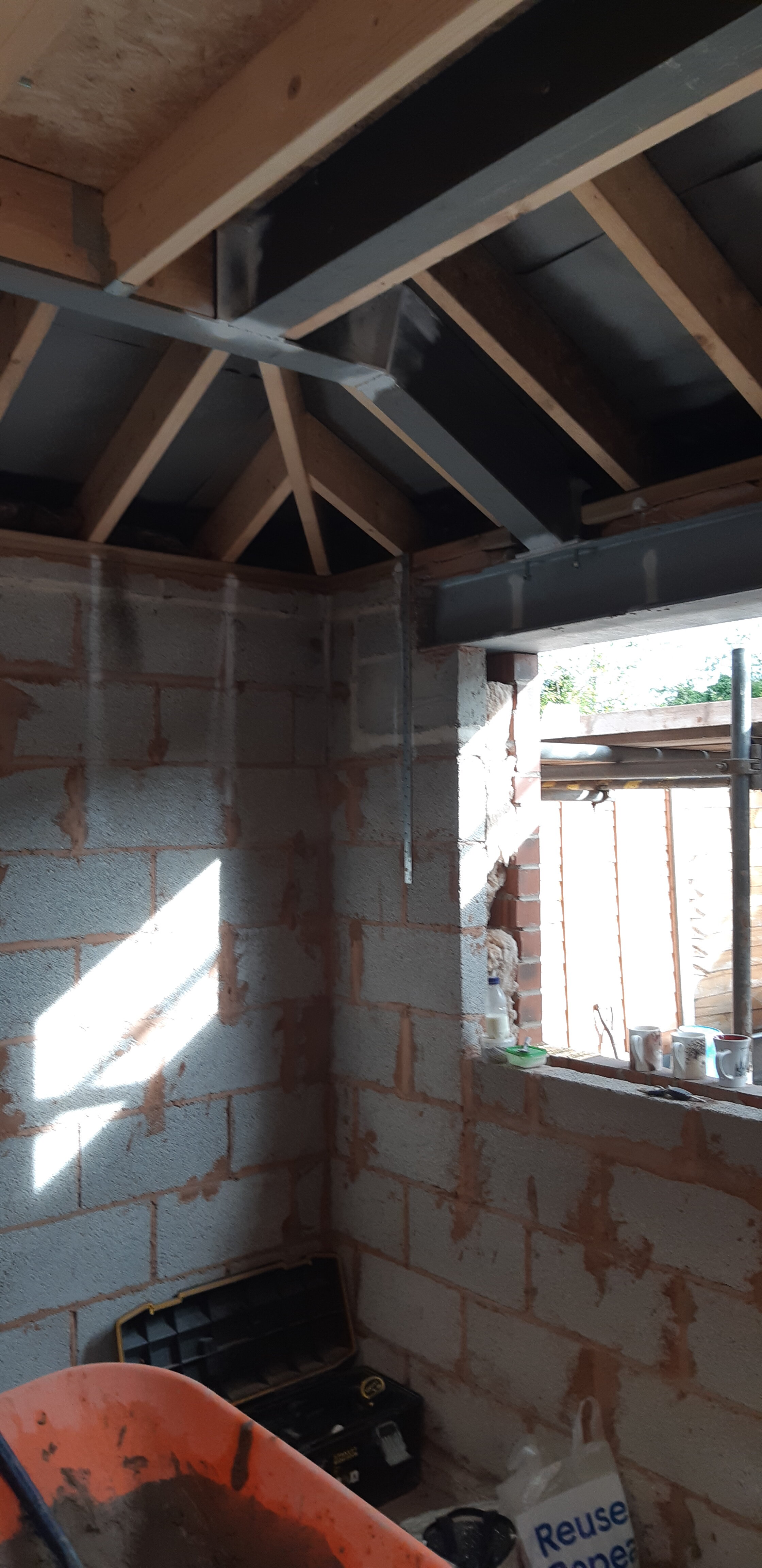

Not clear where the beam that you're referring to is or what its supporting - can you post a picture?
Beam is supporting a new pitched/vaulted roof/ceiling.
Extension to the rear of a bungalow.
One side the beam sits on a internal cavity wall.
The other side sits on a internal wall.
On top of the beam Aris rail have been installed and roof tiles on top.

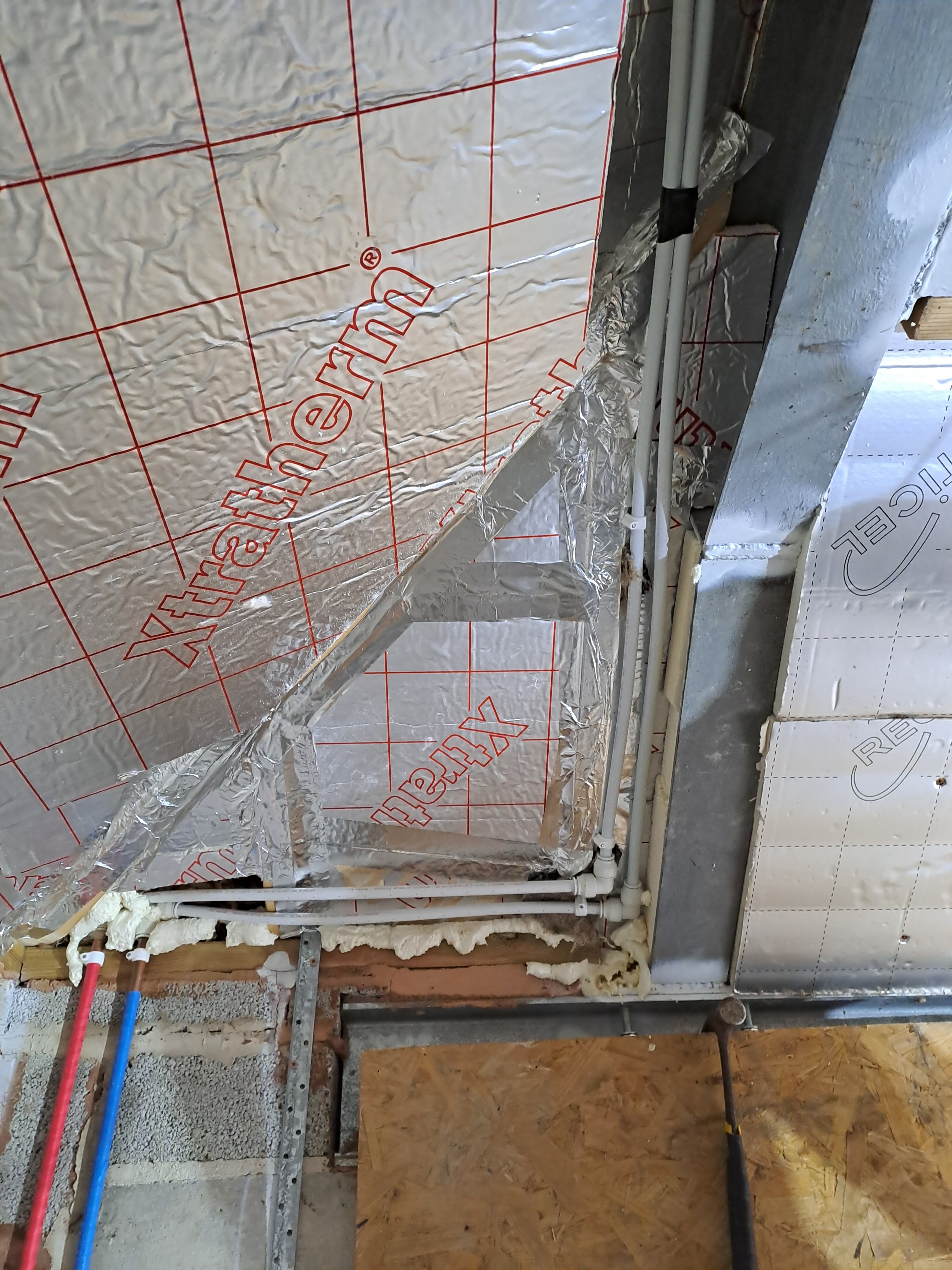

We had similar concerns with a recent extension along with a cranked beam that was deeper then the rafters it was positioned alongside....
If you look at the bottom image you will see I have done all I can to surround it with insulation, even though there is no room beneath. We managed to get some 25mm insulation above and between the roof tile battens. We also glued a piece of DPC to the underside of the beam and draped it down the wall a wee bit. Everything was foil taped or foamed to within an inch of its life.
