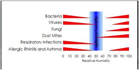

A final point, mould needs a RH of between 65% to 100% to survive and grow. If the long-term RH is kept below 65% mould will not form or grow.
This diagram explains it:
(http://www.aboutdehumidifiers.co.uk/optimum-humidity.html

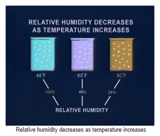

A change of about 10°C doubles or halves the RH.
The warm entering at the bottom may be at about 20 - 25°C at about 45 -75% RH. It has the ability to absorb more moisture, especially from the fabric of the building ( the chimney) which may have a high moisture content.
The warm'ish air with a high RH is then ventilated out the top of the chimney, carrying with it any excess moisture that it has accumulated.
