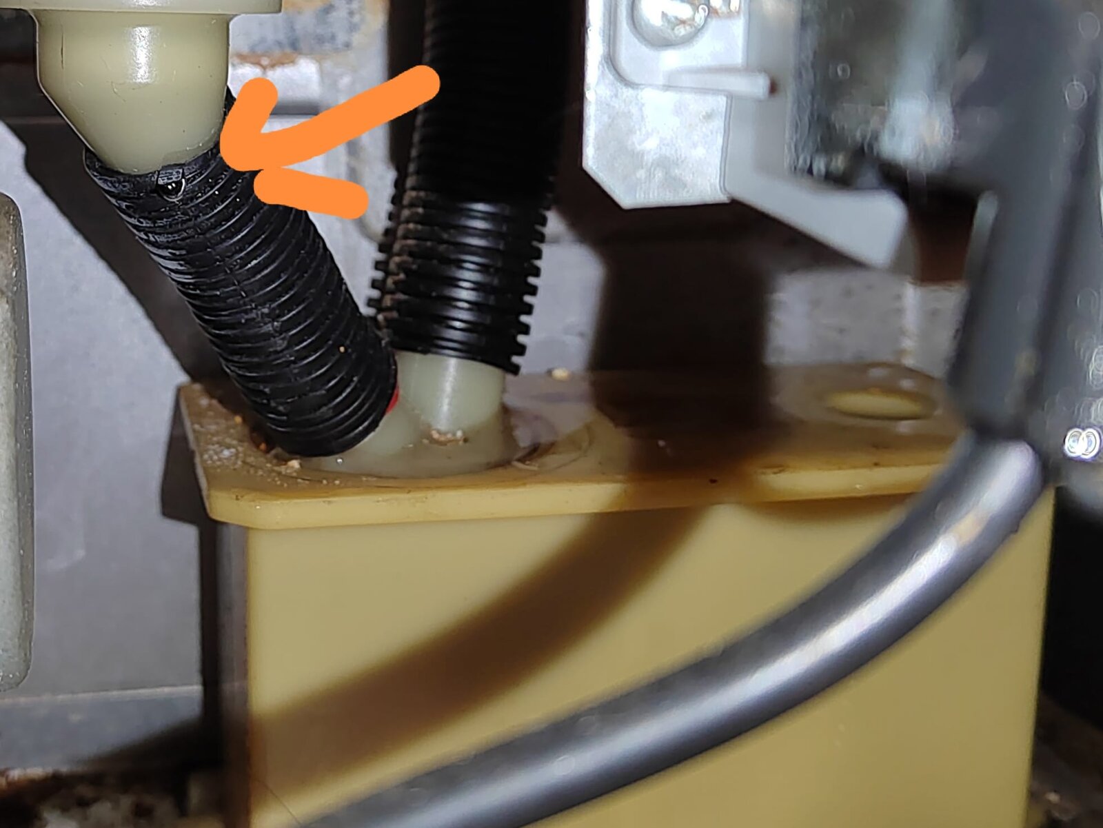

I noticed a pool of water on the worktop recently and assumed it was jus spilled from the kettle (the boiler is fitted nearby). I also remember this happened a couple of years ago and again at the time, it wasn't a huge amount of water so just assumed my wife has spilled water when filling the kettle etc.
This got worse last night and I finally noticed water dripping from the underside of the boiler.
I opened the unit but haven't touched anything, I did see that the water is dripping from the pipe attached to the siphon adapter and sitting on top of the condense trap. Is there anything I can safely try before calling a plumber?
The drain pipe runs in to the wall but doesn't come out the other side. I did read that if the drain was blocked the boiler would switch off (this has not happened).
Thanks.

It's is unlikely to fault to F4 whlie the the condensate hoses are leaking. Best you get it sorted.

Could be that the drain is blocked so backing up. Or that the condy trap is blocked and backing up.
The leak seems to be enough to not back up into the boiler and lock it out.
Or, it's just a worn out hose connection.
Finally got hold of someone who luckily was doing a job on the next road, he's been in and removed the old siphon trap which was full of sludge but also 1 of the pipes was split. He's ordering a new one and coming back.

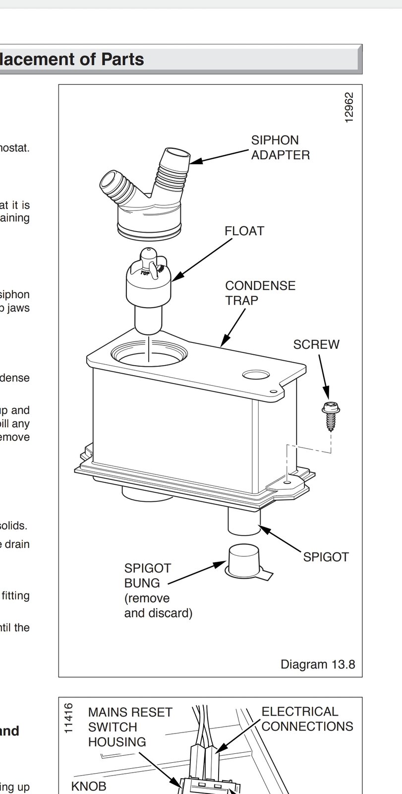

Weirdly though, he said the float was missing. Has anyone seen that before?
Supposedly according to the manual? (pic attached)

Yep indeed it has a float!
