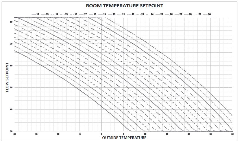

I did some study and I think if found the problem and system is working fine. The installation manual seems to be inheriting many things from older boilers which are not relevant.
This boiler has an automatic pump that keeps the “flow” constant. All information available online and the installation manual talk about a specific temperature drop over radiators. This is only applied to systems with constant head pumps. I.e. those that you set the speed. if we use an analogy to electric circuit, to have constant flow (current) on each radiator, you have to adjust the pressure drop (resistance) when we have constant supply pressure(voltage). Since the heat is proportional to amount of hot water that passes per time unit (flow) we can use temperature drop to measure it relative to other rads.
The pump in my boiler maintains a constant flow (current) automatically. That’s why even if I almost shut all valves, it will ramp up the speed and pressure to maintain the flow. Therefore regardless of valve position, the same amount of flow passes and temperature drop would be the same. Of course this until pump reaches its max limit that is not logical to run it at that all the time.
How the flow is decided? My boiler has a weather competition outdoor sensor that is simple 10k NTC. It also has a “room temperature knob” that according to manual it should set the desired room temperature. It doesn’t explains but what it means is that you could scrap the room thermostat and let the system control everything. It will use delta T between flow and return at boiler to figure out actual room temp instead of a wall sensor and it uses outdoor sensor to predict room temp easier. Think of it as a built-in opentherm thermostat. Then you could use TRV for each individual room. You probably have to over design the system to achieve it.

My boiler uses outside temperature and set point at knob to decide about the flow. It also sets the output and return temps to define system output. When I first attempted the balancing, outside was around 3’C and I had knob at 25’C. Using the graph below, it was running at around 70% of its max flow. I thought if I have system balance at highest flow (70%), it will not cope with lower flow rates. I decided to balance it at 30%. I had two ways, drop the knob to 11’C that at 5’c outside will have pump running at 32%. It worked but the burner didn’t kick in because return was 20’C. I found that at 20’C outside, sensor resistance should be 12.5kohm. Replaced the sensor with a 12.5kohm resistor and set the knob to 22’C. Even with low flow, I didn’t need a 20’C drop as explained above, instead , I adjusted the lockshield valves to have the same flow temperature at the inlet of each radiator. This was normally around 2-3’C below boiler output. Interestingly, at the very same position the noise at lockshields were eliminated. Reconnected the outdoor sensor. Set the knob to near max. Had the system run for couple of hours and I noticed the boiler is doing its job. Sometimes on the same radiator delta T was about 20’C and sometimes 2’C. Also the burner is not on all the time when pump is working. I guess unlike normal condensing boiler, a combi would benefit from the exhaust gases at any temperature due to very high flow, high efficiency heat exchangers and because of its control on burner output power, it doesn’t need 20’C, it will drop gas flow until there is enough exhaust heat to be absorbed by return water. I check the flue gasses regularly and there is no fog coming out anymore.
now rooms heat up more uniformly and it can reach temperatures I want. In the past, even if I set room thermostat at 27’C, so long as the knob was set to 22’C it would never reach 27. Because system automatically reduce the output power to minimum when return temp suggests room is at 22’C. Room stat is nothing more than a timer when the knob is not set at max.

for this particular one, I got it from following document. Quote:
The On and Off time control of central heating should be controlled by a separate timer.
During programmed On times the Central Heating Radiator Flow Temperature is controlled by the boiler relative to the Outside Temperature as shown in the diagram.
The Room temperature can be adjusted using the Central Heating Temperature Control Knob on the boiler as follows. Essentially rotating the knob clockwise increases the room temperature and rotating the knob anti-clockwise decreases the room temperature.
The Room Temperature Setpoint in the associated graph is not directly related to the Actual Room Temperature but is the Nominal Room Temperature during a programmed CH period.
This can be adjusted between 5 and 30 degrees by the CH Potentiometer Knob on the Boiler when the Outside Temperature Sensor is connected. The graph only shows temperatures between 12 and 30 degrees for clarity.
Example:
1. If the CH Potentiometer Knob is set to display 22oC on the Boiler Display the Room Temperature Setpoint will be 22oC and the curve 22 will be followed, indicated by 11th curve in from the left hand side.
So as the outside temperature varies the Flow Setpoint to the CH circuit will increase and decrease proportionally.
2. If the CH Potentiometer Knob is rotated fully clockwise, the Boiler Display will read 30oC and the Room Temperature Setpoint will be 30oC hence the curve 30 will be followed.
3. If the CH Potentiometer Knob is rotated fully anticlockwise, the Boiler Display will read 5oC and the Room Temperature Setpoint will be 5oC. This is an unrealistic Room Temperature Setpoint for a CH period during an ON time, but it is calculated internally for managing Frost Protection for the system based upon Outside Temperature.”
