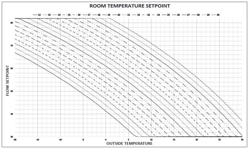

Also, check the pump. Make sure its working in the correct mode if is variable speed. With an ABV, it has to be fixed speed. You could use variable speed but then you need to lock out the ABV and then open up those lockshield valves again.
The problem is user manual does not say anything special. not even pump head vs flow. I can see on utube a new version have all settings I am after on the display. mine doesn't have that. however, I found something interesting just a moment ago. mine has a weather compensations sensor and I am not sure how it is wired to my boiler but it seems when that is installed, pump flow is corrected based on the difference between thermostat setpoint and outdoor temperature. I had a room thermostat set to 27 and outside was around 2-3'C. my impression was my thermostat do not talk to the boiler. Opentherm port is not connected to anything. maybe flow was high due to cold weather and it didn't meant to achieve 20'C drop?
That's right plus I am sure there is one auto bypass inside the boiler. the external one is just in case both zone valves are closed and to protect the internal one I guess.
