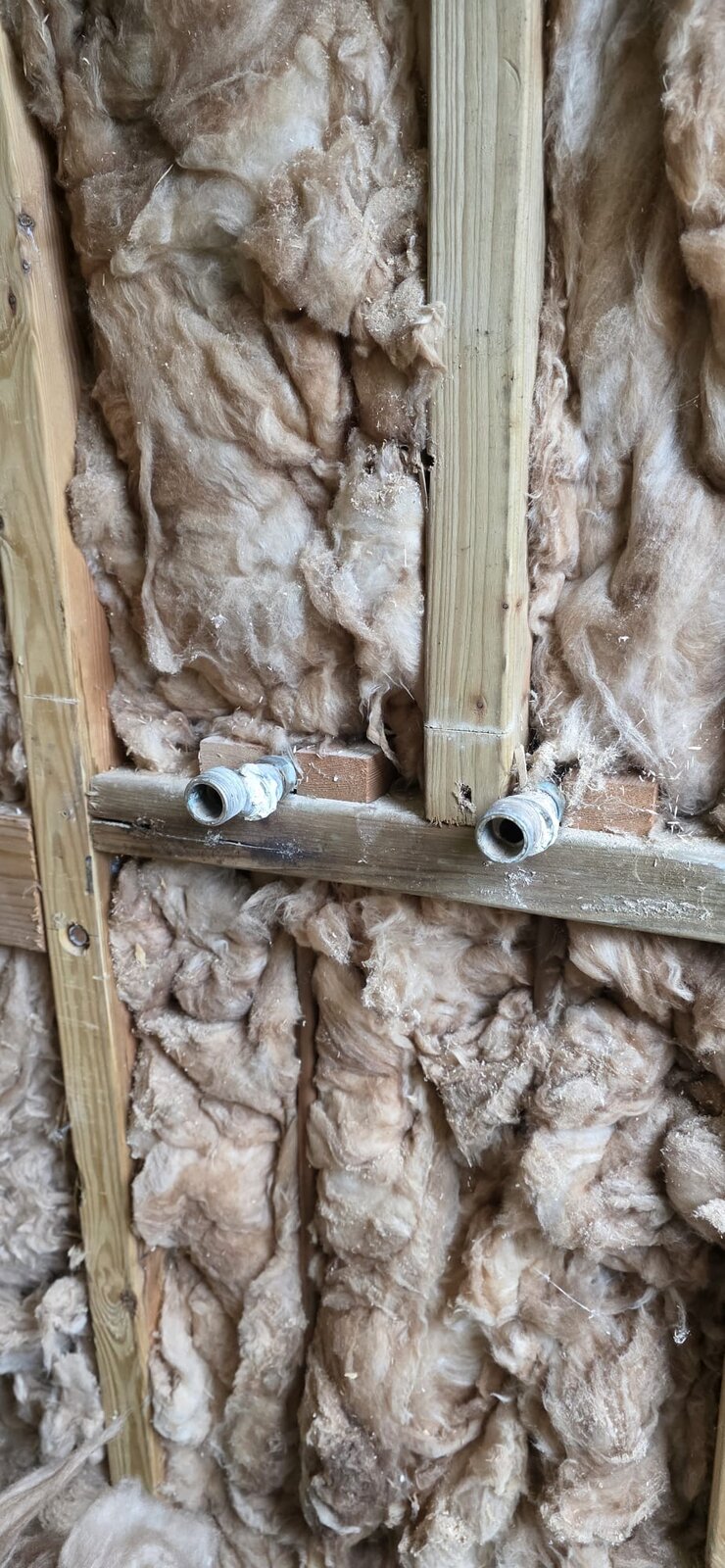

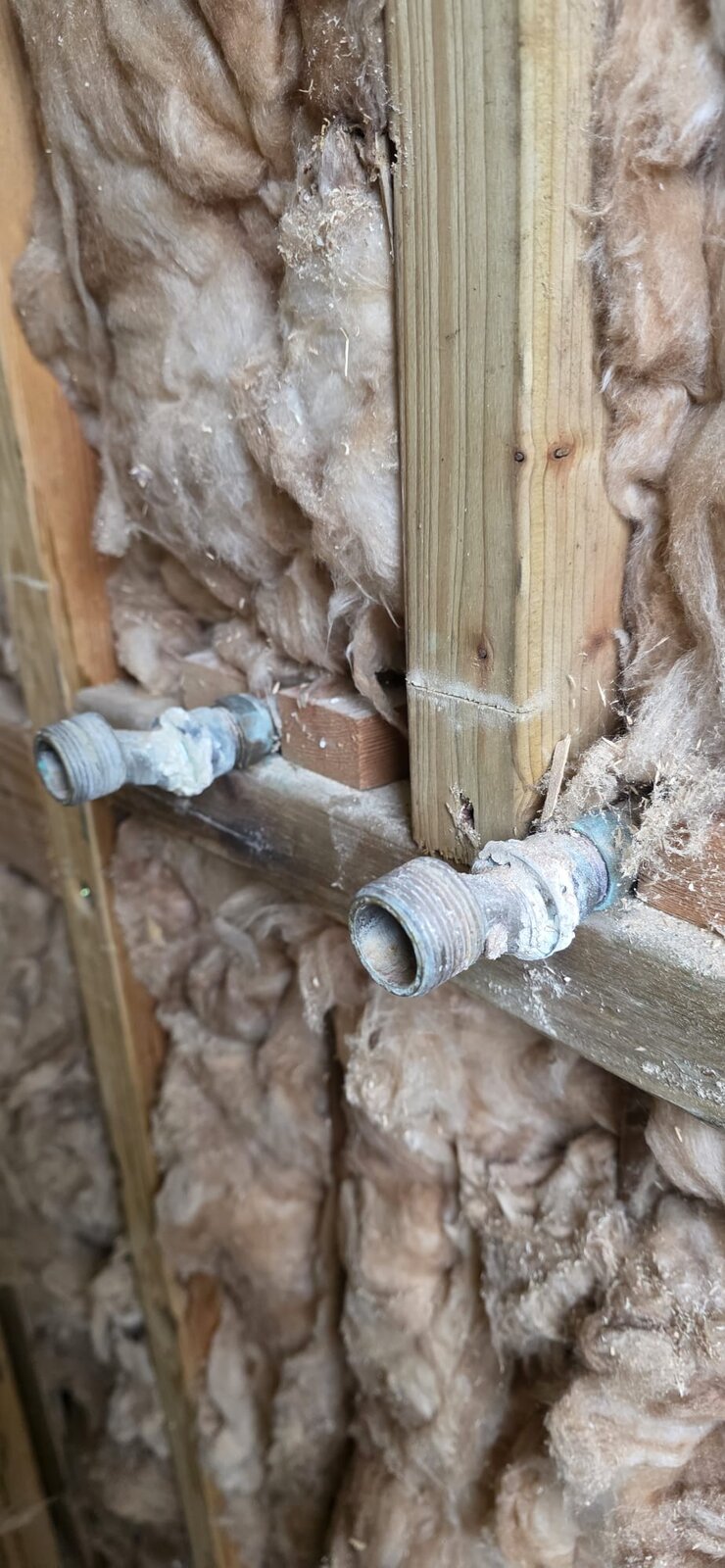

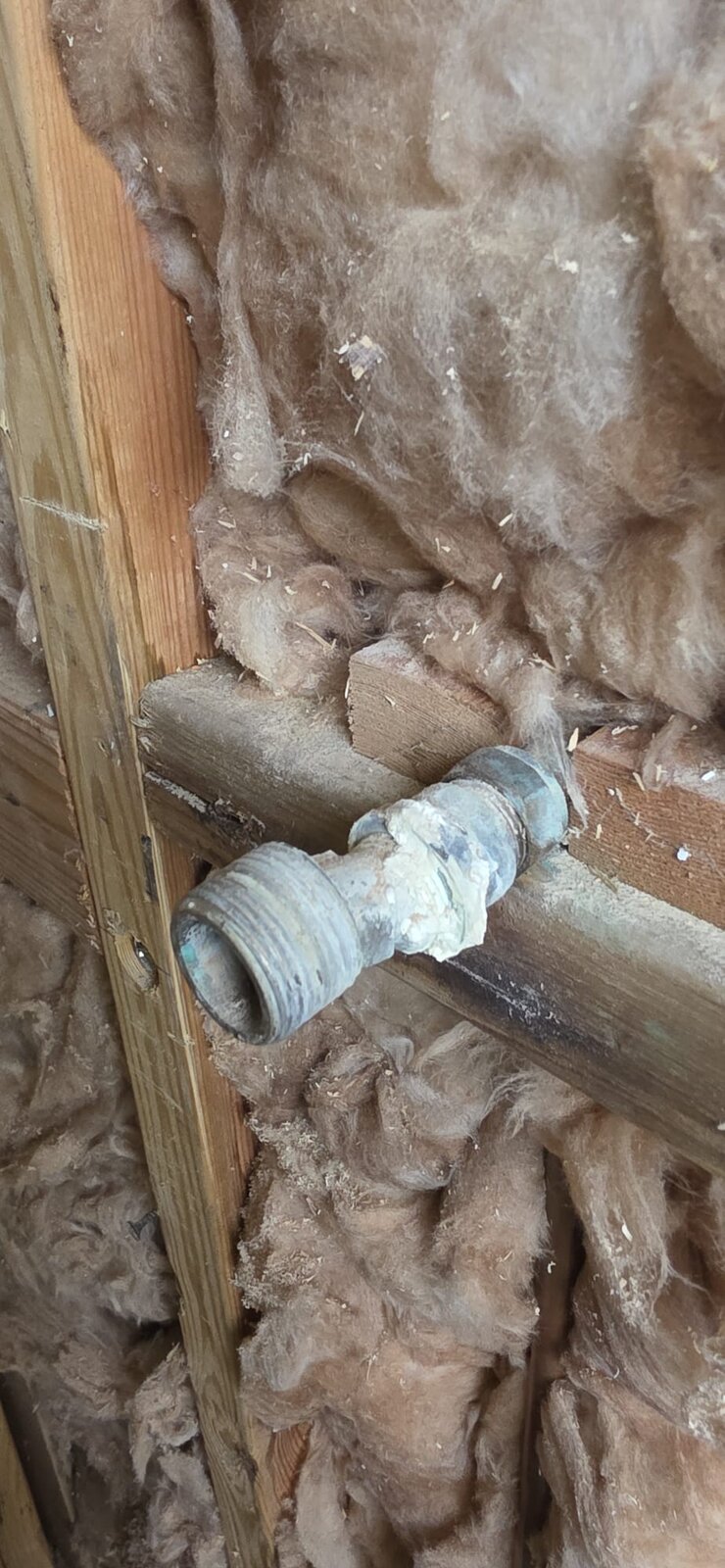

One last question, I have the hot and cold shower tails sticking out to add more aggro to this one. Looking at the videos for installing these (panels) they seem to be shifted over sideways and into the corner, this is going to be difficult with these in place. On mine it looks like there are extenders added to change the thread size, how does one get around this? Make the holes bigger?
Here are some photos, they stick out about 70mm

I've always used tile adhesive for the tape on aquapanel joints and my showers last 30+ years.
For the holes, you need to cut 30mm holes and slide the tiles in.
Again, you can use a tick cardboard to make a template or if you're good with tape measure, just...measure.
From what I can see, and I will need to measure this, the holes for the pipes need to be the diameter plus 4-6mm. I am guessing that this is likely to hopefully give enough lateral movement to push the panel into the corner part?
