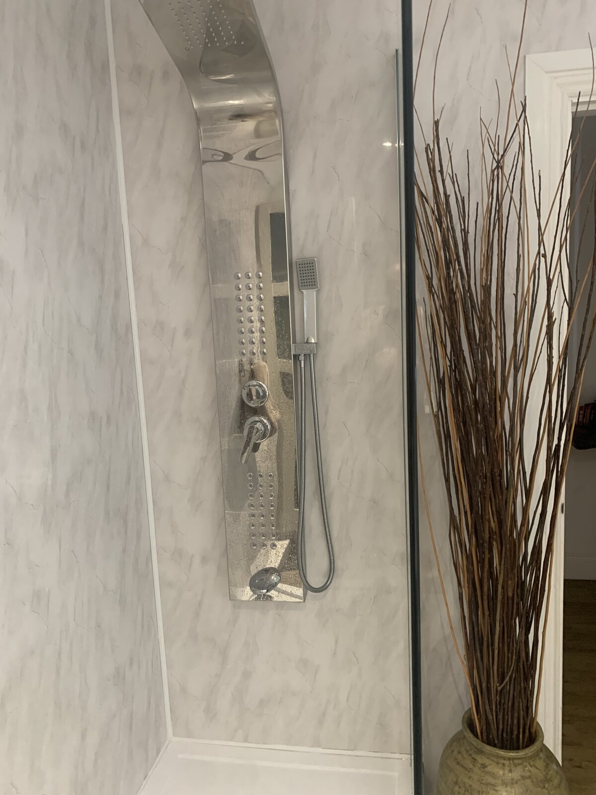

You don’t need aqua panel behind shower panels unless using the very thin 4-6mm panels .
My shower unit uses flexi hose connection so install was easy .
Just connect and hang on brackets.
