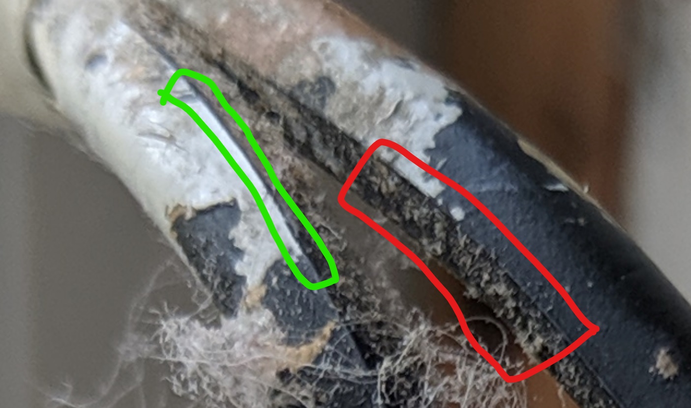

Picture of the mess.
Yowser, that does indeed look like Dropwire 8, the thickest one, which is the one I said should never be used with jelly crimps!! :mad::eek:
Anyway, you see this ridge along one of them, circled in green...
That is how you can tell which wire is which, seeing as they are both black. Don't be confused by what I've circled in red, that's just the remnants from the figure 8 being separated, they both have that, it's the extra ridge you are looking for, so you know that wire connects to white/blue.
