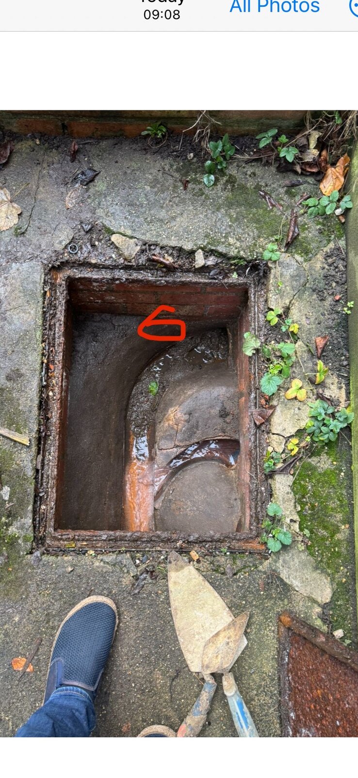

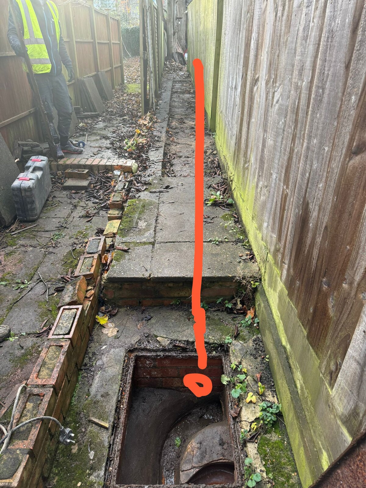

Hi there,
I’m feeling a bit stuck and not sure my plumber has the answer either. Hoping someone with experience dealing with Thames Water sewers can help!
I’m looking to connect a PVC pipe to an existing manhole with clay pipes. The new pipe will run in a straight line along a trench in an alley, in the direction of the flow.
My plumber suggests connecting the new pipe at the point marked by the red circle. However, I’m unsure if we can match the soffit levels of the existing clay pipework. Would this be a problem?
Unfortunately, Thames Water is taking forever to respond, and we need a solution quickly Any advice or experience would be hugely appreciated!
Thank you
G.

Years ago in our old house, we just had a PVC pipe from our downstairs bathroom just dropping into the trough in the same position as shown in red in your photo. Didn’t come from a long run like you propose though.
That seems shallow. Also be careful, with the presence of soil, could be surface water only drainage system. You may need to add another inspection chamber/manhole for the change of direction too.
Thank you! It’s most definitely not surface.
Our plumber have installed this.. does it look ok? Or should we ask to make a diagonal cut at least?
