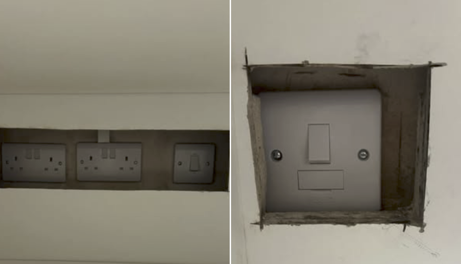

Internet find - not my kitchen:
If the cabinet has a drawer.
Yes, of course. I was obviously thinking about the traditional kitchen units which, unless they house an appliance, usually have at least one drawer at the top, if not several.

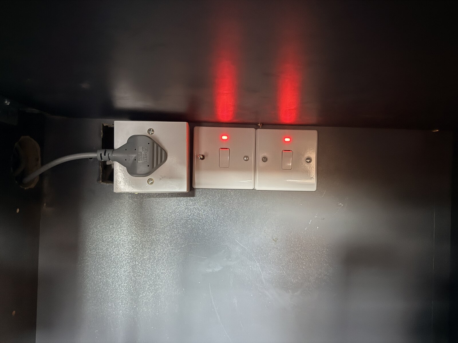

I have a tower with a combination oven and a conventional oven. They can’t be powered from a conventional plug so I have two separate 20A double pole switches, one for each oven. Next to the ovens I have a built in fridge freezer. That is powered by a 13A plug. I have fitted the two flush fitting DP switches and a single socket, up high on the back board of the pan drawer underneath the cookers. Easily accessible by removing the drawer.
For my induction hob, I have fitted a cooker switch at the top rear of the adjacent base unit, again, easily accessible by removing the drawer - no tools needed to remove the drawers, they just pull out and lift up. For the built in dishwasher, the waste, power socket and water connections are in the corner void of the kitchen base units and that will require a cupboard door to be removed to access some screws to remove an infill panel. That will be a bit of aggro but it’s not like you remove a dishwasher every week! I couldn’t think of an easier way to do it though.
