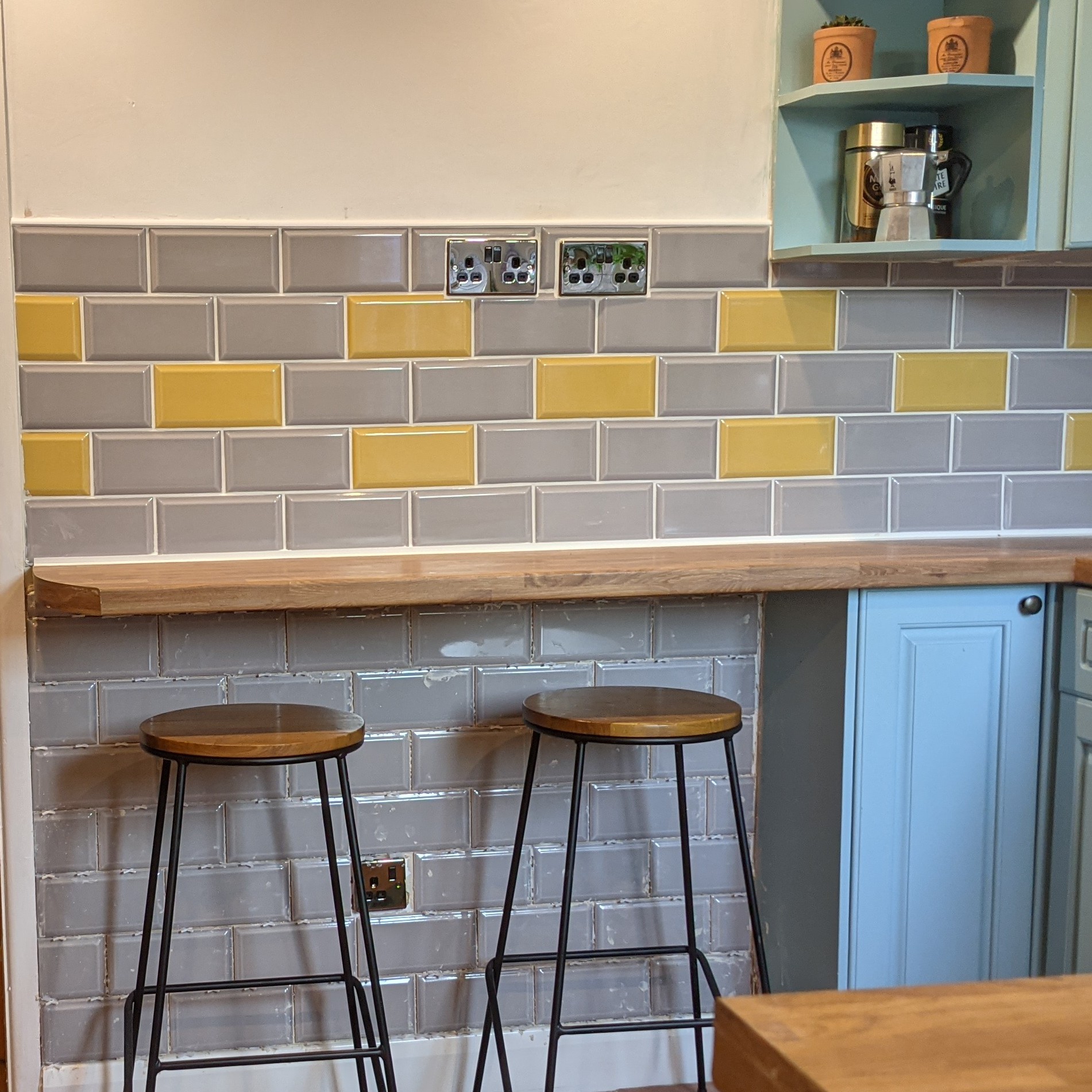

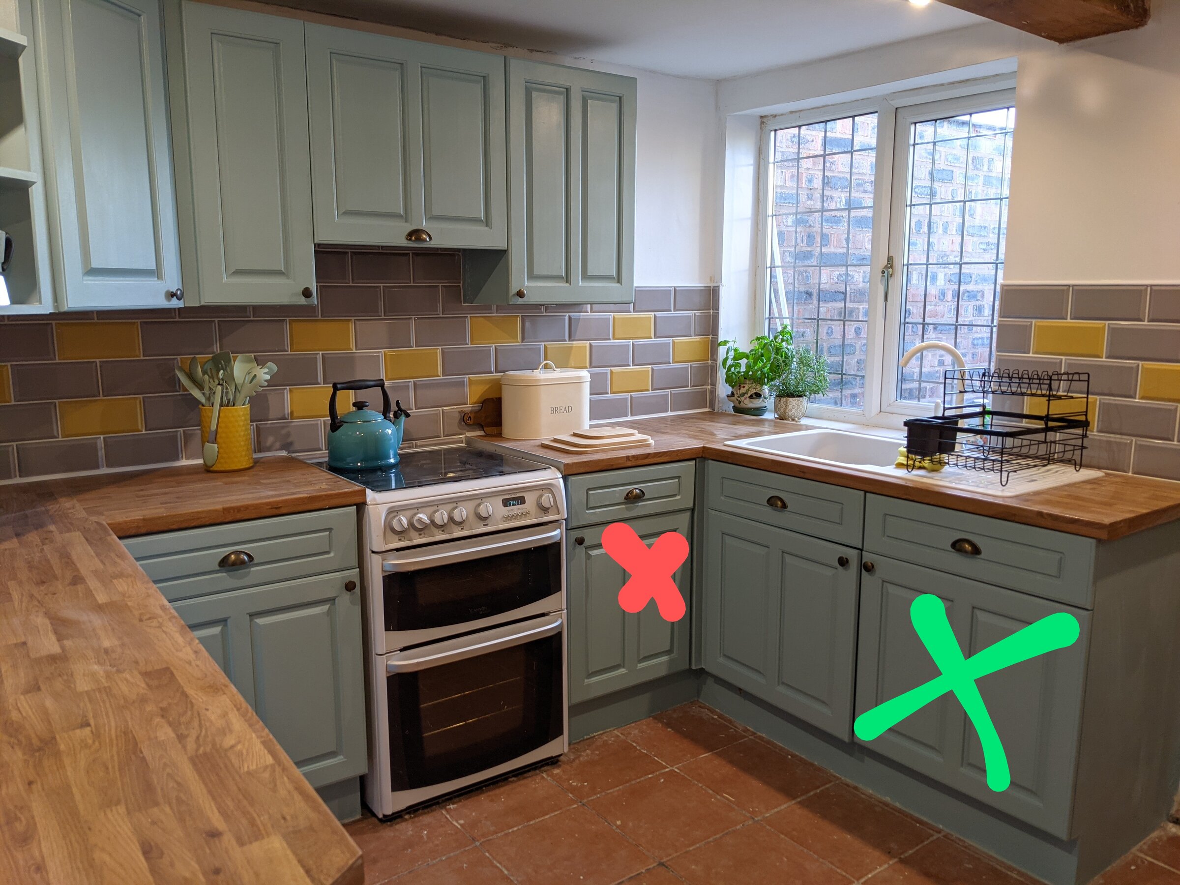

Just bought a new, fancy under-the-counter fridge to go in the kitchen. The issue I have is that the house is 150+ years old so, the electrical installation is 'interesting', to say the least. There are no outlets on the side of the kitchen where the fridge will be going aside from the outlet for the cooker which is on its own circuit but, there 2 sockets right next to one another with a spur for a single socket just below - on the complete opposite side of the room to where the fridge is going.
The cooker is gas so only draws power for the lights and sparkers, and whilst the installation is questionable in its design, it is protected by a brand new consumer unit and has been re-wired in the last 10 years.
My question is: can I spur off that cooker socket (I know it's a radial circuit so maybe it's not that simple), or can I put an extension socket onto it and connect both appliances? Seeing as the gas cooker will draw little to no power at any given time, I assume it to not be an issue but, I thought I'd ask!
Edited to add picture of all sockets in room and picture of location of cooker socket (red) and where the fridge will be going (green)

Yeah so that is in the overhead cupboard, the one I want to split is the one that has the gas cooker plugged into it, under the counter - connected to the 'cooker' switch in the cupboard.
Still no issue with this, just change the socket under the counter to a twin socket, it's perfectly safe and acceptable.

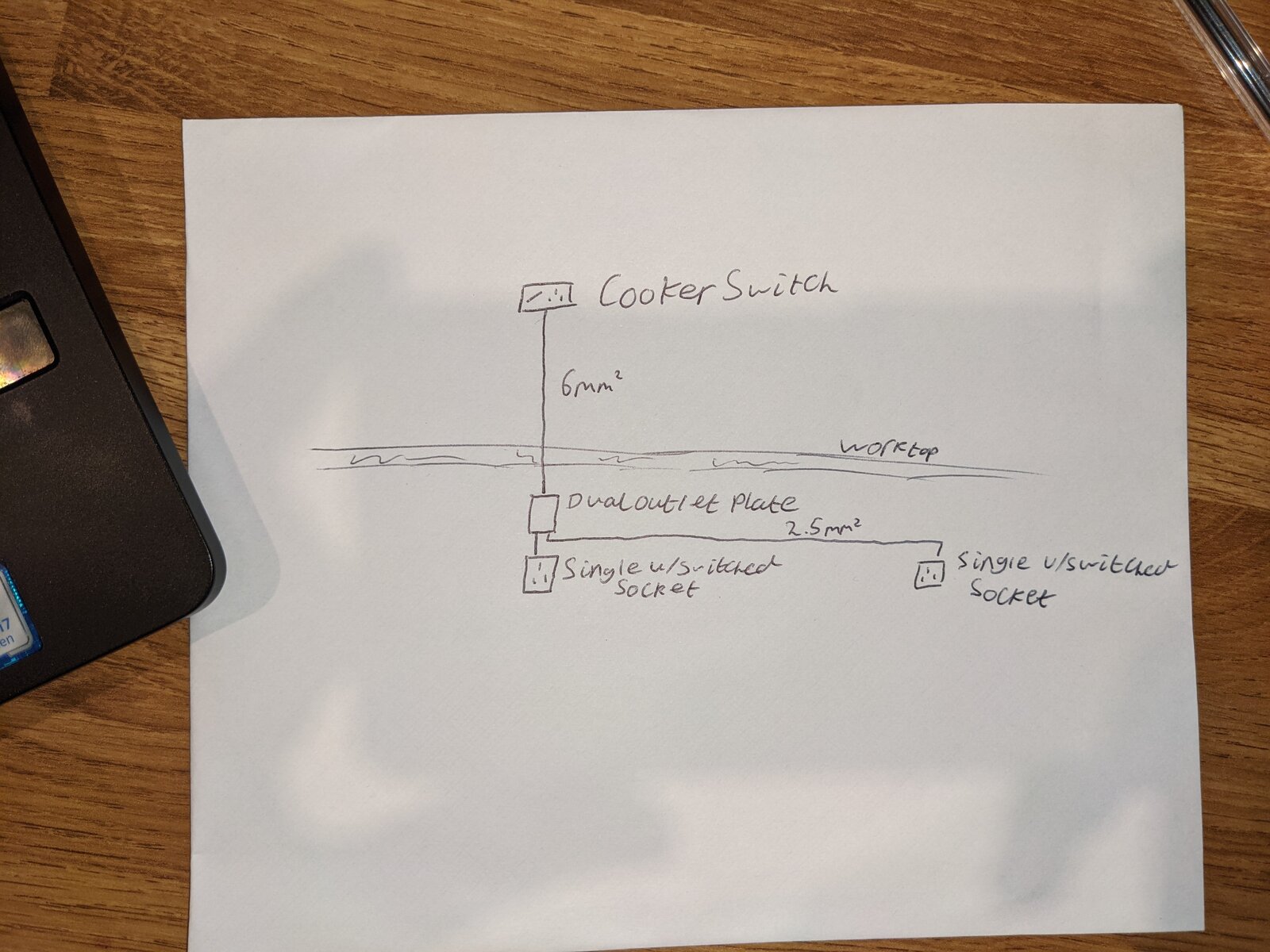

Cheers for the help guys. I've had a look under the counter at the socket again in the cold light of day and I'm thinking the fridge won't reach the current position of the socket without using an extension ( which I don't want to do).
I'm thinking this as a potential alternative (excuse the handwriting). The general gist is to swap the current socket for a dual outlet plate and put an unswitched single socket on each, in surface mount boxes in the cupboards. The second socket would be no more than 2 meters from the outlet plate. Is this safe enough? Any advice would be appreciated!
