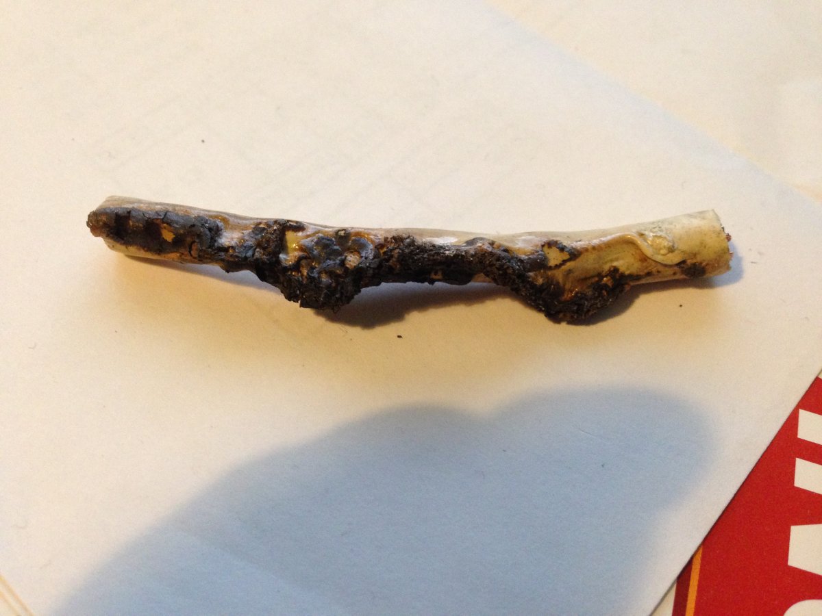

While I was fixing it all yesterday I also found this nice section on the original cable to the boiler he wired in originally! Looks like he melted it while soldering because it was resting up against a joint he did on a copper pipe. It actually had 2 spare cores in it but probably not usable after being incinerated. So maybe he made up the entire story about the wiring not being available.
