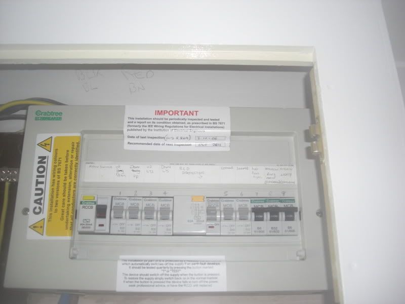

What i have got, is that if i can get a direct feed then 6mm armoured would be great. If i can then a 2.5mm armoured spur from the loft would only supply enough power for the lights after voltage drop.
Out of interest, here's a picture of my Cu:
HaC
Something wrong with that CU - looks like you have 2 RCDs in series, both of the same rating.
If the left RCD with the words 'main switch' written above it is turned off, does this switch off the whole board, or just the 4 MCBs at the left?

The main switch triggers the whole board. Its all ok. It was inspected by a Nappitt engineer in 06, and passed ok. It must be safe as he was Part P.
HaC
The CU probably isn't unsafe, but you have all of the circuits on a single RCD, so a fault anywhere will result in the whole lot going off (and staying off until the fault can be found and fixed)
It also means the second RCD (the middle one) is useless, as it is the same rating as the first one.
Looks as though this was a split load board and someone has replaced the main switch with an RCD for some reason.
No idea, it was like it when we moved in. Inspected by a Nappitt Engineer who said it complied with all standards. Ive had no problem with it all.

Well clearly he didnt look very hard. Its not dangerous, its just not ideal.

It's not ok, it doesn't comply now and didn't then, nappit and elecsa are born out of 'part p' and the necessity to have more 'competent' persons due to part p :roll:
You have had some additional work done there, hence the new MCB's on the right and some numpty that doesn.t understard has changed you main switch for an rcd to 'make it all part p'.
I wonder if the niceic man told you to have RCBO's (which cost more) and the nappit bloke said, change the main switch for an rcd?????
