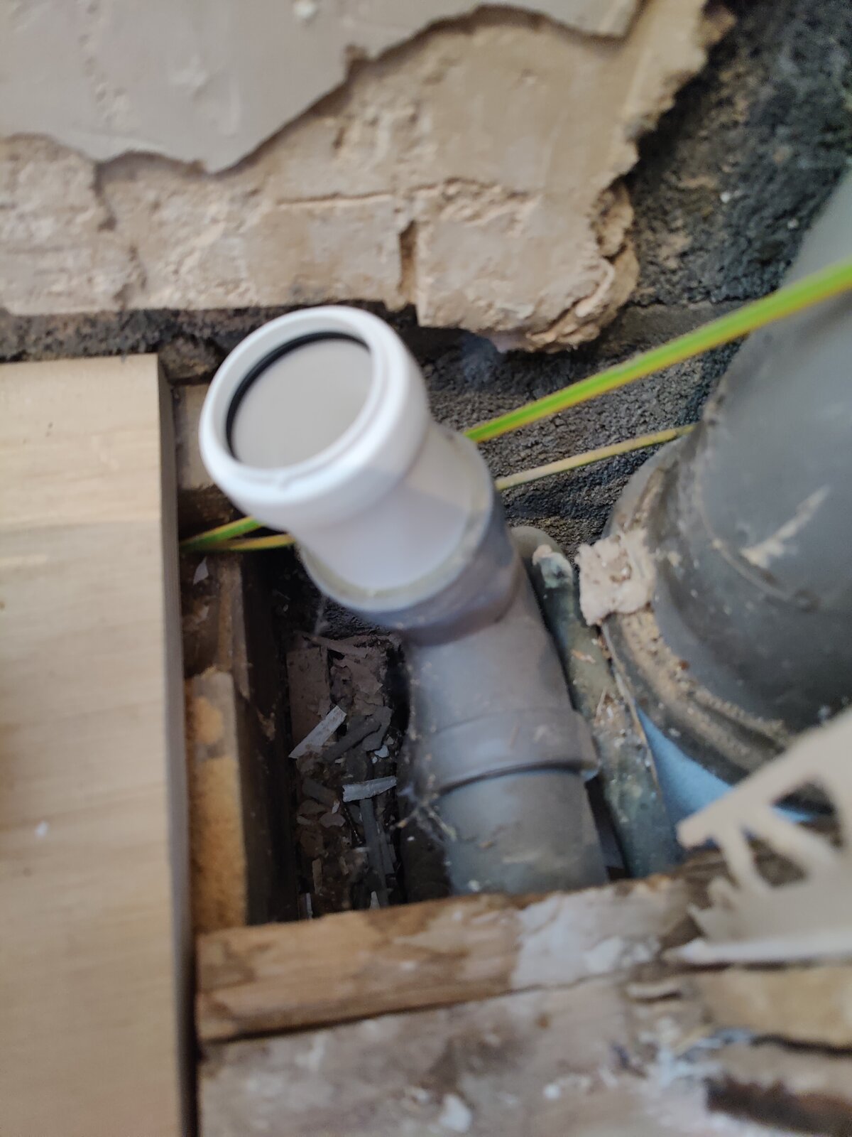

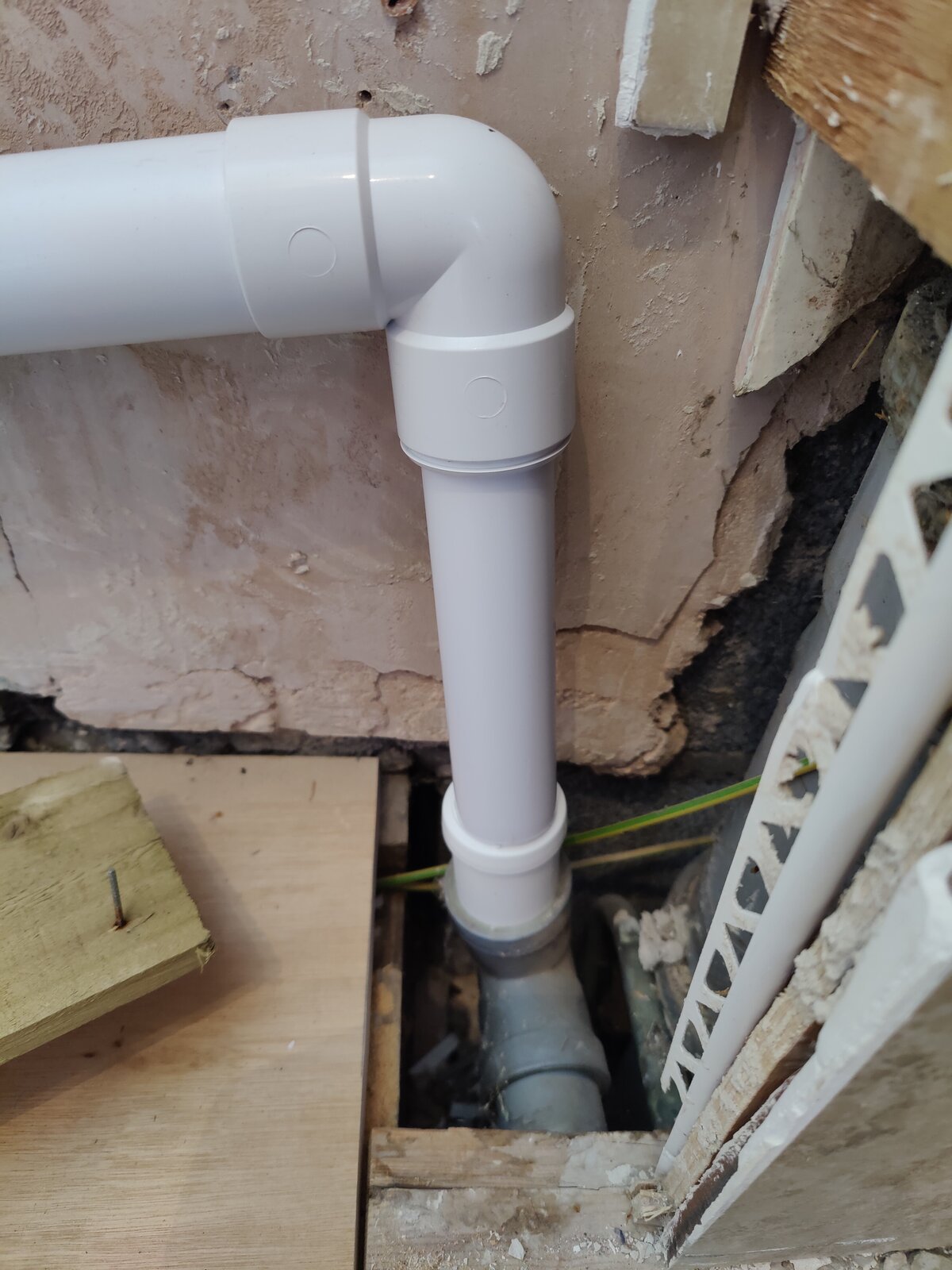

1st photos shows the 43mm solvent weld that's ever so slightly to big.

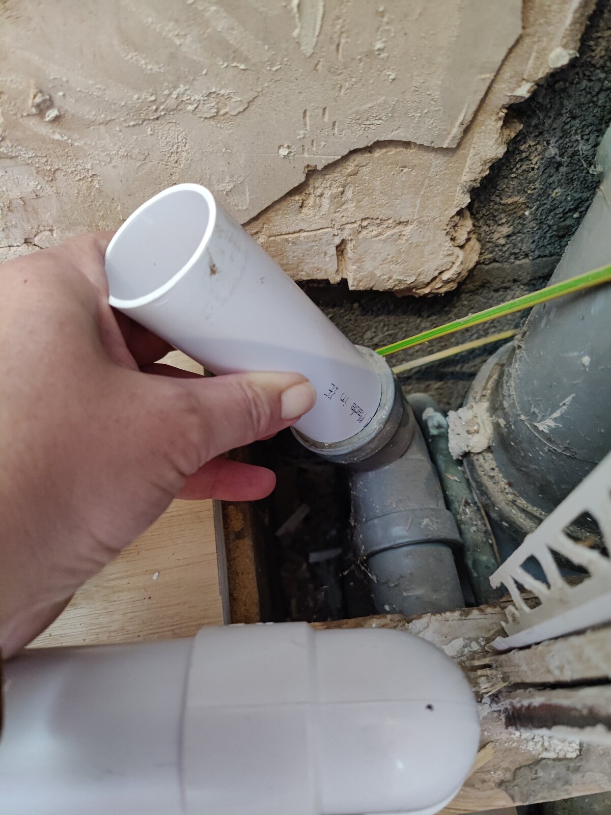

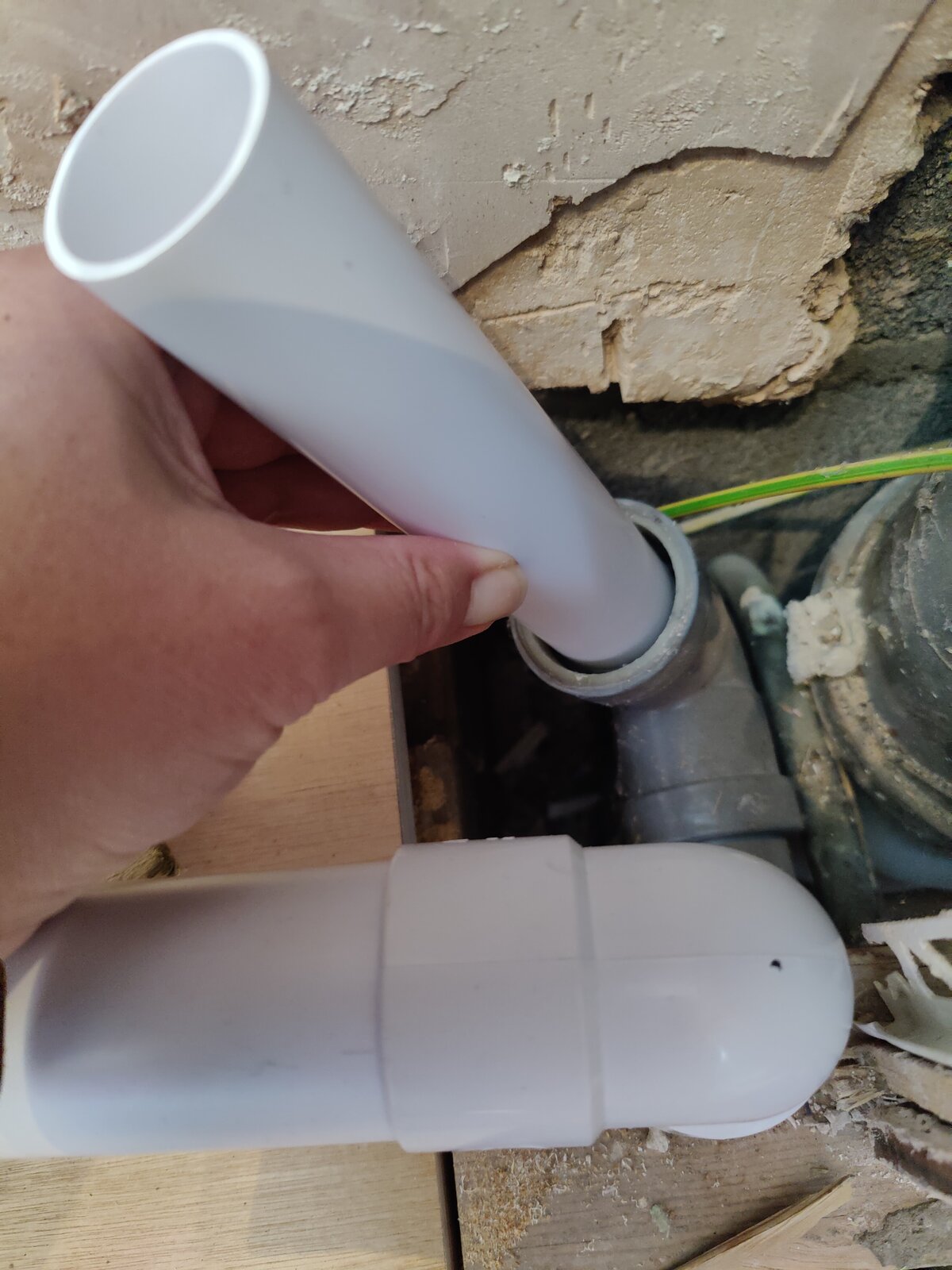

2nd photo shows the 32mm that's to small.

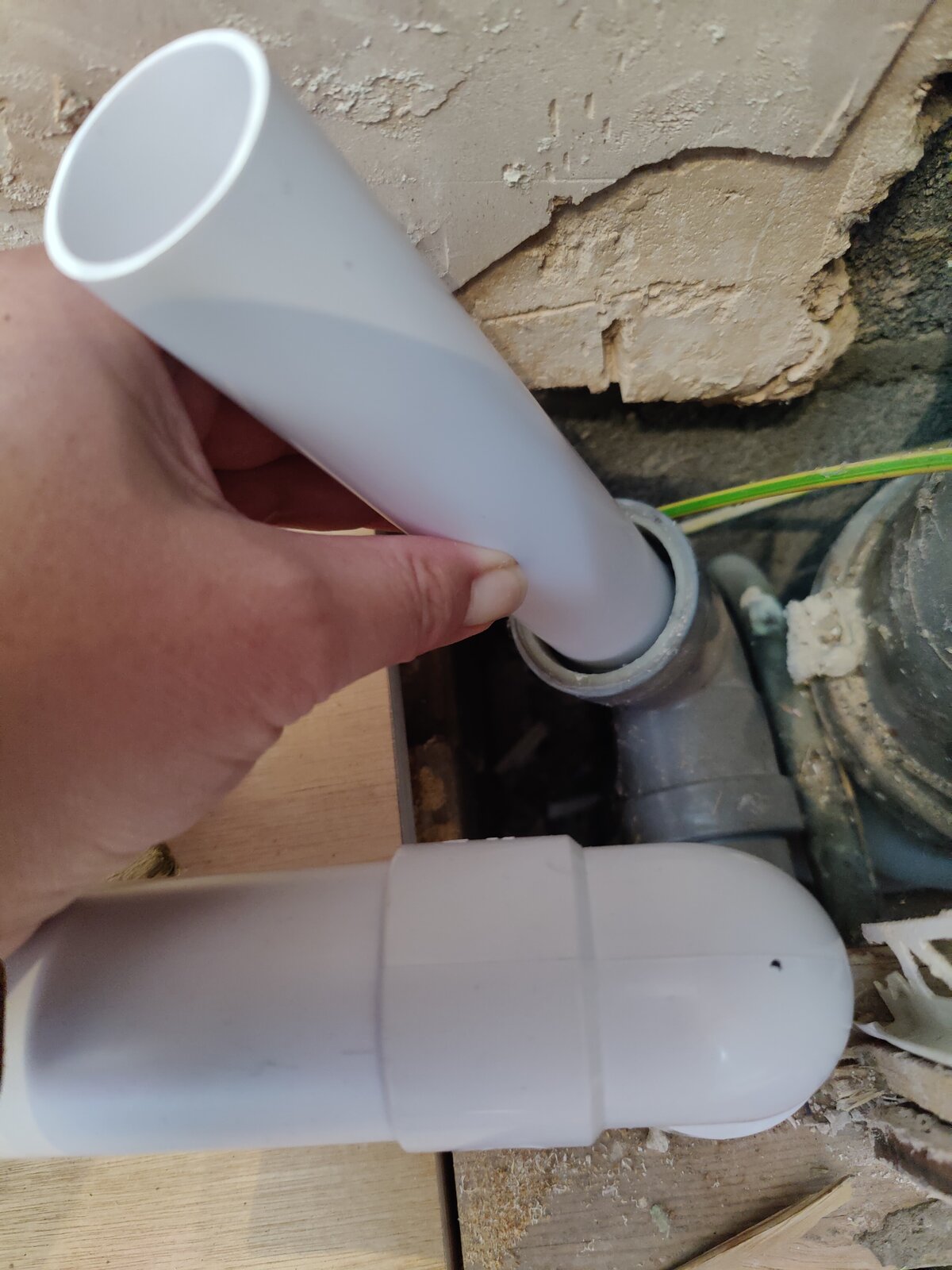

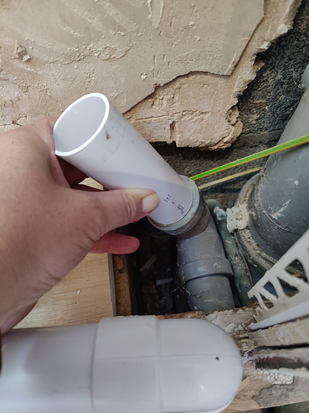

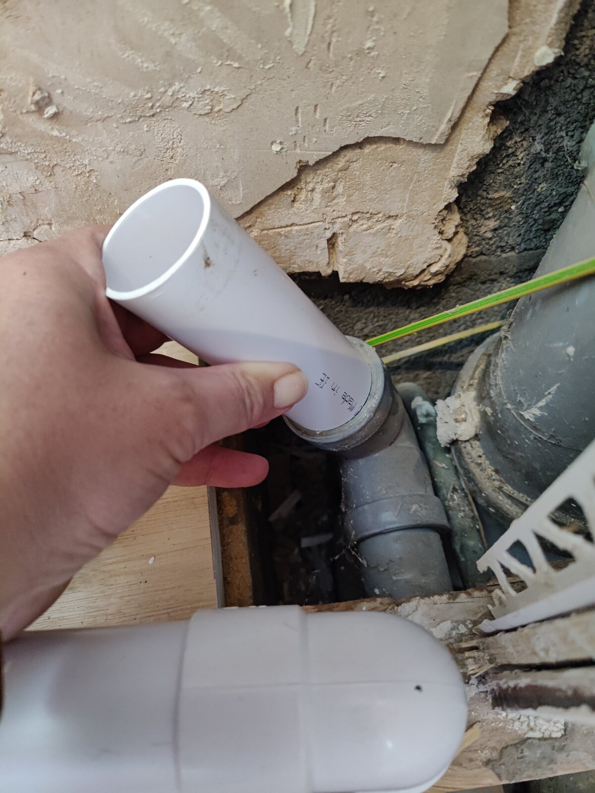

3rd photo shows the 40x32mm reducer that I bought snugly fits in.

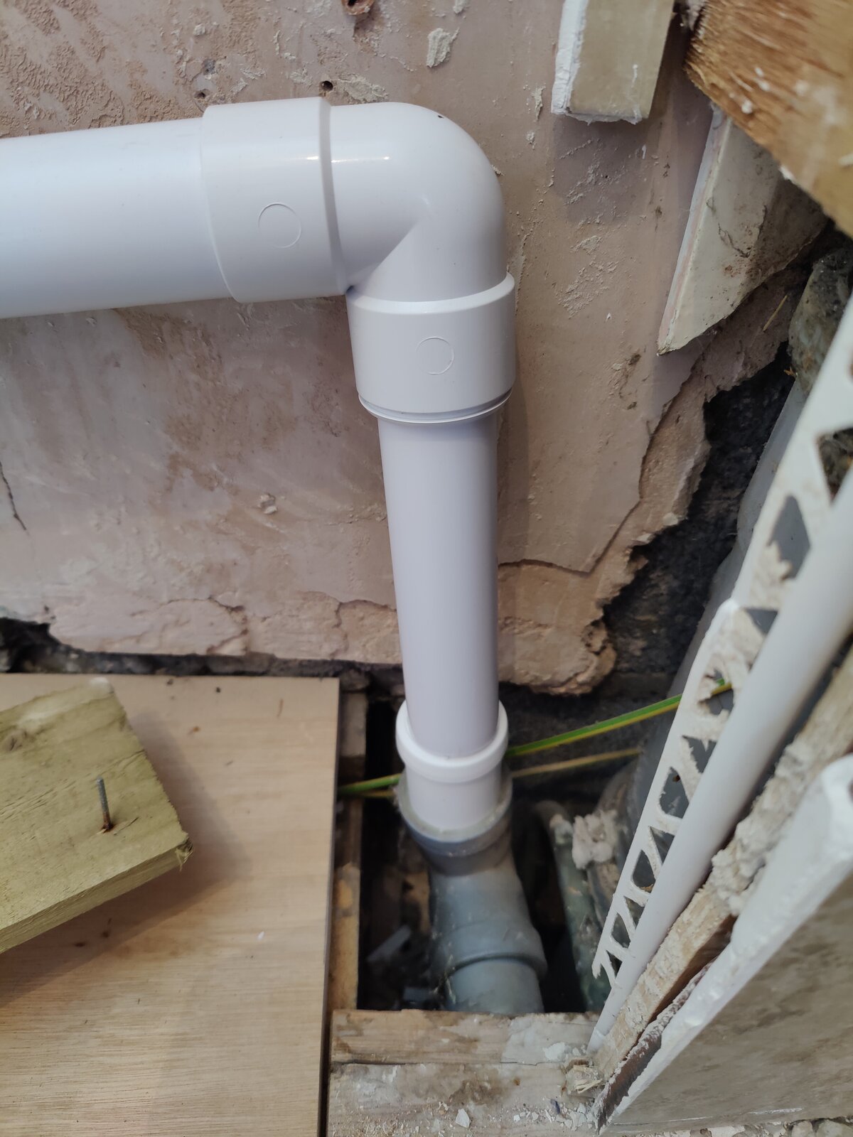

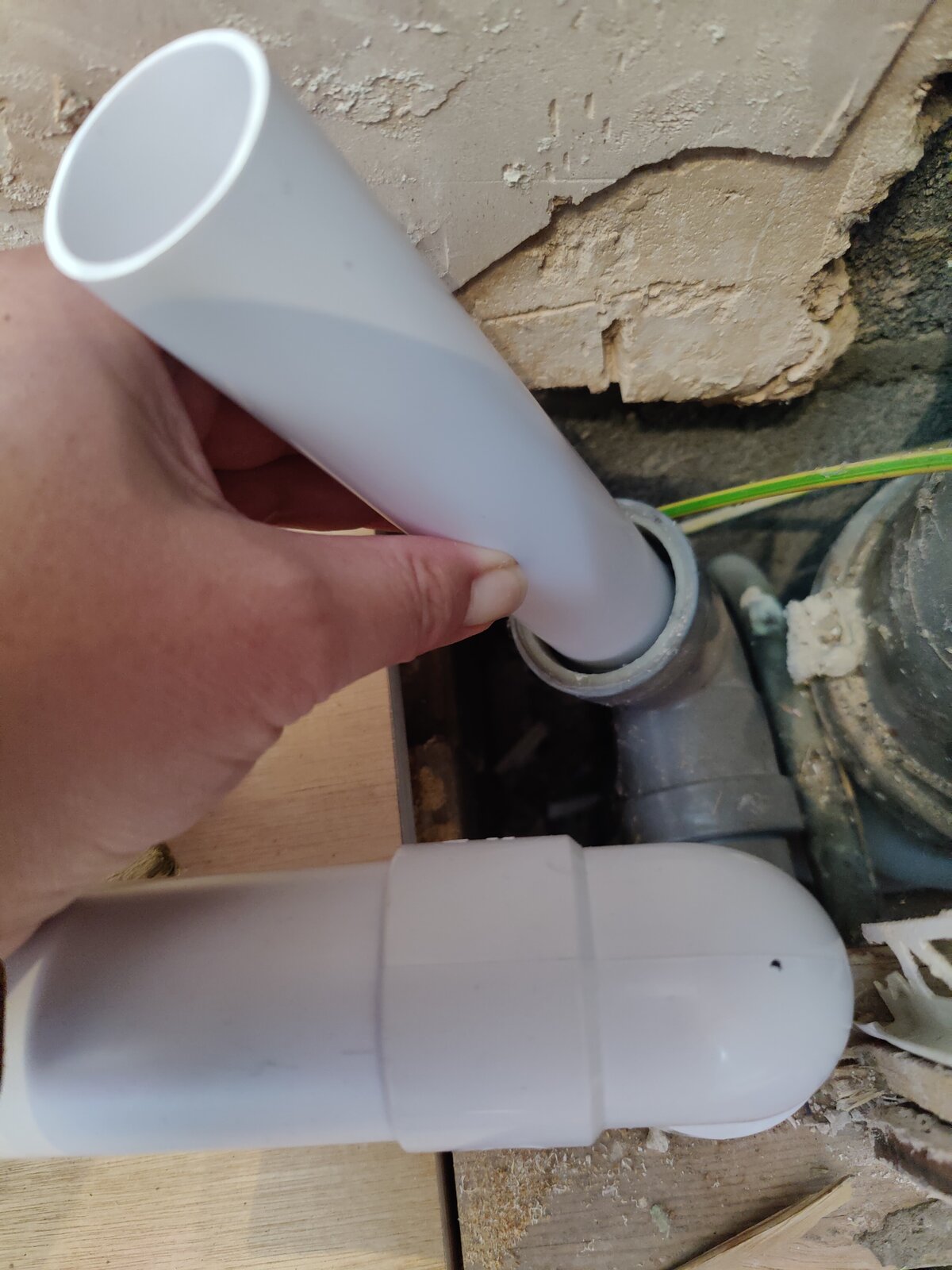

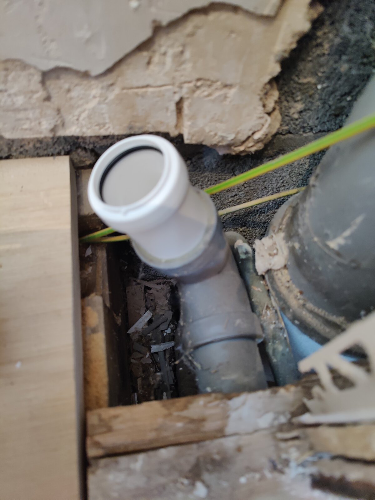

4th photo shows a solvent weld reducer on the 43mm elbow, with the 32mm pipe going down but it's ever so slightly to big to fit into the reducer that's installed into the existing coupler.
So I either need a compression fitting that goes from the 43mm into the existing pipework OR a compression fitting for the 32mm into the existing pipework. It makes sense to find one for the 43 otherwise I'm just adding extra sizes of new pipework and connections unnecessarily.

Doesn’t matter so much about the photos, but the one that fits snuggly is a push fit x push fit, you need push fit to solvent weld or a compression elbow.

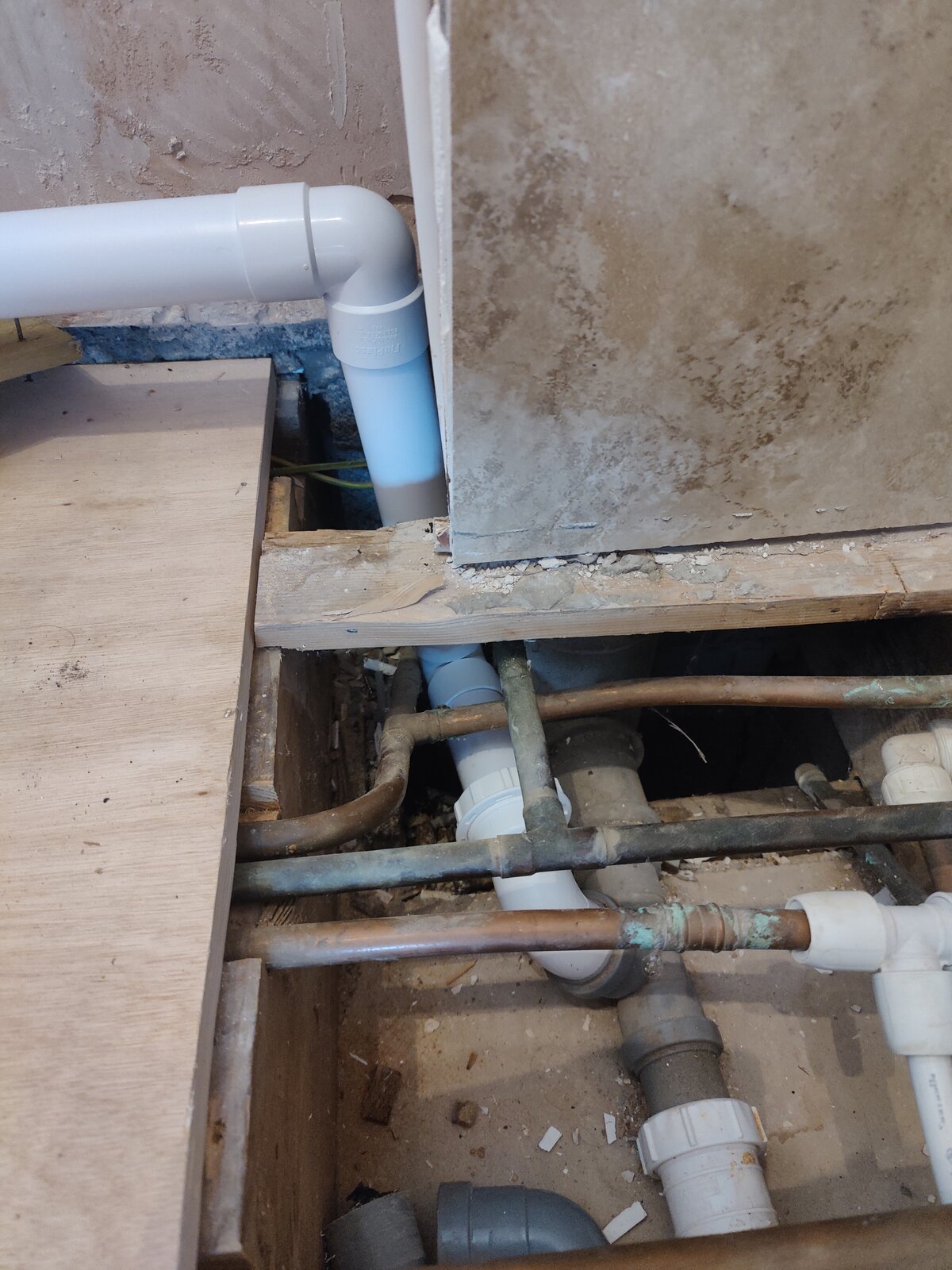

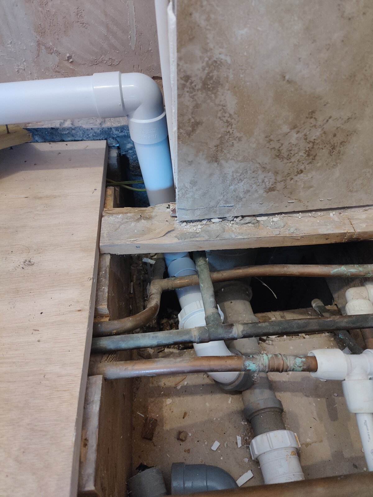

All sorted, just now need to get everything in its final position, marked and welded.

Thank you to everyone's comments, I was annoying myself so lord only knows what you lot are like, I managed to get rid of all the grey push fit that came from the main run just to minimise any later leaks. Everything is solvent welded ready to test later today.
