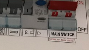

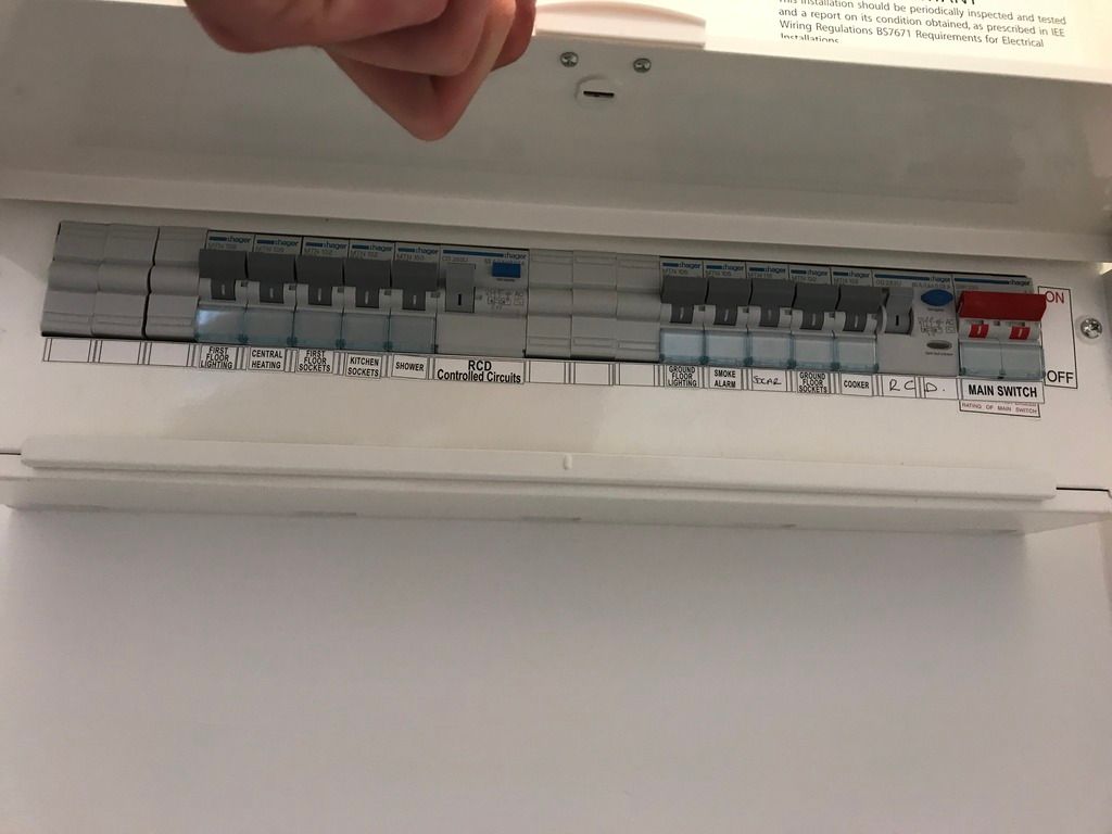

Hi there,
I got to visit my new build house the other day - it is still not ready, they only just put the doors and windows in.

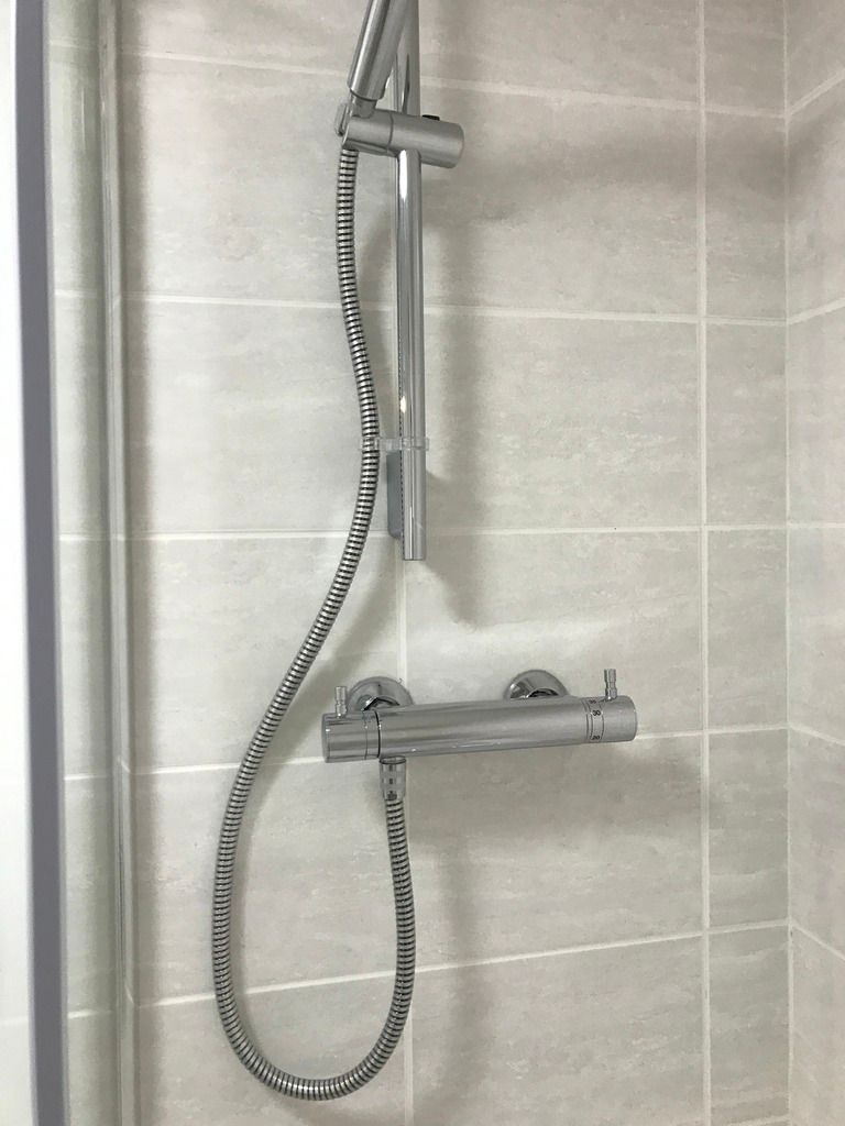

Can anyone tell me why there is a shower breaker in the consumer? We don't have a power shower, it is just a conventional thermostatic one and there is only one bathroom in the whole house. There is no wiring anywhere under the bath. The only electrics other than the bathroom light are the shaver socket and the extract fan.
Probably not connected.
What's the solar?
I did wonder this.
Solar is the PV panels on the roof.
I am assuming the controller box for it may need a mains power source?
Solar will be the "submain" to the inverter, generatated power is backfed through this circuit, the solar inverter will also shut down in the event of loss off mains supply. Its also wrongly installed.... it shouldn't be on the load side of an RCD feeding other circuits! One for the snag list......
The shower is probably a spare feed joint boxed in the roof space, there would have likely been some confusion about what type of shower was going in at one stage of the build

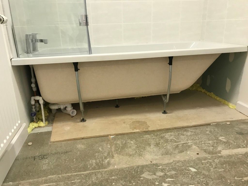

What is going on with the bathroom floor?
The plywood extends to the right wall, with skirting on top.
At the left side, no ply yet the skirting is already fitted at a lower level.
No support battens for the bath either, meaning it will sag and leak around the edges.

Power and lighting for the same floor are supplied from the same RCD ? Basic stuff !
DS
Concur. Dual split load board should ideally have lights up and sockets down on one side, the lights down and sockets up on the other.
I expect the shower circuit has been terminated in roof.
Solar should for sure not be sharing an RCD as the other circuits then won't meet disconnection times.
Will certainly add it to snagging, do you think it is dangerous to be left how it is?
Worried that developer is maybe house bashing to get these done as they are over date on completion. Would be far more happy to wait and get a proper job than have them rushing.
Also, should there not be a cooker breaker? In the kitchen there is a 6 switch lighting panel with normal switches labelled Cooker, Dishwasher, Fuse, Washing Machine, Fridge Freezer, Cooker Hood and Hob.
Really not sure about that, but well observed. I will have to ask them when I get my official viewing day, but it doesn't look right to me either.

Potentially yes - if a fault occurs, the RCD disconnects the mains supply but the solar inverter remains connected and supplying power until it detects the loss of power and shuts down. During which time you have power connected to some faulty item, or a person, etc.
Ok thanks for the clarification, doesn't sound good.
