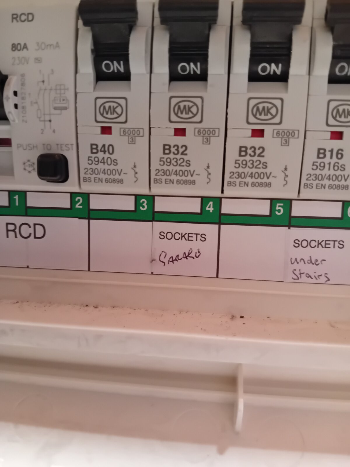

Just a small question. The feed in to the garage, does this come from the house consumer unit? What size MCB is on this circuit and is it RCD-protected? Post a photo of the house consumer unit if you aren's sure!
This is the house consumer unit

Hmm. 32amp MCB in the house CU feeding the garage. That may be OK, but that depends on what the cable(s) are out to the garage and his they are connected to the 3 sockets and the lights.
Need a lot more info before providing any more advice.
