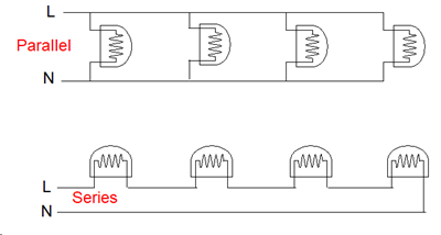

Nothing is energised yet. I wanted to undertake the necessary tests first. I understood that continuity of CPC and Line were the required tests. Along with IR testing. My Line is looped at ceiling. I was proposing to join CPC and Line in CU and then test at the Ashley Junction Box first. I can then test at the last downlight as there are 12 in total.
If all the lights were wired in parallel, you'd only have to do that at one.
I think my lights are wired in series.
My first downlight has an Ashley Junction box. This contains the Supply from the CU, cable from switch and cable that goes to downlight #2. Downlight #2 then has one that goes to downlight #3 and so on. The last downlight only has the one cable.
I was proposing that I test switch polarity at downlight #12 and if this is successful, I think it confirms that all others are correct too. That’s my assumption.

If lights are daisy chained, then to be thorough, you would need to verify polarity at every single out let - reason being that the cable polarity could be reversed at one fitting, then reversed again at subsequent fitting, the net result being the correct polarity at the final fitting in the daisy chain.
I hope not.
As has been said, you have the terminology wrong. If they were truly in series, each lamp would only get a fraction of the supply voltage (a quarter of supply voltage in this diagram) ..
