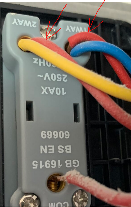

I want to change my landing light switch to a one way smart type, but need help on the wiring behind the old rocker switch.

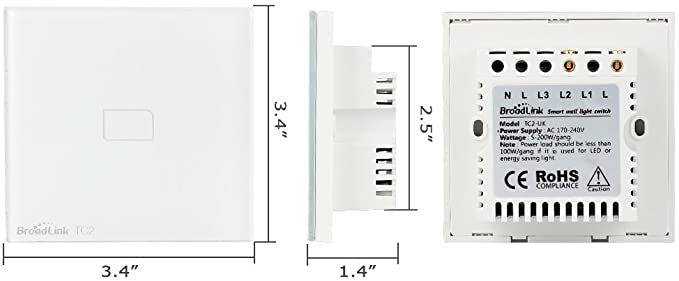

The new smart one way switch is a no neutral no capacitor type which I have successfully used in other rooms for over a year.

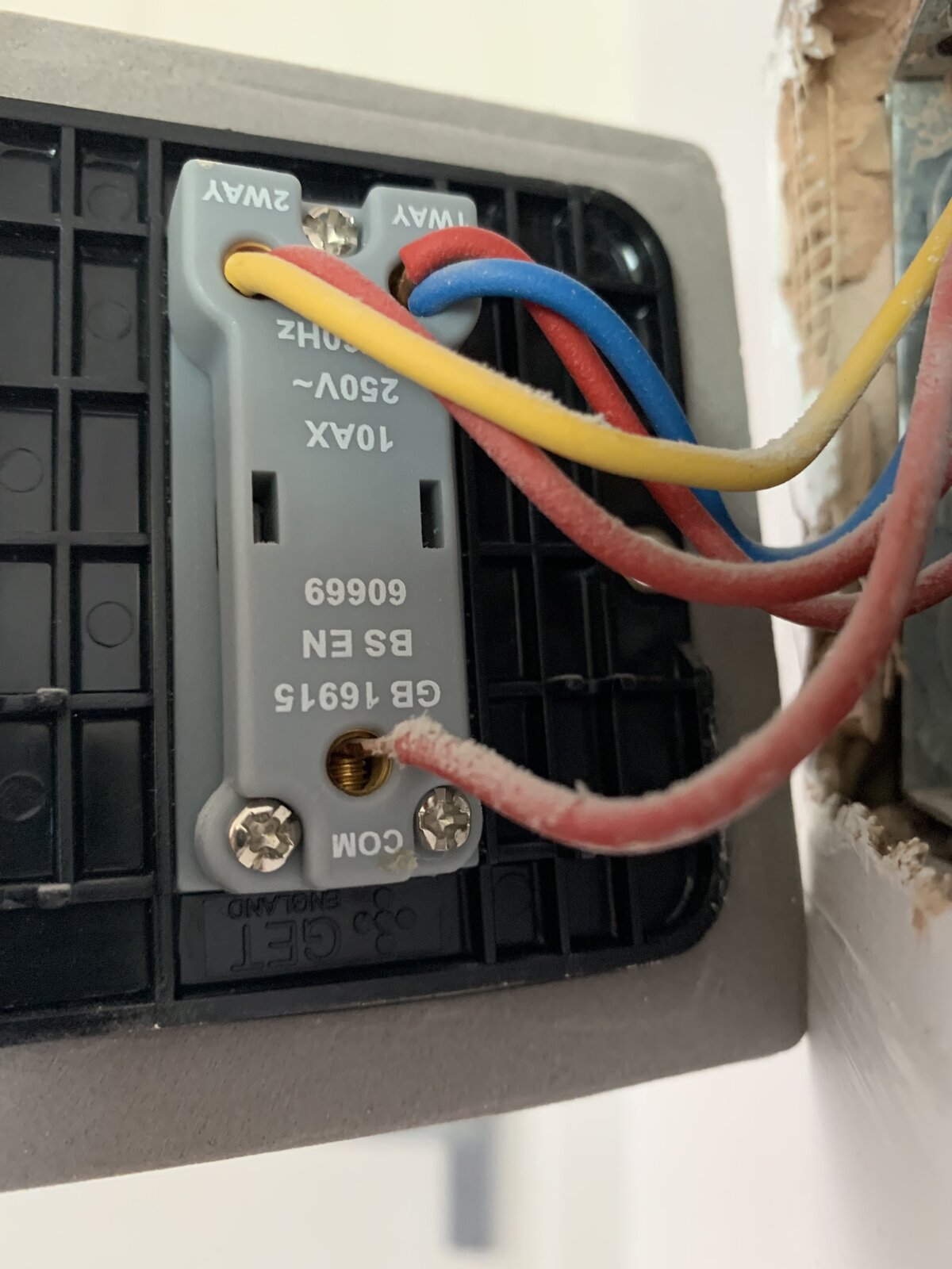

Here is a picture behind the current rocker switch. please advise on how to wire new switch.
Do I need to do anything down at the other switch in the Hallway?

For a one-way switch, just use these two wires.
Put them in the new switch terminals that have screws.
Doesn't matter which is which.
Safely terminate the other wires in connector blocks.
You don't need to do anything downstairs if you are keeping the same switch - but I would also disconnect them and put in connector blocks as well.
