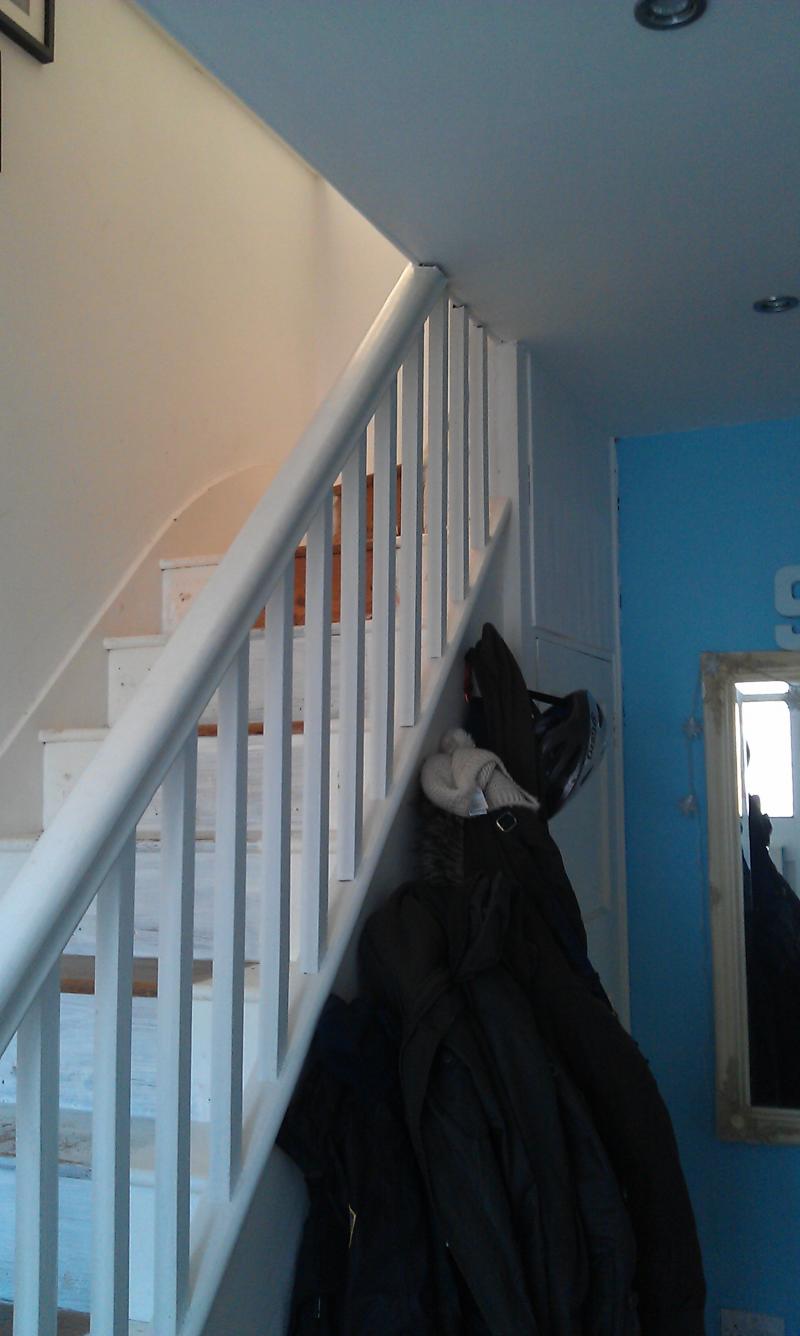

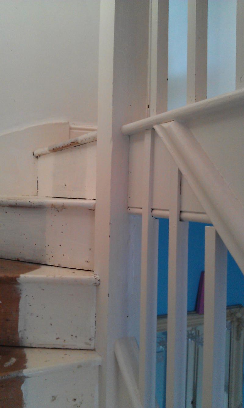

I am in the process of working out whether my extension will be possible, currently have an existing staircase with 2 winders going off to the right where the existing landing is. It's a 30s semi.
I want to convert this to a quarter landing with stairs going off either side as I will knock through to the left as you go up the stairs.

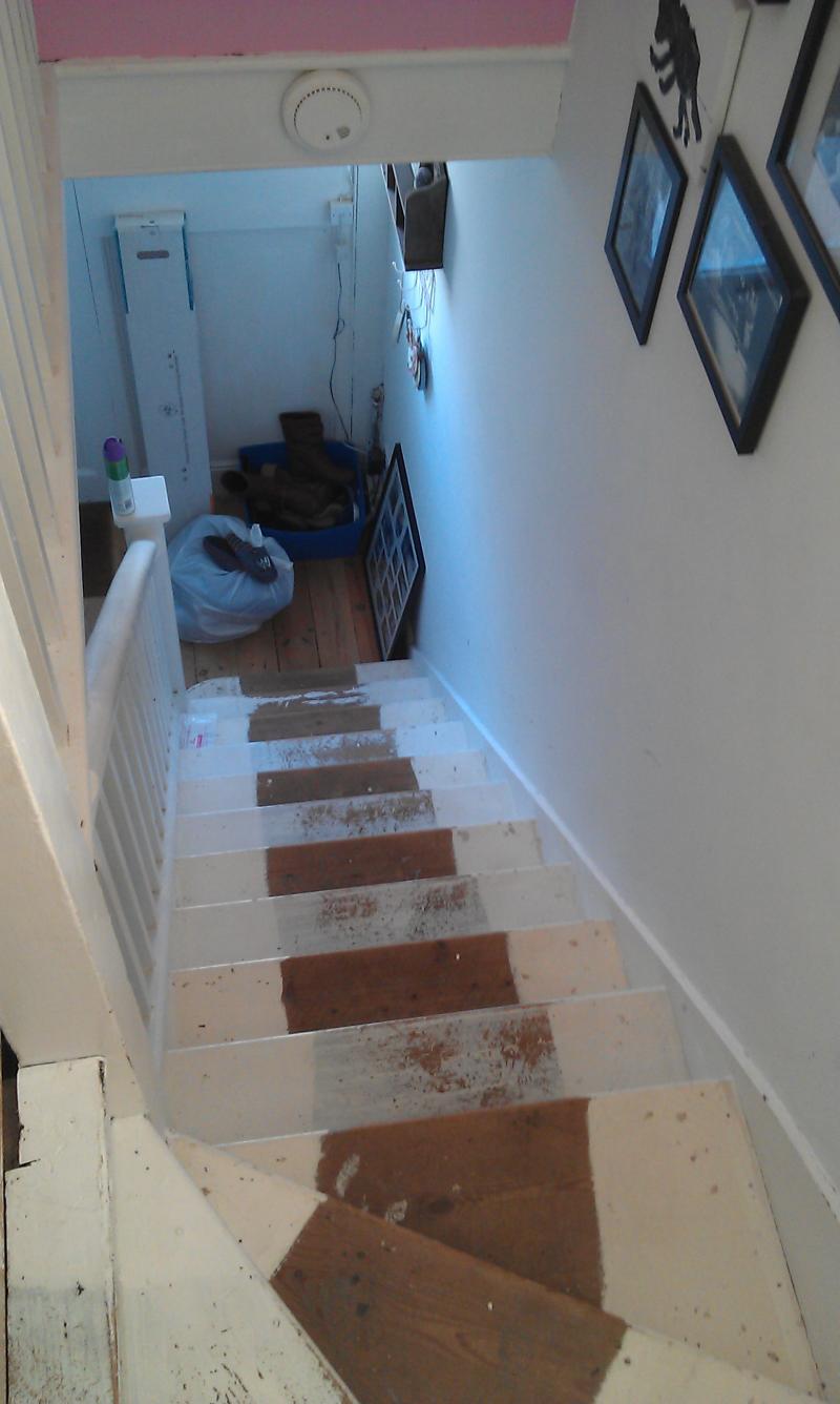

I can't do much to make the existing stairs any steeper or put winders at the bottom, as this will break the 2m headroom rule (there is a wall about half way up the stairs which currently is less than 2m, the pink one in the pic, but I am guessing that's OK for building regs if I leave that part of the staircase alone - I could be wrong?!!)
My other concern is how the big existing joist that supports the ends of the landing joists will be supported as the new stairs up to the existing landing will effectively cut through it, can it be bolted to the newel post?
I know I've not described this very well but the pics may help hopefully, I'd really appreciate anyone's thoughts, whether I'm on the right lines or not, feel free to tell me I'm talking rubbish, etc

sorry meant to add, my plan is to cut into the existing landing as I will have to, in order to have 2 extra steps up into it from the quarter landing.
Hopefully it won't make the landing too narrow as there will still be 800m square area at the top of the stairs which I think is OK.

This is a very tricky one and tbh your options are very limited. A job I'm involved in at the moment has exactly the same configuaration as yours.
What we propose doing is to lift the existing straight flight vertically upwards by one riser in height. This will give a little more space to the 1st winder, making it trapezoidal in shape instead of triangular. We will continue this level through the thickness of the wall, and then have a couple more steps up to the (new) bedroom door.
Obviously, at the bottom, we will add one step, though this will bring it too near to the front door, so we propose angleing the tread to the left (ie like a single winder). At the same time, we will have to trim back the bulkhead the equivalent of 1 step length, to maintain the 1.9m headroom (ie this will be no worse than at present).
Putting a square quarter landing in, and then putting more steps to the right is not an easy option, as you will be cutting through the main trimmer along the landing. You may also have to push the bedroom doors further back, thus affecting those rooms. (the newel will be bolted to the joist, not the other way round, by the way).
Hope this makes sense.
Tony
Thanks for the reply, really useful. Yes what you say makes sense. However I can't cut the bulkhead back here without effectively losing a bedroom because there's already a narrow point where I'm knocking the box room through.
If I'm reading your post correctly, the main problem with doing a quarter landing is supporting one end of the landing trimmer, there must be some other way to do this (like a structural newel post going all the way down to the concrete floor below, maybe thats the wrong term but basically something vertical to support the end of it). I dont mind taking the ceiling down and propping it up etc to do that.
I'll re-check the measurements but don't think I can get away with doing what you say. PS is your method with the trapezoidal stair definitely OK with the BCO, I cant see why it wouldn't be

You would have to support the cut trimmer with a post; something like 4" x 4" hollow steel. The important point is the base, as BC will probably want some suitable foundation pad, depending on load. If you are not sure about loadings, it may be best to speak to a SE.
You will also of course need to cut and trim the other joists to form an opening for your new steps.

At the top of the stairs, there has to be an unobstructed landing equal in depth to the width of the stairs. This means that the door facing you would have to be about 750-800mm away from the top edge of the stairs; on that score you should be OK.
The oversite concrete subfloor is an unknown quantiy. At the least, BC would ask for a decent spreader to spread the load over a reasonable area but, from my experience of inspectors, I think they will ask you to form a proper base. The Councils engineer may ask you for loading figures and this is why you would probably need an SE to do a scheme for you.
Tony
Thanks again for the advice, bearing in mind I will put a new trimmer in going from wall to wall, which will only be ~440mm back from the existing one (due to having 2x stairs eating into the existing landing), we are only talking about a 440mm "overhang" one end of which is unsupported so I think the whole thing will be doable, with a steel going down to the floor as you say.
