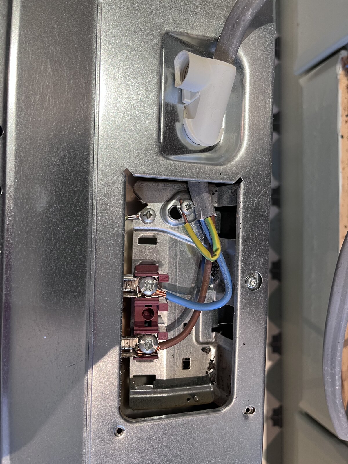

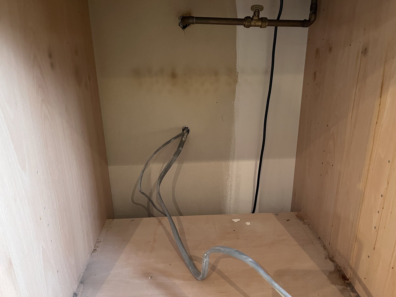

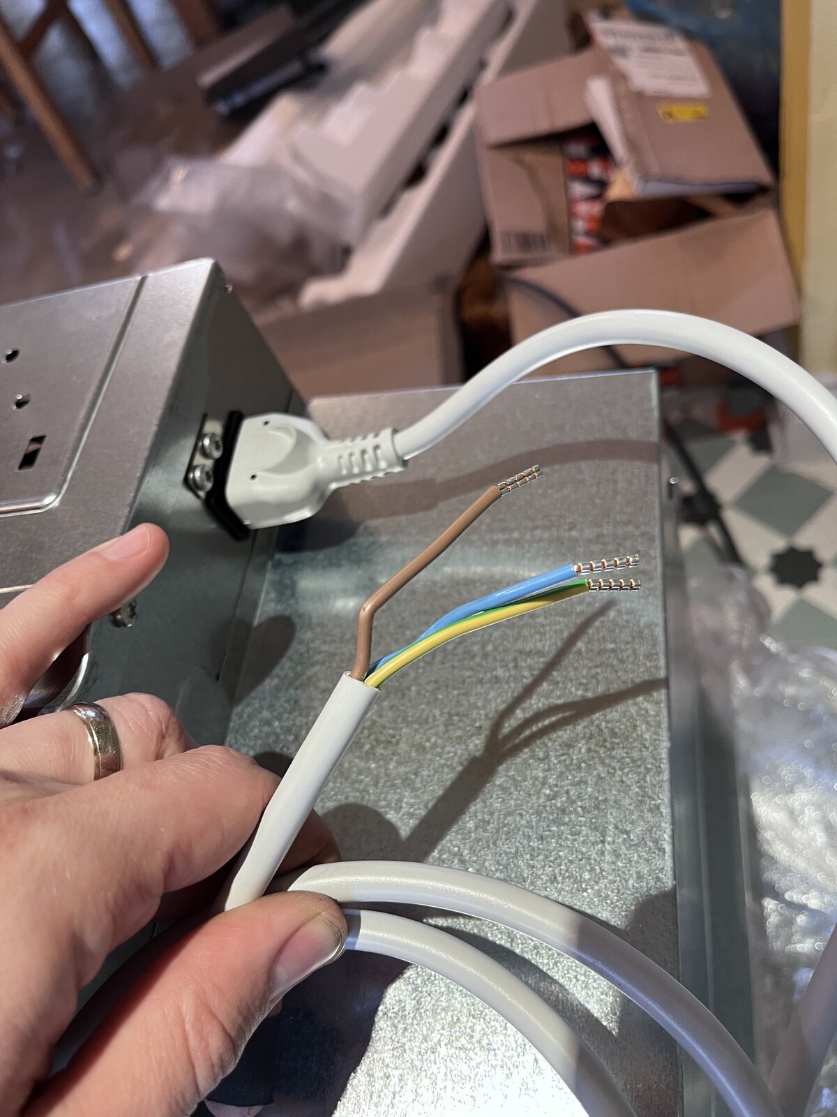

I’m trying to do the exact same thing with a new cooker I’ve bought.
Would fitting the junction box apply if the wires on the new cooker or smaller than the existing cooker cable I’m going to join together using the junction box?
I have attached pictures two – many thanks in advance!
Pic 1 - new cooker
Pic 2 - old cooker with existing wire
Pic 3 - showing existing wire
