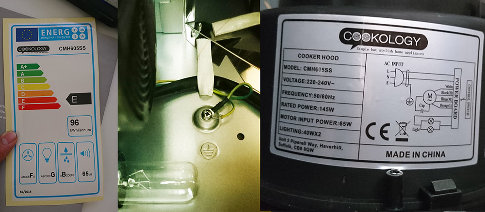

Hey guys, thanks for the speedy reply. DetlefSchmitz unfortunately I cant seem to see that symbol anywhere. Here are some pics of the specs. There is an earth wire inside the hood as seen in the middle pic.

It must be earthed.
If you really do only have a 2-core cable from the FCU then you'll have to replace it with 3-core.
The diagram shows that it does need an earth.

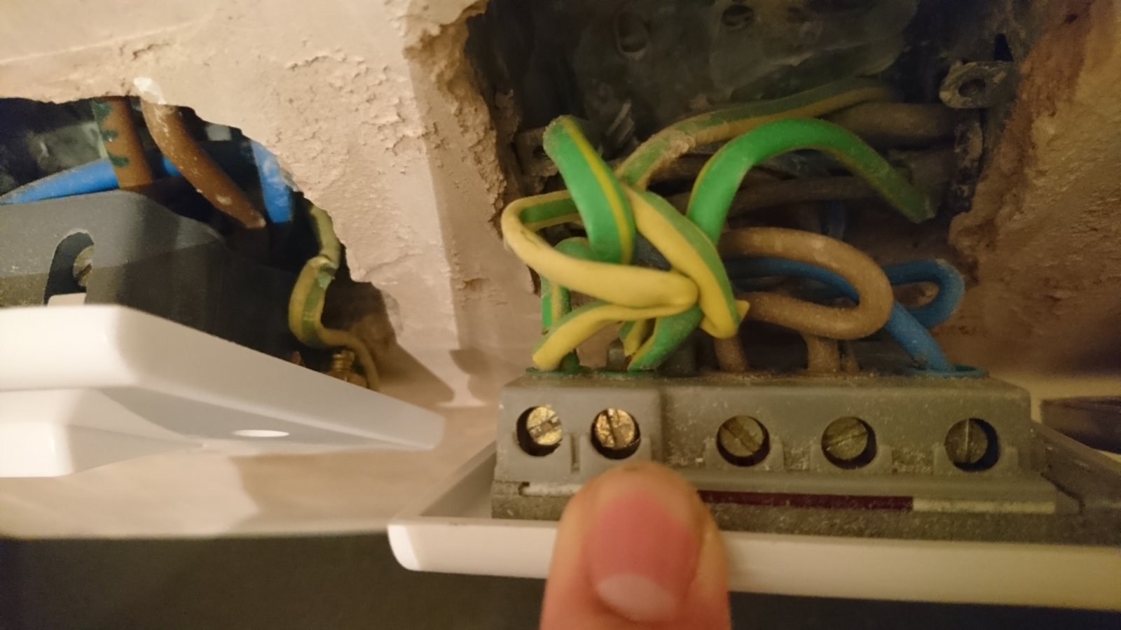

Cheers guys, ok will cut the plug tomorrow, fingers crossed. As for the FCU it looks to have 4 earth wires plugged in. It looks to be part of a circuit with the sockets and oven switch as I remember the FCU did not power when the sockets weren't wired up to a socket switch. Looking at all the grey wires their earths all seem to be connected up so hopefully this means the one for the cooker hood is connected somewhere at the other end.
It does look like its connected then, although a closer look to confirm would not go amiss, it lookes like the 4 earths in the fcu are two from the ring, one from the outgoing cable, and one to tag the backbox (not always fitted). If you look on the back of the FCU, there are a brown and a blue each on their own in terminals, this is the outgoing side, the incomming side will have a pair of browns which share a terminal and a pair of blues which share another terminal. If you follow the ones on their own (outgoing) you'll see which grey sheath they go into and can then check that the earth that goes with them is also connected to the earths. But as I said, four of them would suggest it is
Thanks for the info Adam. It appears all the earth wires in the grey wires are plugged in. The earth wire in the cooker hood hard wire is bare and bent back suggesting it might not have been used for the previouse hood.
