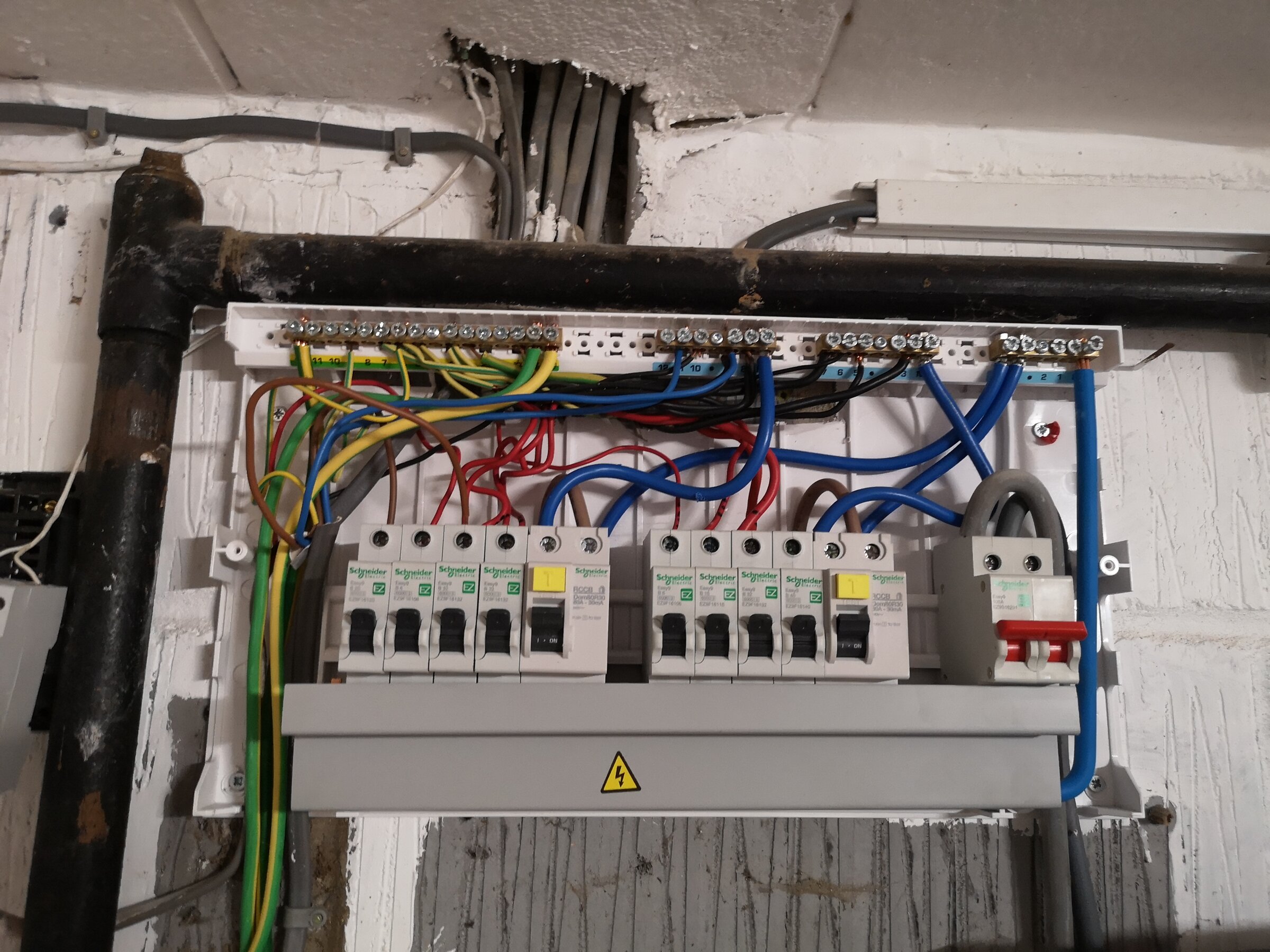

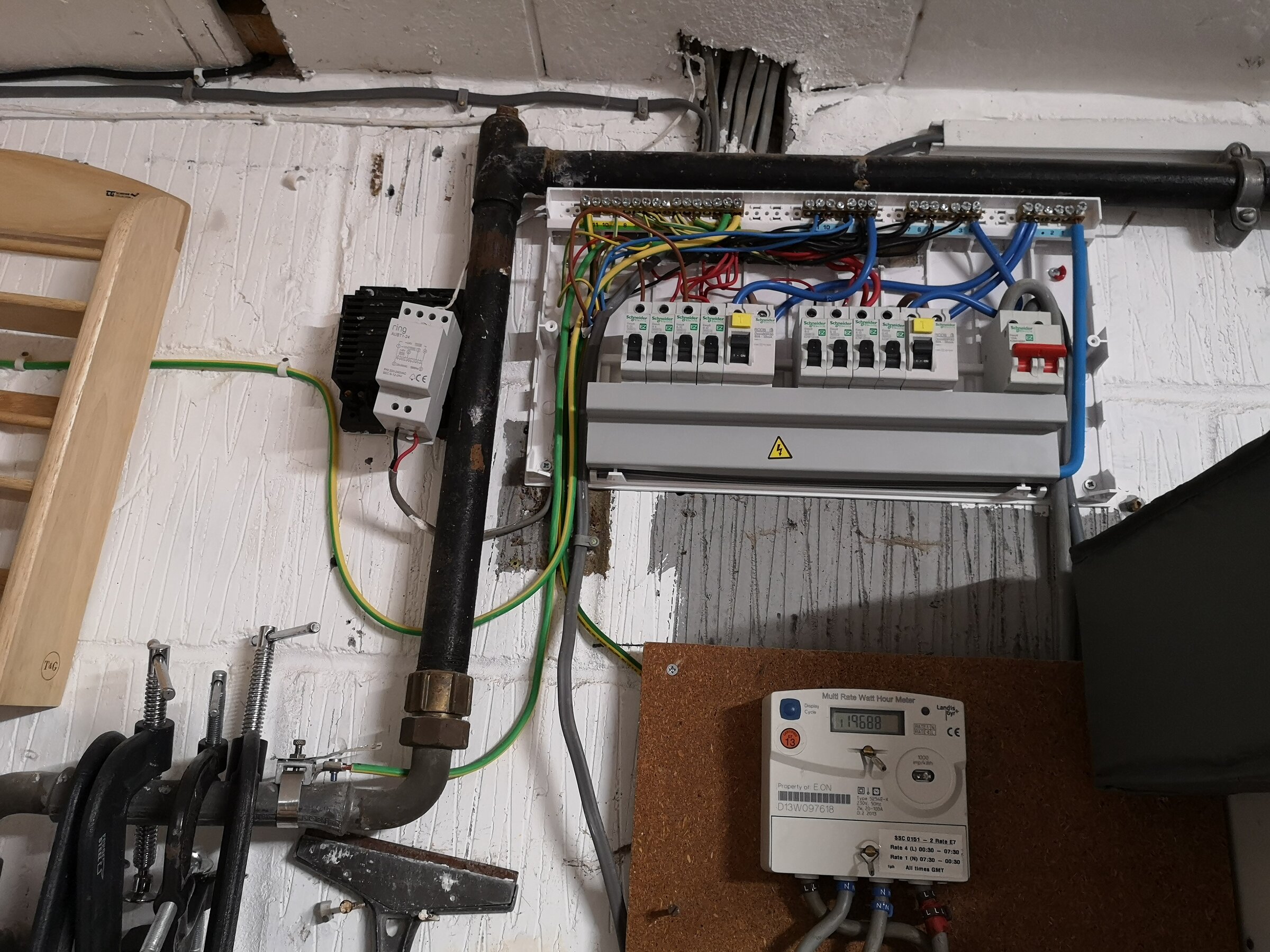

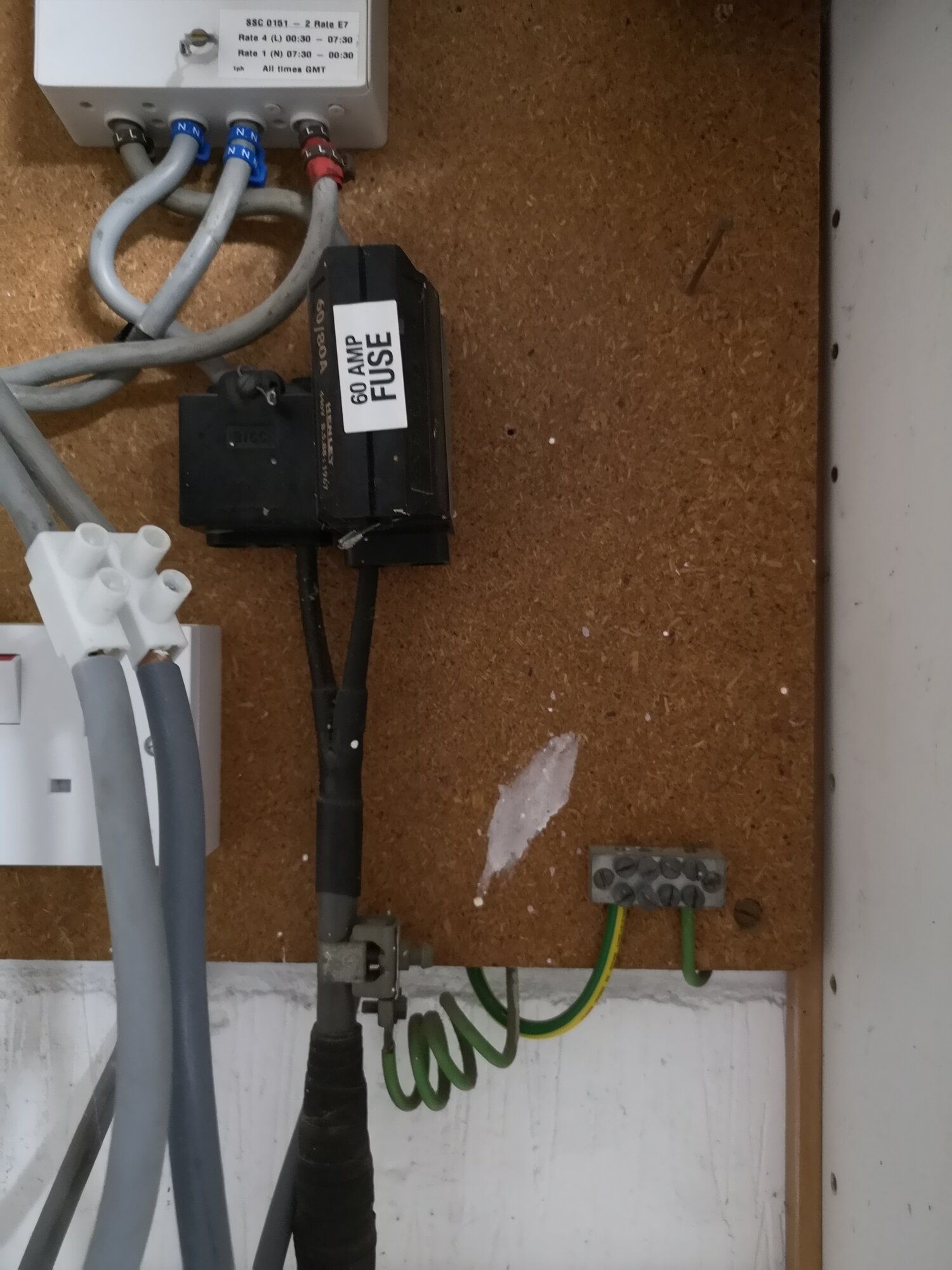

So to question 1 please see below pictures.

jeezzz
tails in a junction in pic 1 :eek:
ring transformer out of enclosure in pic 2 :unsure:
Hey, what do you mean by tails in pic one please? Do you mean the terminal block? What can I do to make better?
Presumably the ring transformer needs to be in an enclosure? (installed before I moved in).
Yes the terminal block. The best thing you can do is call your electricity supplier and ask them to come and fit an isolator between meter and CU. DON'T tell them about that lashup til the engineer arrives, play dumb (just moved in or it was in some trunking or some nonsense like that). If you're lucky they won't bill you.
And fixing to something
You might want to move your collection of G clamps as well, lead pipe is not very strong.
What would be my reason for an isolator... I.e if I'm going to play dumb what is my reason for asking for it etc?
I didn't realise ut was lead pipe... I assumed it was steel..?
You're looking to upgrade the CU, an electrician who came to quote advised you to get an isolator fitted first, saves having to have the supplier or DNO on site to disconnect while the CU is swapped.IF engineer questions you further, again play a bit dumb, tell him electrician mentioned needing a metal cu cos 18th edition. Engineer with luck will say "bloke's a con artist, nothing wrong with that board unless you're adding 6 circuits. Now, where do you want this isolator?"
The black bits of that pipe are iron or steel, the grey bit is lead.
OK - all comments above apply! I suggest you get those tails sorted out and an isolator fitted ASAP.
1) The earthing system appears to be TN-S. In the absence of a measured value, we will use 0.8Ω for the value of the external earth loop impedance, represented by Ze. This value is important as it forms part of the loop impedance through which a fault current will pass ( represented by Zs) and we need to ensure that the total impedance of that loop is not so high that the fault protection device will not operate within the time required in the regulations, which is 0.4 sec. (reg 411.3.2.2 table 41.1). 0.8Ω is the maximum value of Ze declared by the supplier for TN-S supplies.
