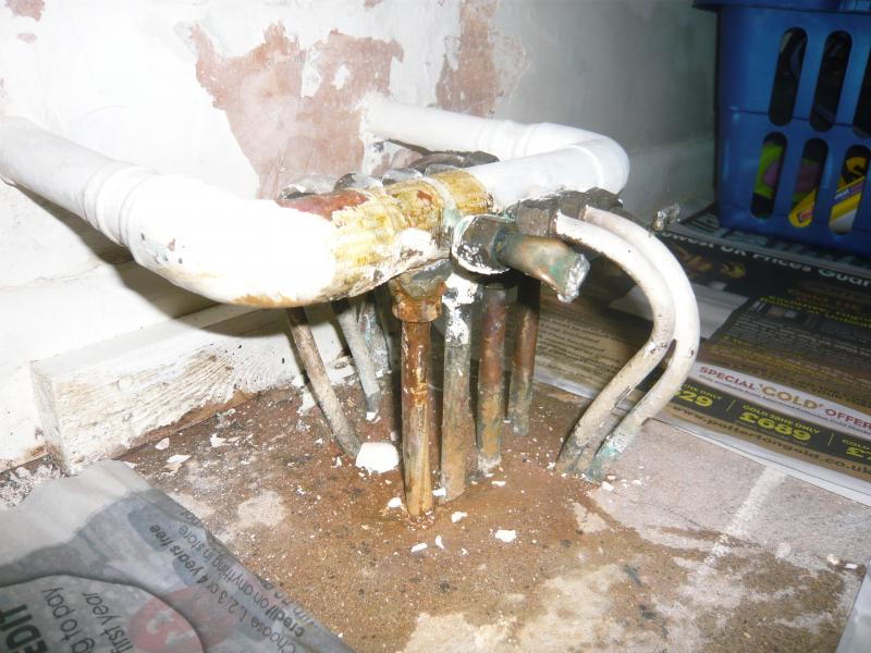

has anyone changed a copper central heating manifold
i have a small leak in the main joint of the 28mm pipe where one of the microbore 10mm joins it
i have tried pouring leak fix in the header tank and tried sealing the joint but to no avail
i was thinking of replacing it with a plastic manifold or similar if any is available
do you know if you can replace these
any advice would be appreciated

can you explain how i would repair this with this part
would i cut the main pipe section taking out the leaking joint and push fit this part in ?
on one side of the main pipe one of the connections is sealed off so i dont need that one, i need a connection from underneath the pipe going into the concrete and also the other side of the main pipe i need a connection

if it was my own job i would rip it all out and start again, it looks RAF
Do you need to replace it?
Can you not drain down, undo the compression nut where it is leaking clean it up, butter on some jointing compound and do it back up?
Or is the leak actually on the manifold soldered branch or whatever?
These Wednesbury manifolds are notorious for leaking at that joint. Replace as my pal Glasga Gas has stated.
If you 11 rads from that one manifold I'd revamp the system completely!!!
