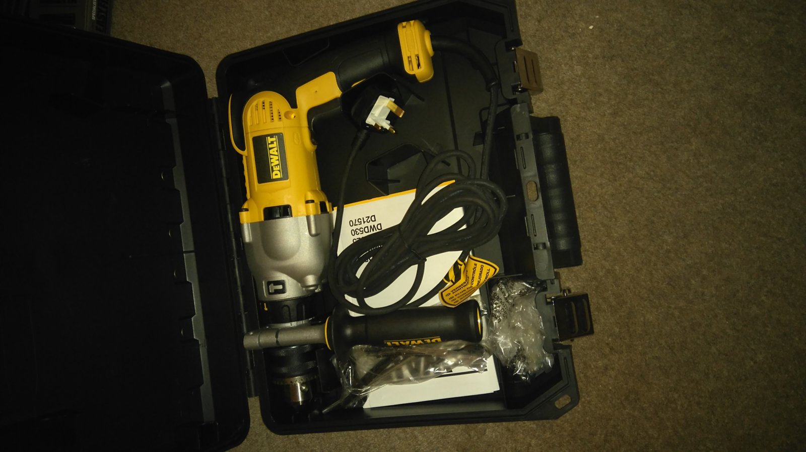

  12. sonofrob
    sonofrob
    Joined:
    4 Jan 2014
    Messages:
    168
    Thanks Received:
    3
    Location:
    Durham
    Country:
    DSC_0010.JPG DSC_0011.JPG i went for the same dewalt also mate,,,after reading a lot of reviews on each drill this one seemed the one to get,,,with the erbauer core drill set,,,is it just me or do other people love buying new tools,,,???,,,I enjoy going to the tool shop just as much as buying new clothes,,,:D:ROFLMAO::ROFLMAO:......

    I bought a new Dewalt D21570. On the 3rd use (I was actually using it on the hammer action to put a 22mm masonry bit through a half (engineering) brick garden wall) it was struggling and the clutch was working hard and the motor was getting quite warm (but no more so than any of my other Bosch or Dewalt drills) - I was reassured that the fancy electronic protection system would kick in and protect the drill if necessary.
    Drill stopped, "problem" light came on. Dewalt service centre laughed, diagnosed burnt out motor without any examination, laughed again when I mentioned the electronic protection system and said they'd stopped selling this model themselves as it was upsetting their customers! Dewalt replaced motor and I still have it but have no trust in it and "nurse" it every time I use it. I would have put it down to bad luck were it not for the opinion of the Dewalt service centre on this particular model.
