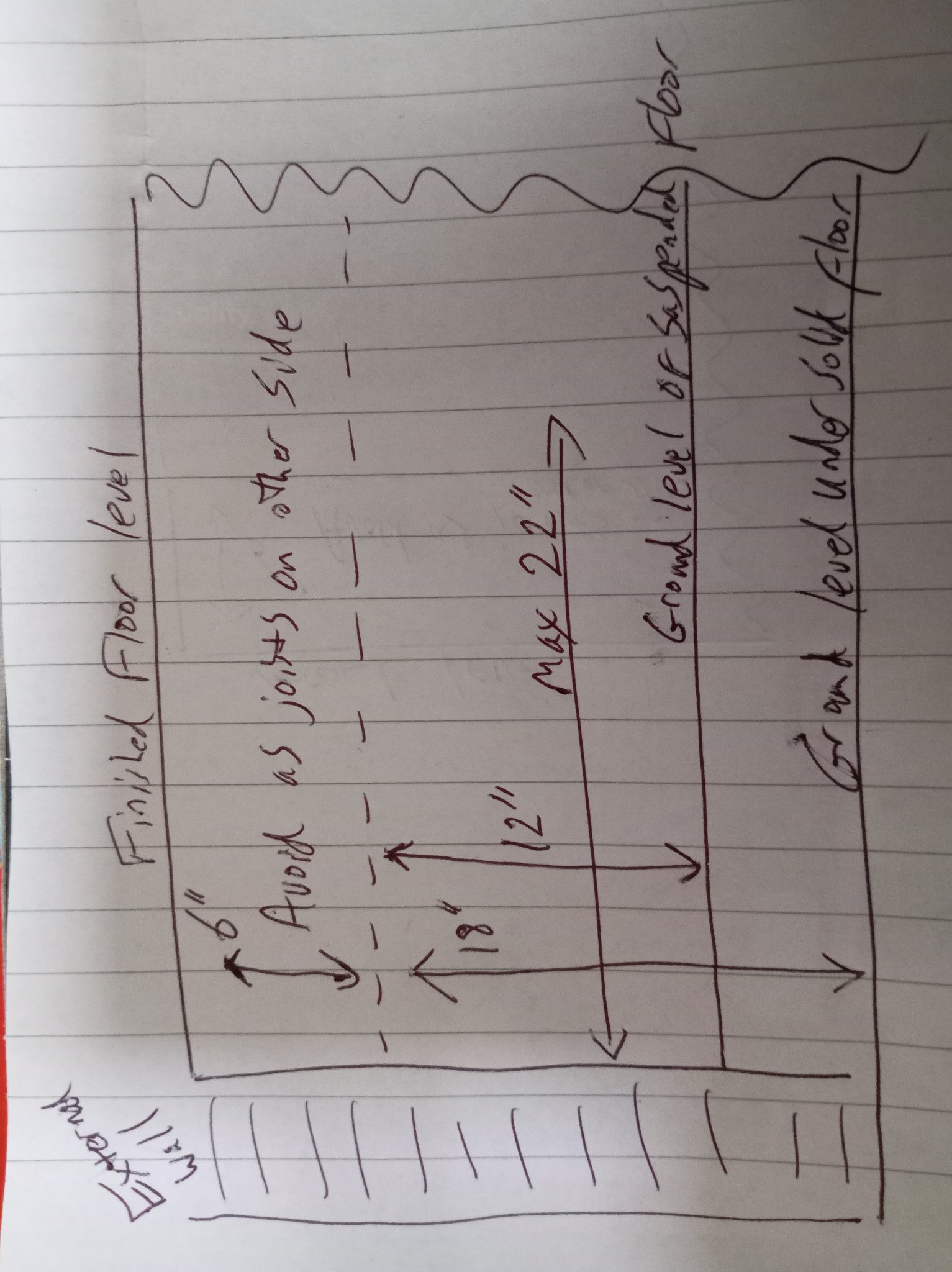

I need to core drill 2x 5" holes below floor level in a internal wall to provide air flow.
The room I'm working in has a solid floor (excavated) and 110mm Pipe will run through. A suspended floor is on the other side of the wall in question.
Very limited on space here I have a space about 12" vertical by a maximum of 22" horizontal to work in. The wall adjoins an external wall to the left.
Question is, where would be best to position the holes? Side by side would seem the obvious option, but would stacking them vertically be a better option?
Thanks for any thoughts on this.
