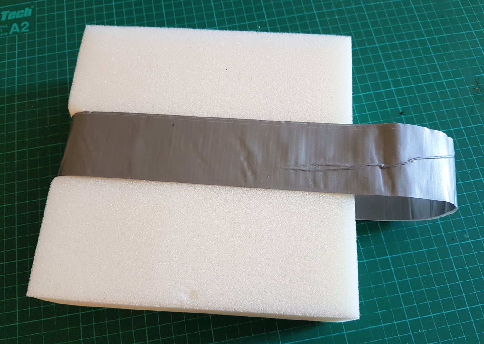

My suggestion:
Get a saw (or I find a bread knife works well) and cut the large block Kingspan/Celotex into a 'bung' that is the size of your hole.
Then wrap bung in duct tape so it fits tightly in the hole, keeps its shape, and does not drop any Kingspan/Celotex bits.
Make a handle from the duct tape that will fold flat when bung is in place:
- Use long length of duct tape, put a (guess) 10cm length of duct tape in the middle of the long length, sticky side to sticky side.
- Make this non sticky section into a loop hand hold when you stick this long length around your block.
- This duct tape handle section will then fold flat when not needed.

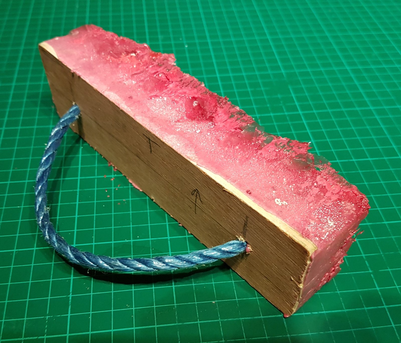

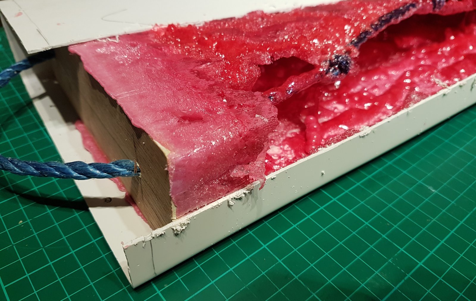

I gave it a shot yesterday, I had left it over 24hrs to cure, and ended up with a disaster!!! :LOL::cry:
I didn't cast it in the duct in the wall, I'm not that stupid, I had some leftover duct to use.
I lightly oiled the insides of the duct, so it wouldn't stick to the mould, but something has gone really wrong with the foam! Does it react badly with oil maybe? Most of the inside is just hollow and most of it hasn't set either...
I was pretty sure all along I would have to cut the mould open to release it, maybe 5% of me thought I would just be able to slide it out!! But this cheap foam is different to foams I have used in the past, especially for a fire foam. Even the parts that have set, still seem squishy and the bubbles are too big. I'm used to it ending up very firm, much closer to actual Celotex firmness.
All I have salvaged is a 4cm deep bung, when I wanted over 30cm! :oops::LOL:
Think I'll just duct tape some Celotex offcuts to the back of this. I like the way it turned out on the front!!
I think the way to do it would be in layers, letting it fully set up before a new layer.
It needs moisture to cure, you should fill slowly, (maybe from both ends for speed?) and use a plant mister to apply water- maybe spray the mould first? So water/foam/water/foam etc.
After all that, I ordered some 'cut to size' fire retardant foam and made a duct tape handle/handbag with it!!
That goes in first, nearly up to the external vent. Still going to keep and use the plywood/rope/red foam bung next, then a painted and bevelled MDF cover screws on inside over the hole.
