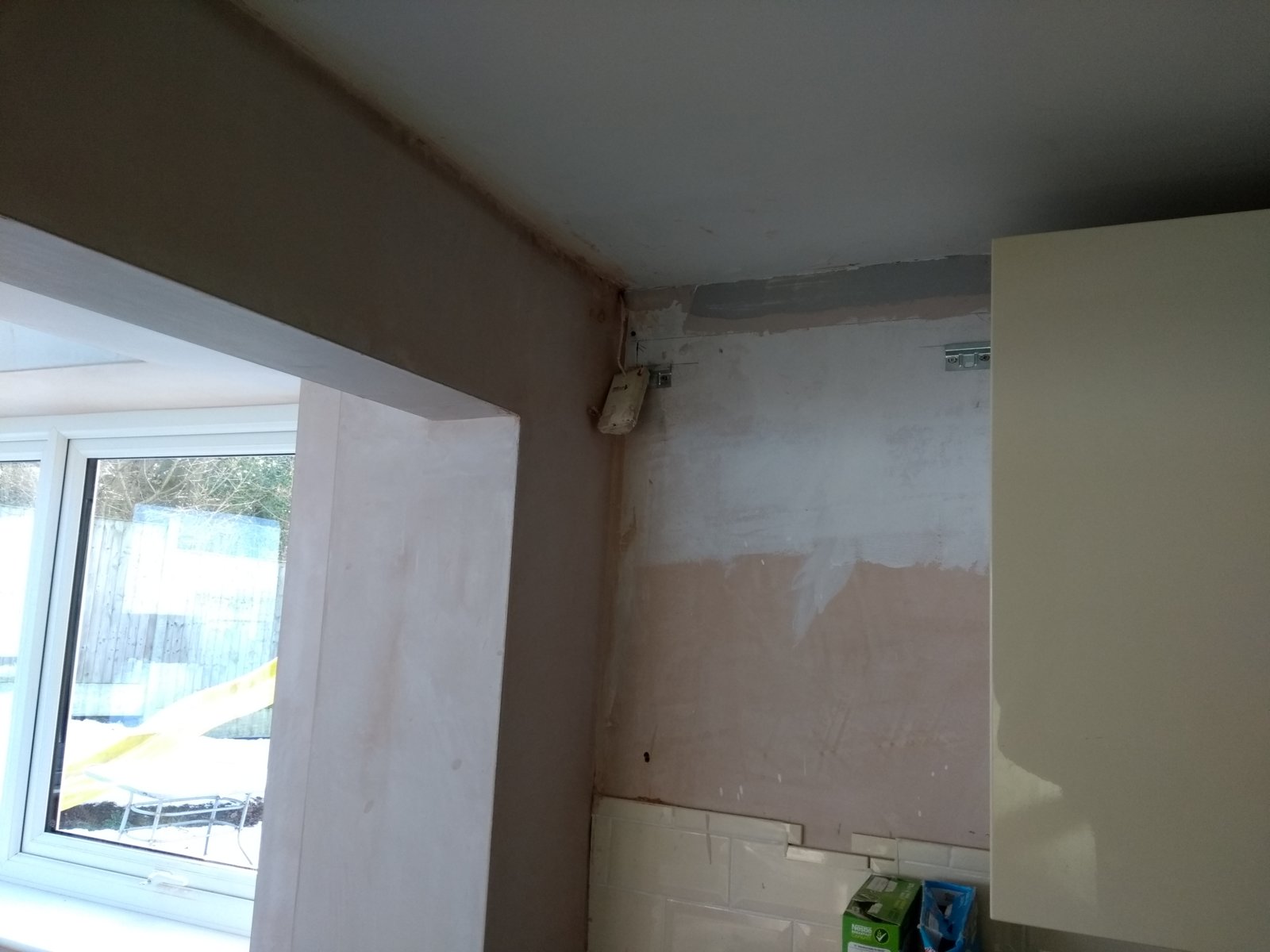

See pic. The hood will be to the right of the pic and the ducting has to go up into the celiling above it and then down inside a cupboard close to the pillar you see on the left. It is that pillar that I have to drill through.
Behind the hood is a bathroom with no easy exit for a duct to the outside.
Above the ceiling is a bedroom with laminate floor and I don't really want to rip that up.
Im not understanding, isnt your proposed duct hole either above the steel or just beyond the end of it.
Can you not go into the ceiling void and get above the steel.
I can't go beyond the end of the steel as it sits on that pillar and the is against (or further) the back wall.
I hadn't thought of going over it but coming out the other side of it will be where fascia used to be before the extension was added. I think the conservatory roof beams come down to a new gulley joining where the fascia used to be.
EDIT: better explanation (sorry!). Was a bungalow now with bedrooms above. So above that beam is where the sloping roof came down to fascia and soffet.Now conservatory has been joined to where that fascia was.
So a possibility is to go into the ceiling, along to the left towards the beam and vertically out through the sloping roof. But that involves roof work, condensation trap etc and that is beyond my diy skills.

That's a poxy design and work. Who wants massive piers and deep downstands.
Anyway, you can cut your hole in the top corner of the steel above the sensor. Difficult but do-able
Or if the joists are running in your favour, up and over in the ceiling void.
